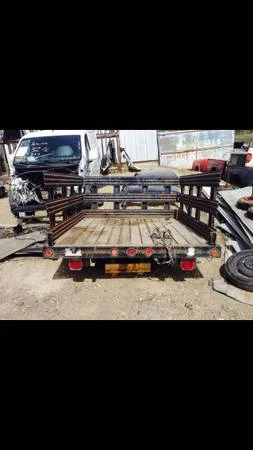

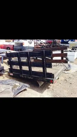

I've been tempted to buy this flat bed from this junk yard here. I don't particularly care for it one way or another, but it's damn near the exact dimensions I had planned and could probably modify it to my liking: http://spokane.craigslist.org/ptd/5002164424.html
