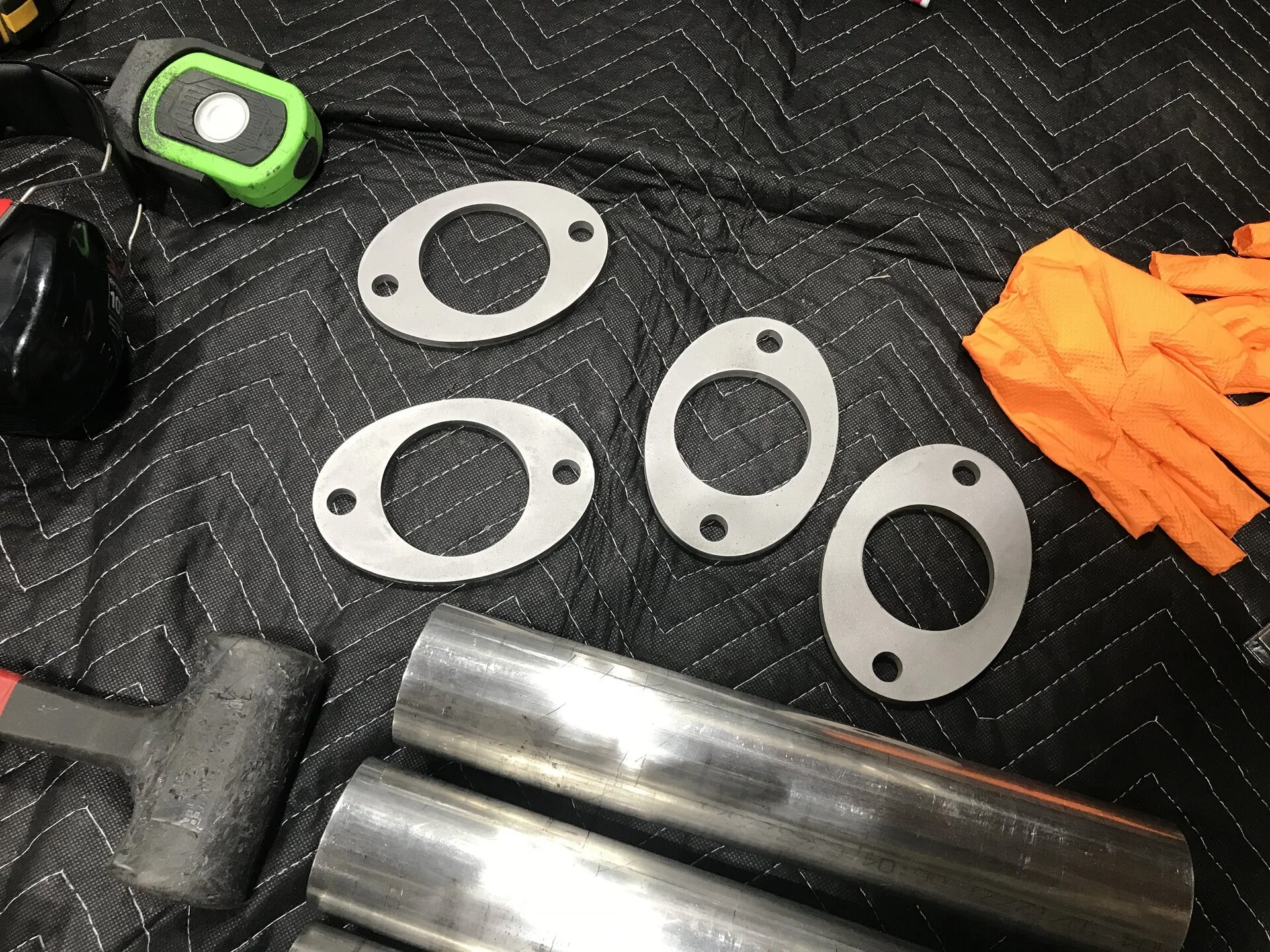

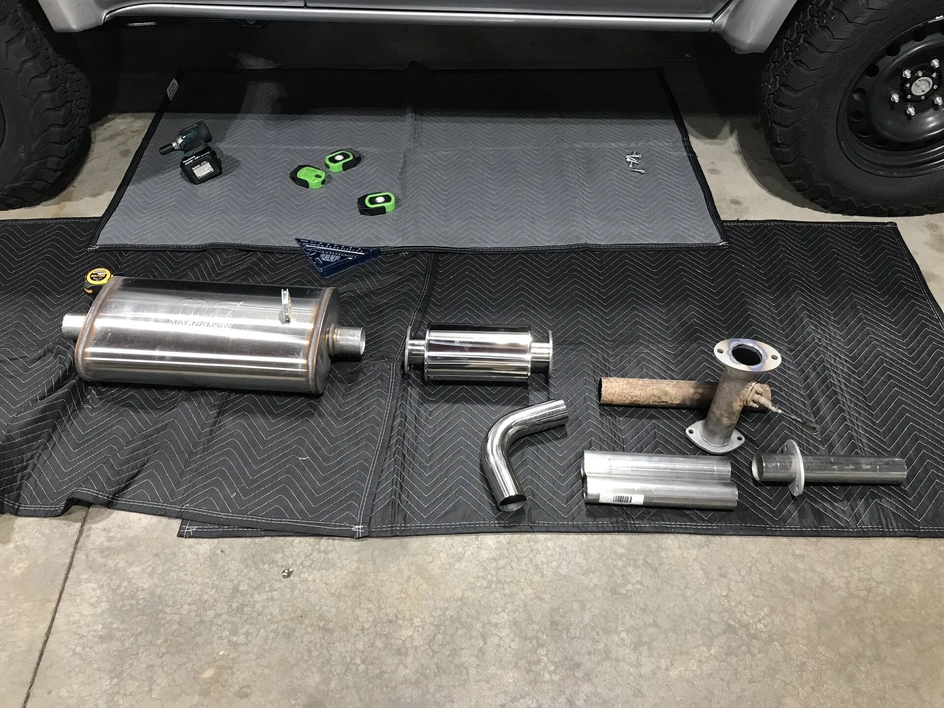

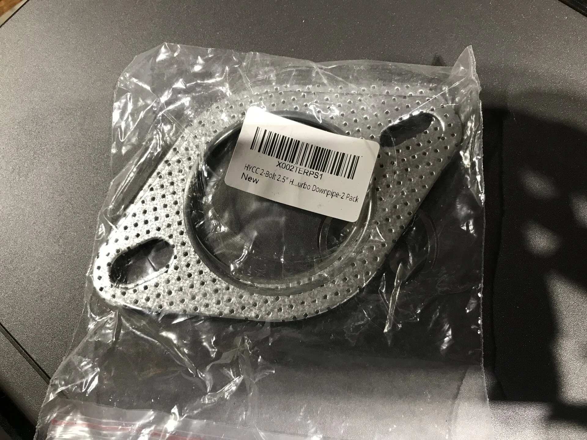

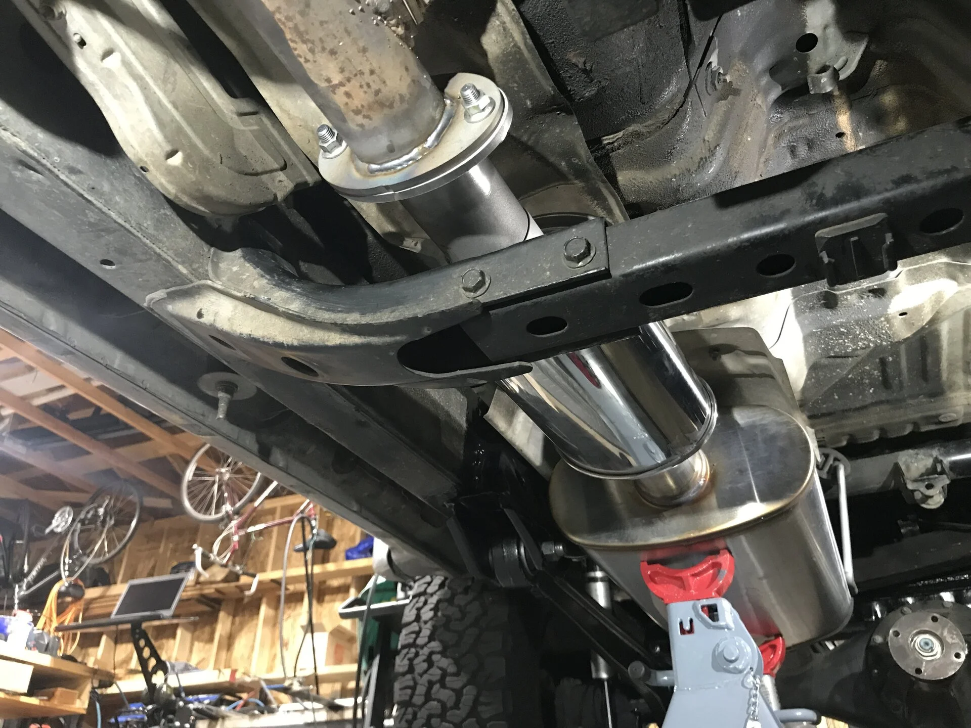

I was considering using the old flanges off old exhaust to create the new junction for the center tube
Set it up to use a stock exhaust gasket and call it done.
I also considered re-using the old stuff I will probably scavenge them off just in case. Once I have the new stuff in hand.
This is what I did on my T4R and it worked out really well. I would love to do the nested part but I don’t have an expander/shrinker handy. so far, the flat gaskets work fine with no leaks whatsoever. I think as long as your fab work is decent quality and you don't mess up the alignment of the flanges flat seems fine.

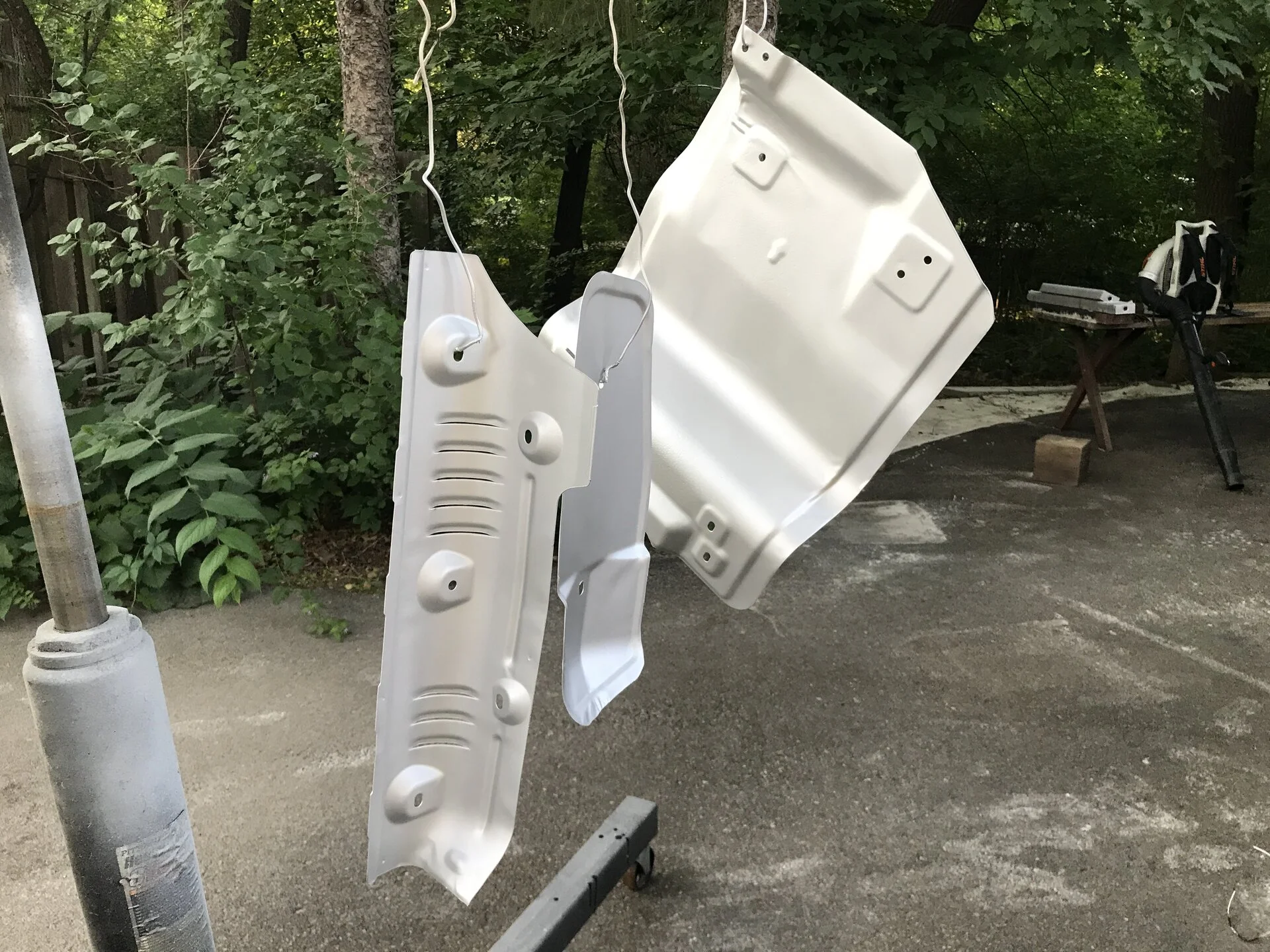

since I had the exhaust off anyways figured I would sand blast and rattle all the shields and fluid film under side real good.

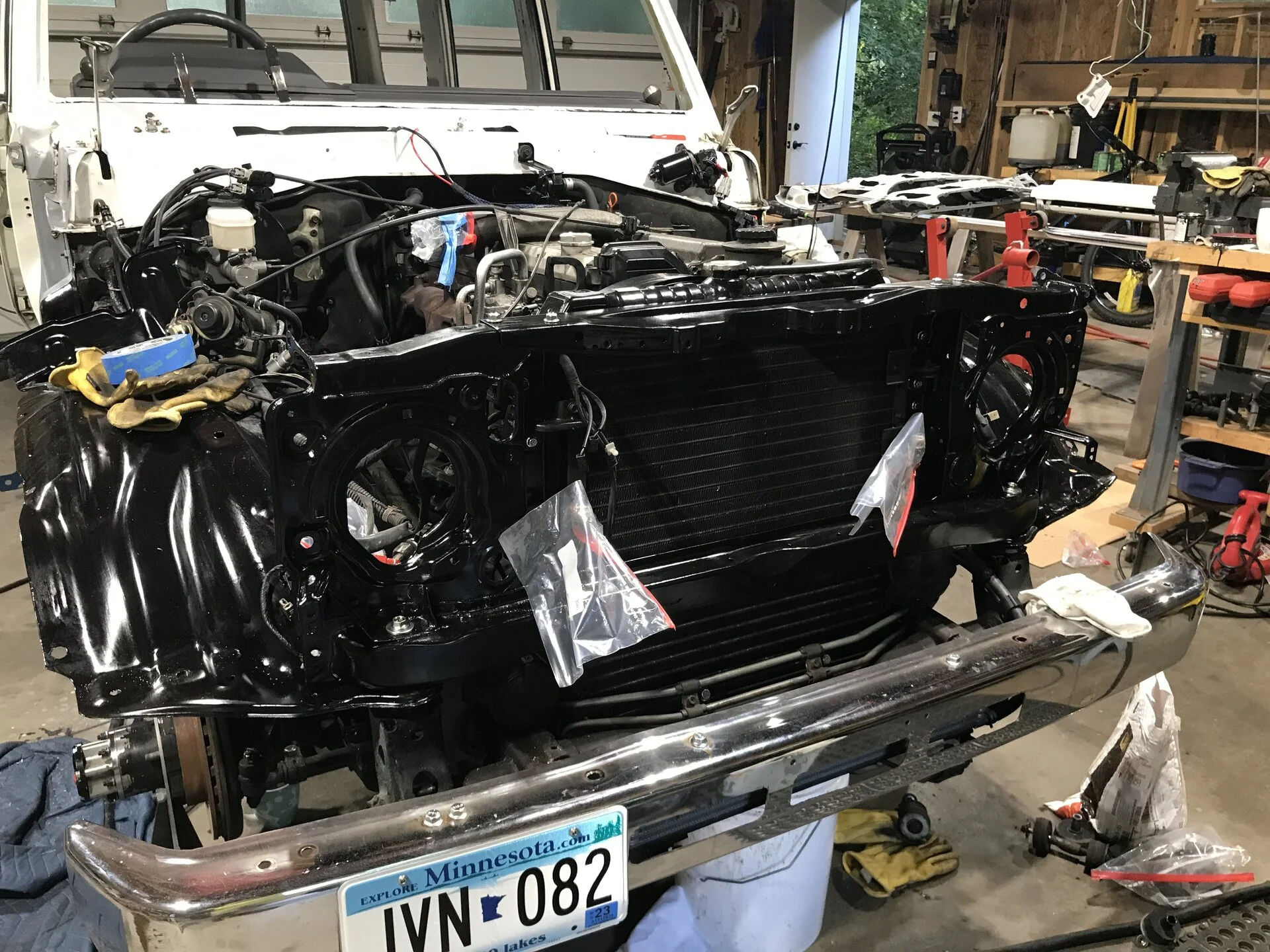

and slowly making progress on the front clip, already looks way better. it was 3x different colors and had some rust starting so this should help it live for a little longer.

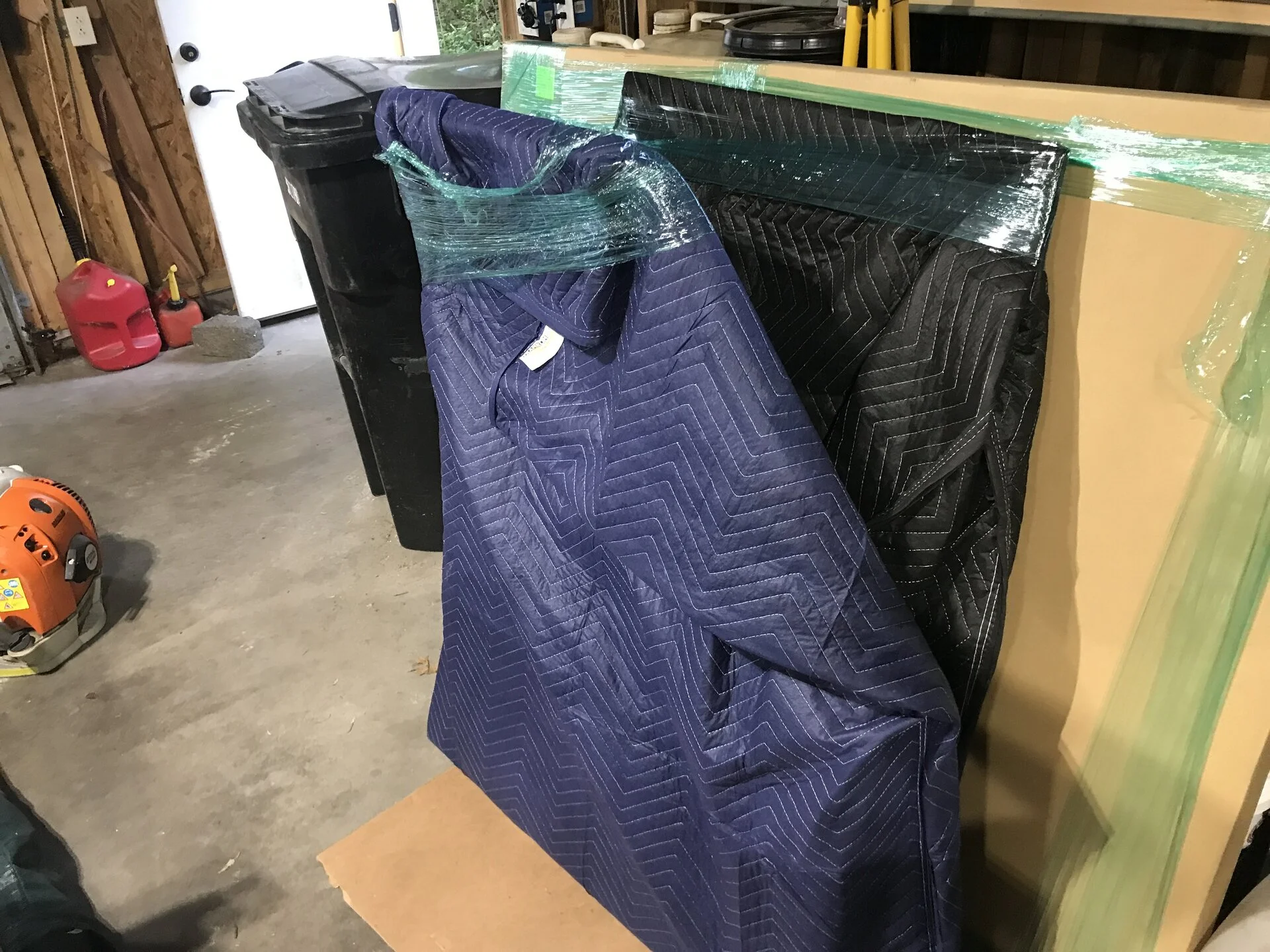

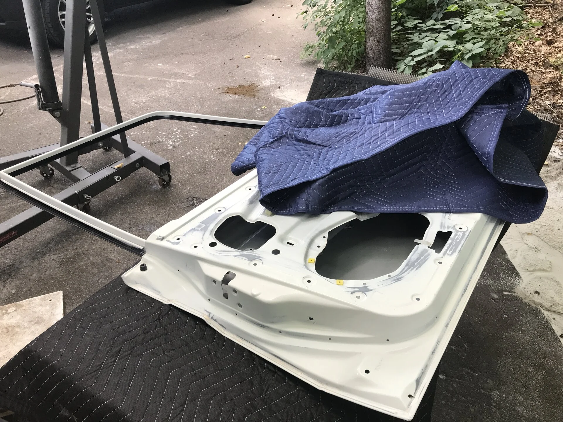

Have been trying to make a final push so things can go for paint. I cleaned my doors and by cleaned them I mean CLEANED THEM. Pressure washed the inside, isopropyl + ultra fine scotch bright to remove all the gunk and adhesives. They are squeaky clean right now.
After all that prep my wife walked into the garage and knocked some stuff over… nothing got hurt but I had a rush of adrenalin.
I took some moving blankets and made big bags out of them so the doors and other parts can be safe as a bug in a rug. Having a big honking sewing machine does have its advantages. I can sew 10x layers of fabric and 5 feet like in 30 seconds. Accuracy is not important here. My freak out level has dropped back to normal freak out, but the day is still young.

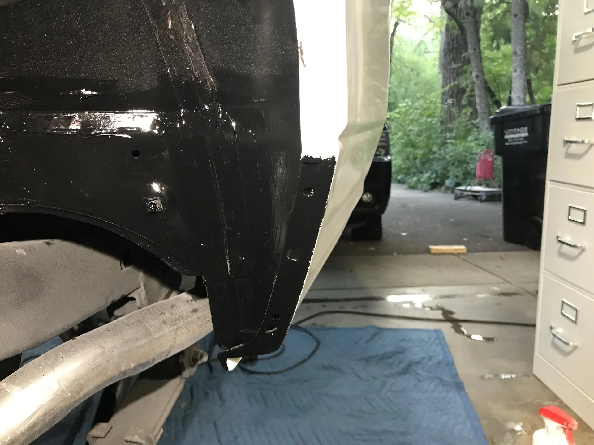

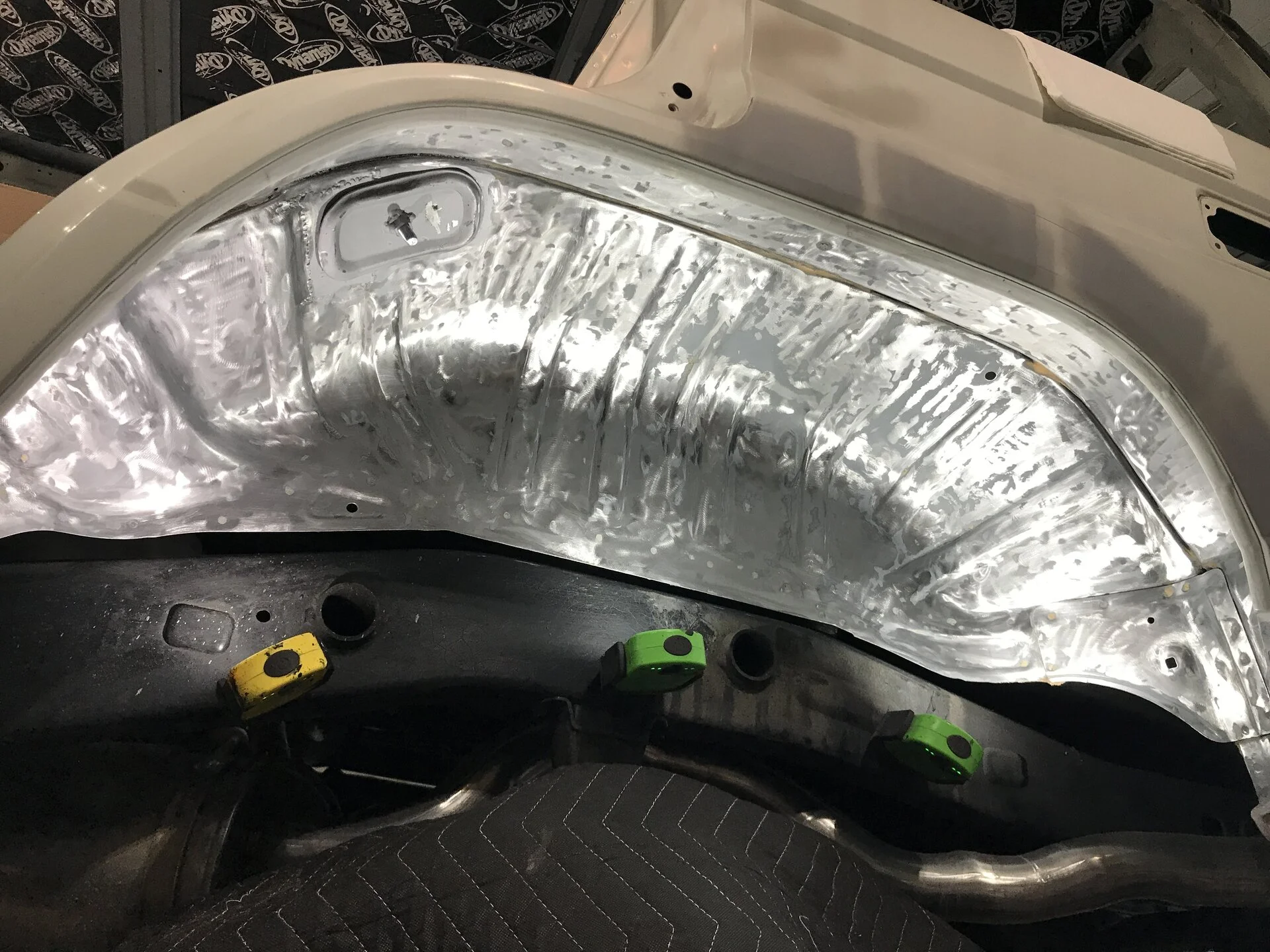

still fighting it, since I had to strip a part of this wheel arch to repair the seat belt anchor thing... I re-did the entire wheel arch.
same old routine, wire wheel + Roloc disc and then clean with Isopropyl. The Roloc disc are really great they don’t remove any metal and work great at stripping old paint. They go quickly and are expensive but they do work very well.
and after 2x coats of DTM epoxy a couple of layers of pumpkin spice 3m seam sealer. Still waiting on the undercoating so once I get it I can finish this off.

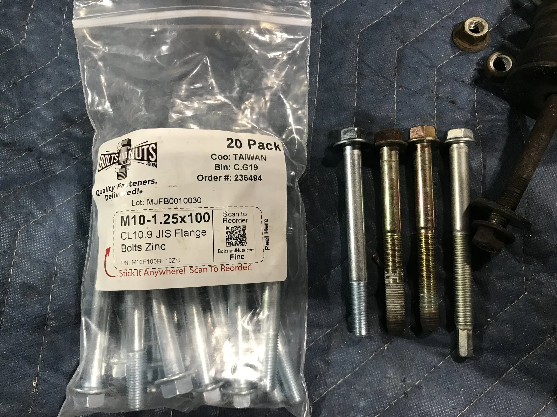

I never want to do this again, replaced them all even the crappy little guys who probably don't do nutten.
I would post the part numbers but that would deprive others of the fun. seriously it's fun don't underestimate trying to figure out what you have and where you might find them. The part numbers are cast right into the rubber on the mounts. I had several different combo's that were different on both sides.
one bit of errata: The new replacement bolts Toyota specs are the ones shown on far right, fancy hex portion on the bottom. I found it impossible to get a full bite on the lock nuts with these. I used some 100mm 10.9 from bolts and nuts. worked perfect. The threaded portion is a little shorter but you can see the witness lines with them side by side. They have just enough threads to work. Depth is governed by the sleave in the bushing. They had just enough thread as well on the bottom to get a full bite with the lock nut. This does not apply to the front bolts; they are miles long - no troubles on those whatsoever.

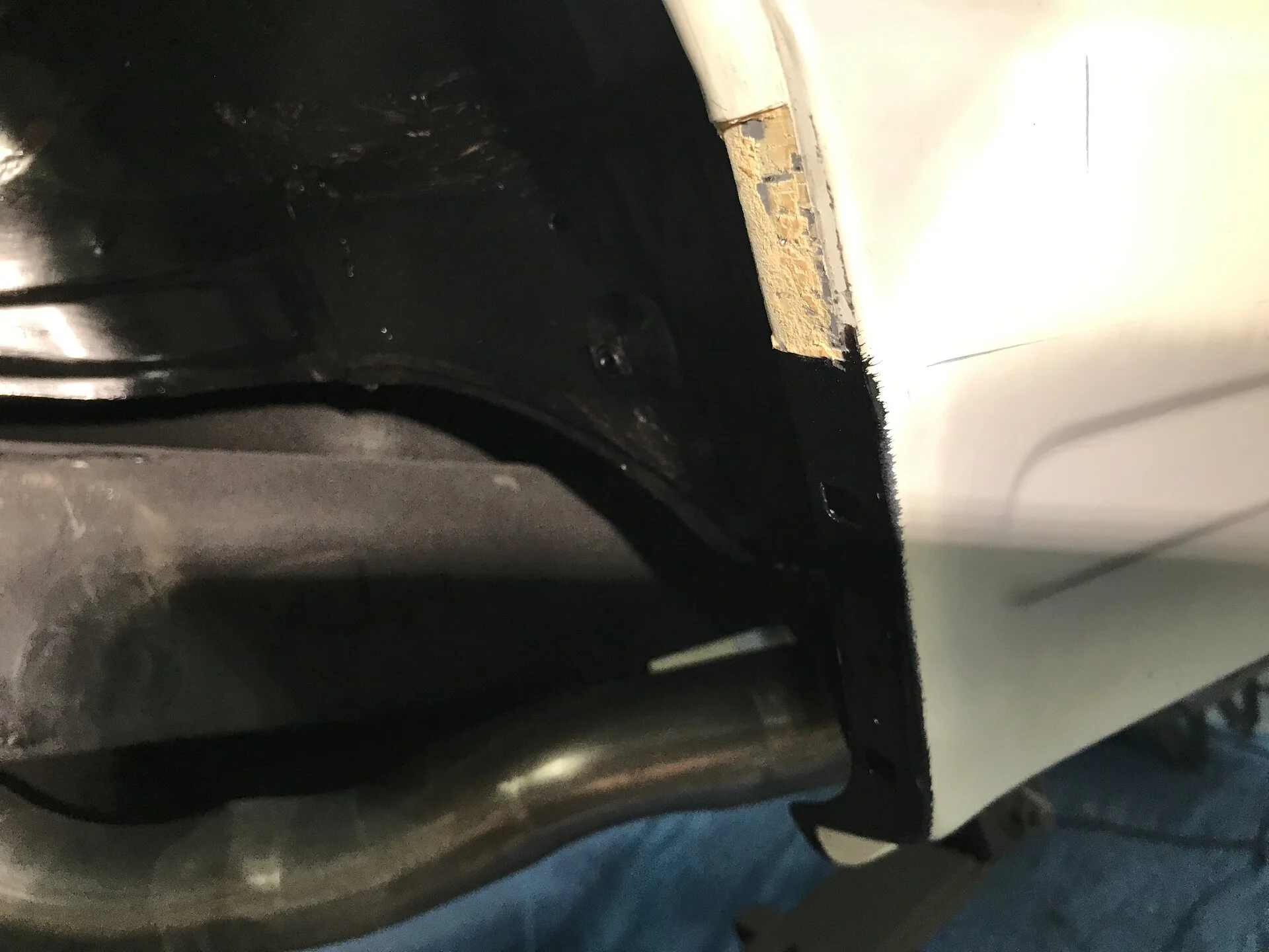

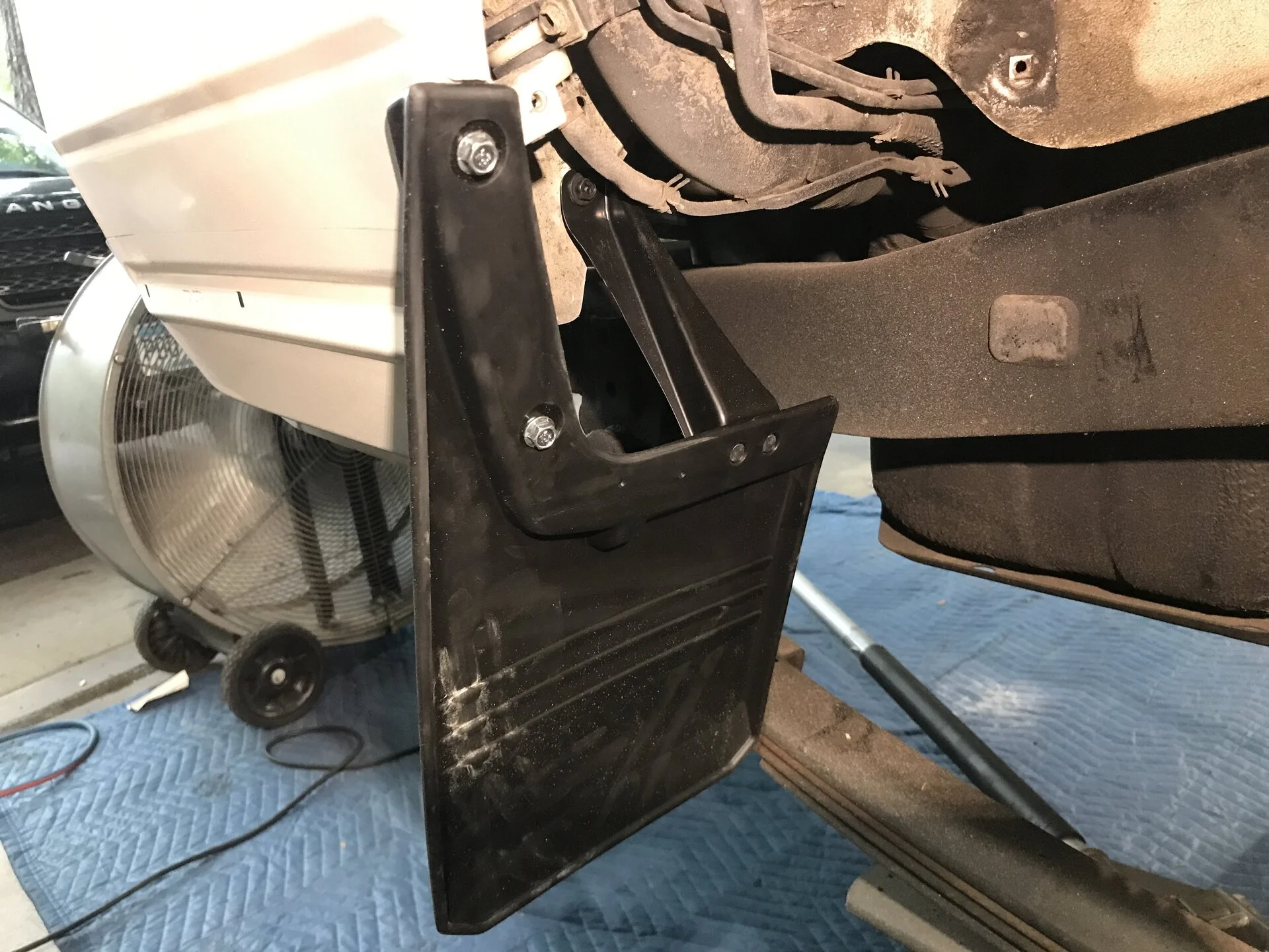

so, I'm not going with a stock bumper setup in the rear, still not 100% decided on how that is going to go but I do know 2 things. I need to plug the holes where the rubber mounting strip is attached and better test fit the non-over fender flaps to make sure things line up before paint.
and they don't line up. bust out the autobody remodeling tools.

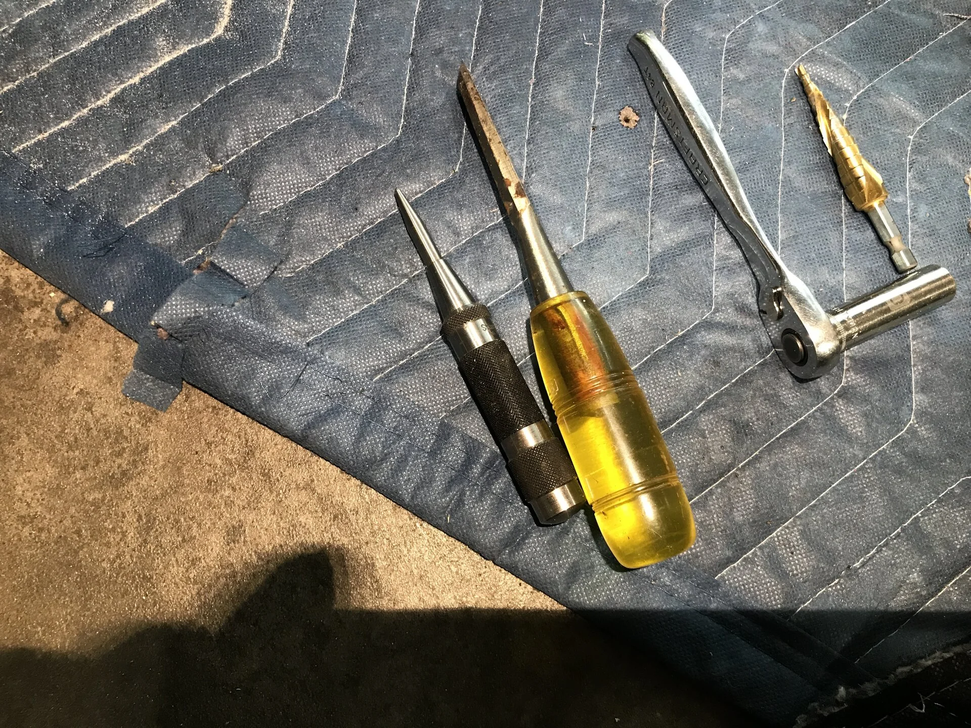

the old Stanley chisel I found in the yard one time planting a tree comes in handy for seam sealer. it's been sharped a lot now, I'm pretty good at sharpening thing... no I will not sharpen your chisels for you.
Really glad I test fit them I would have been really pissy after paint happened.
the new rounds will work.
yep perfect nice!
and will finish it up with a 2x coat of DTM so the paint guys can re-pave over it.
one side down 1 to go on plugging those holes.

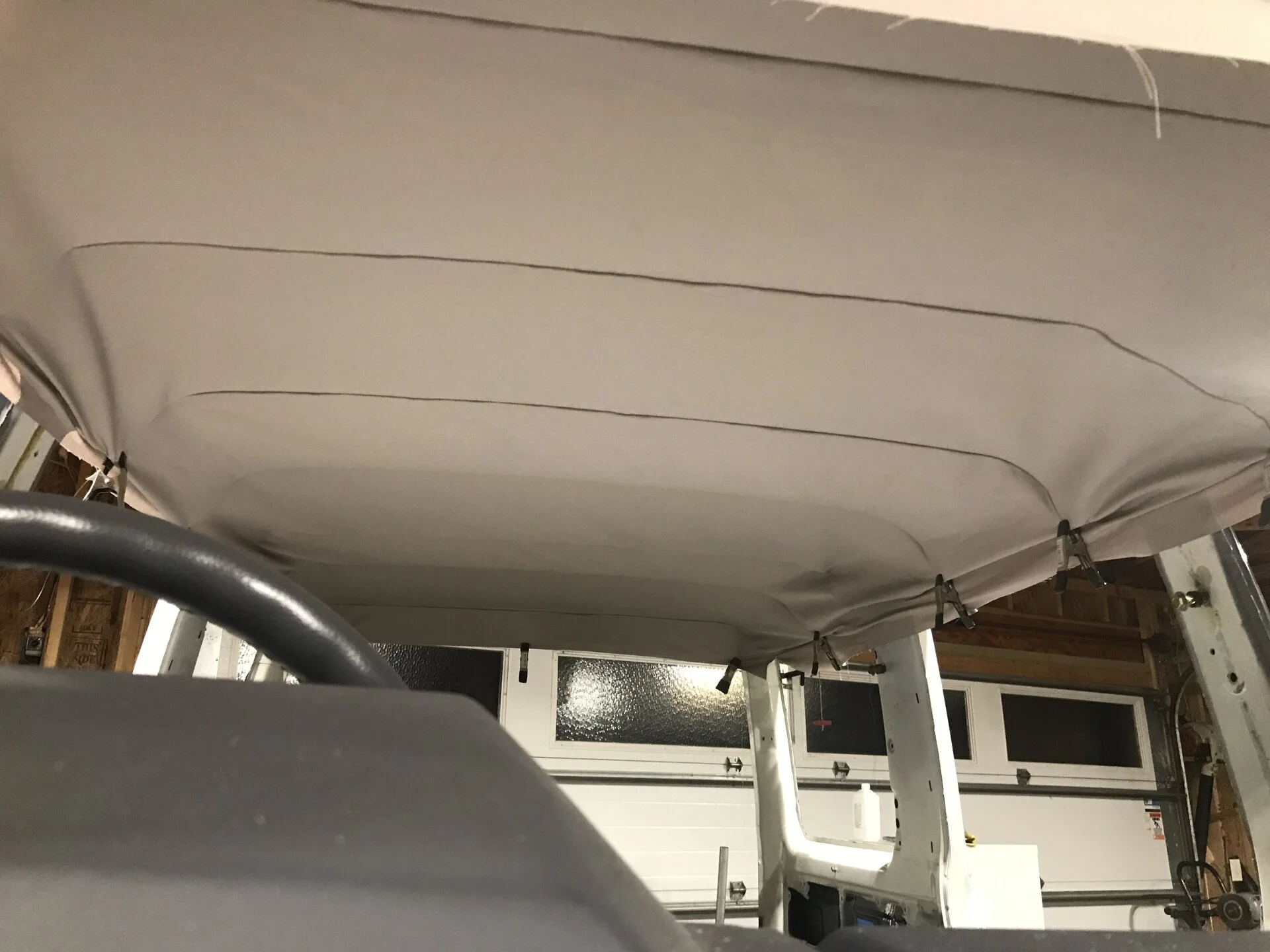

beta test Version 0 of the headliner went about as well as expected... it's going to take some wax on wax off to get it nailed. I learned some differences exist between the moonroof and non-moonroof wire lengths so I will make some changes to the pattern. The pattern will need to be a hybrid of the rear 2x panels of the moonroof truck with the rest from the non.
But overall, I did not expect it to go into place as much as it did so... should maybe take another 2x shots. I also learned what sewing order not to follow.

Version 0.1b headliner is getting better
I blew a couple of seams. I think using the canvas as the wire sleaves is a mistake. The sleave material will need to be something with more give/stretch/flex to help things ease into place. I'm going to need to go looking today for seam ribbon.

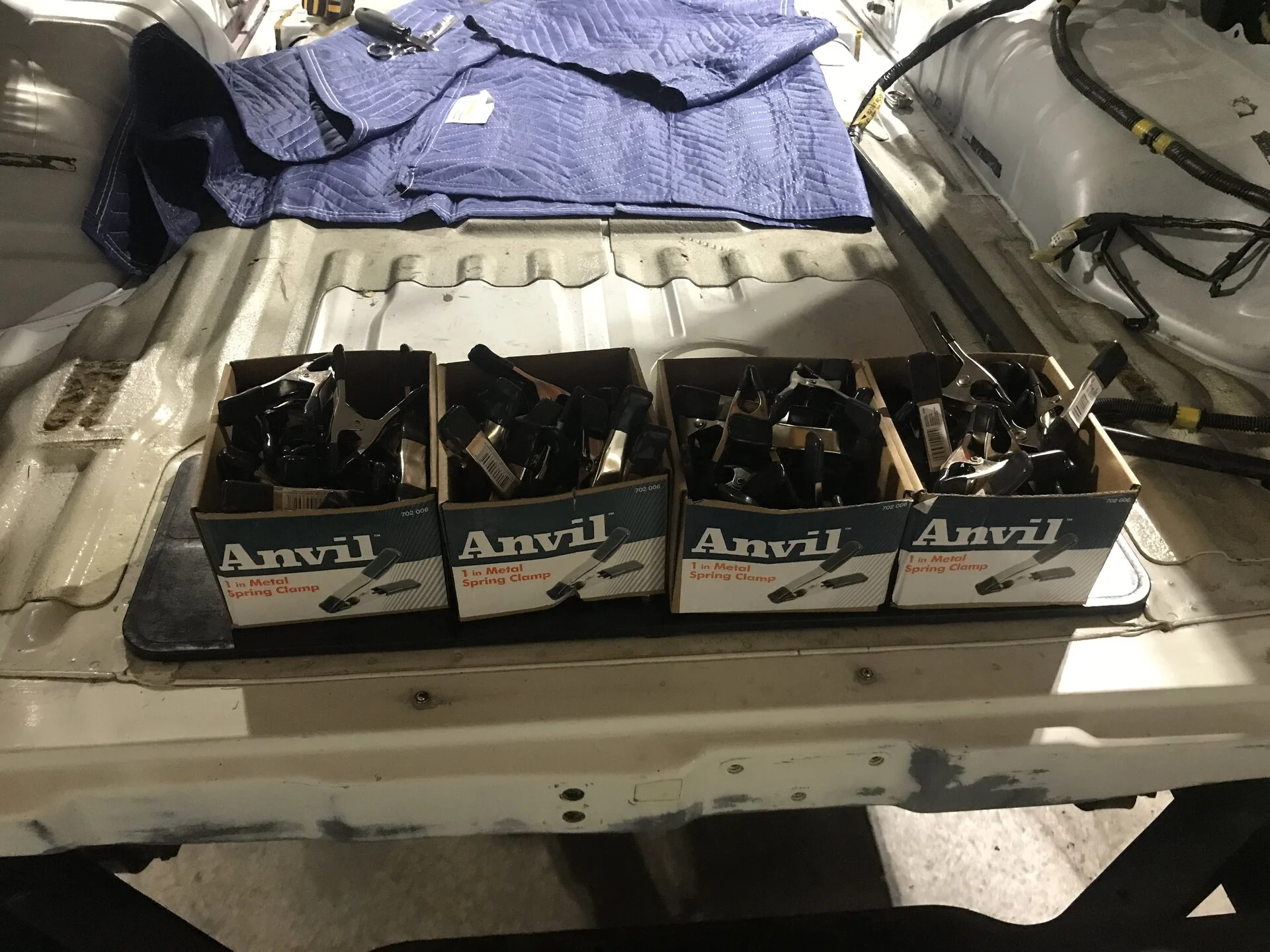

you can never have enough spring clamps, oh wait yea I have enough now

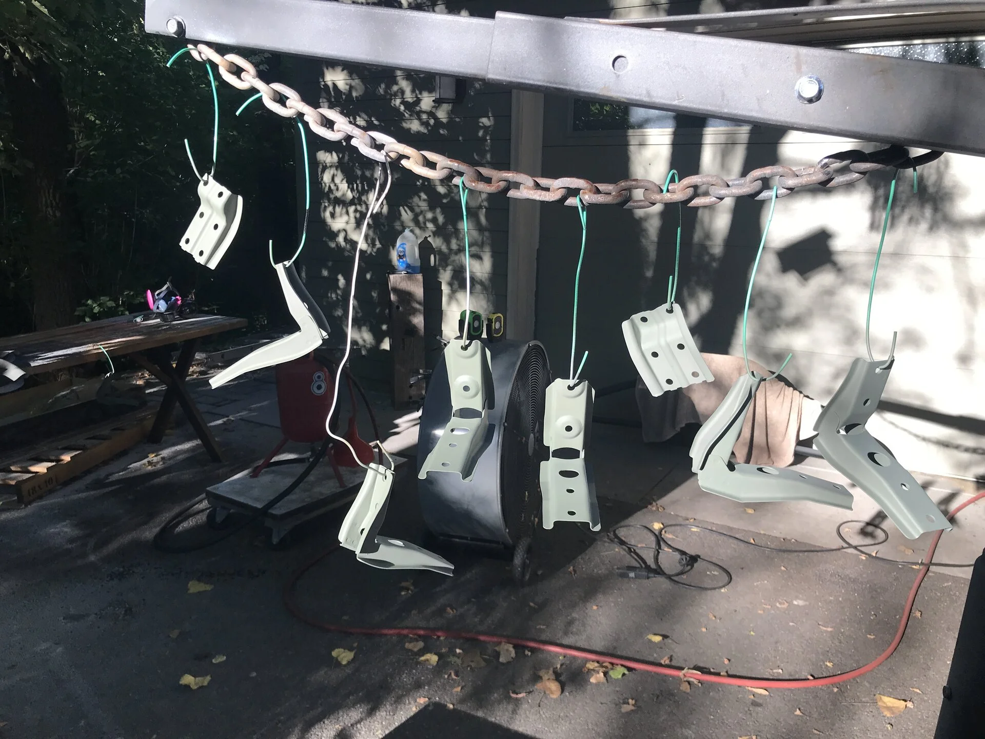

it was blast, etch, paint(pending) running board bracket sub-assembly side step day. I know you can still get them new but mine were still ok with just minor rust so re-use is in order.

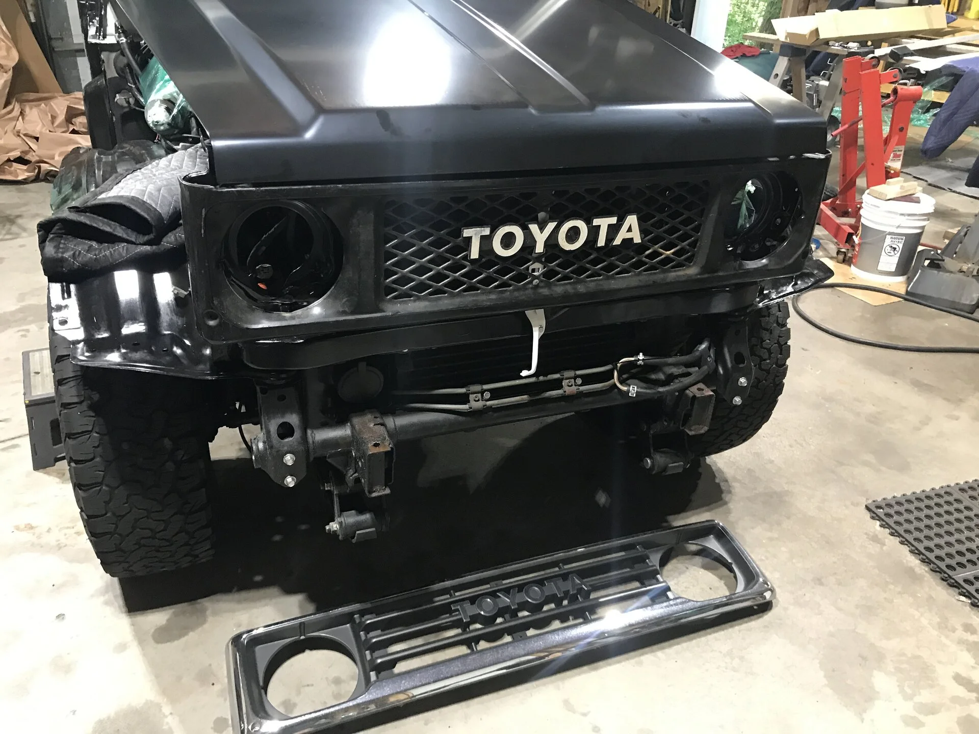

@FJ73Texas and I struck a trade of fun bucks and his exotic golf club grill. the packing people labeled it golf club
I need to put the front clip together to make sure everything is good so I will make sure it's going to work then blast it and get it looking good again. Wish they still made them new.
