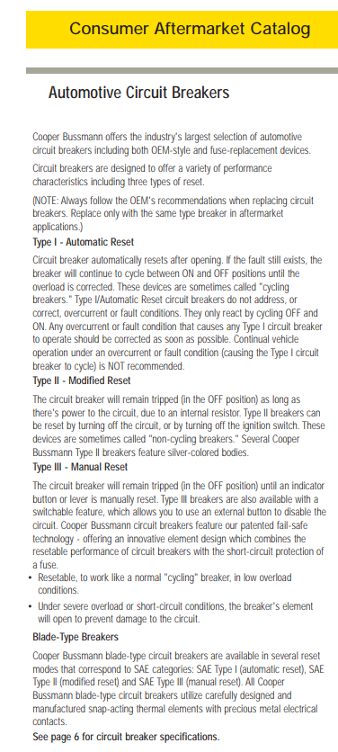

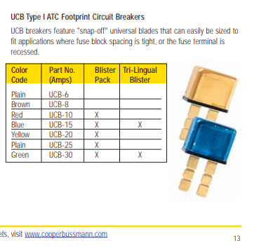

It's a UCB-10 "type I" circuit breaker, auto-resetting. I found it in a Cooper Bussmann catalog hosted on Mouser:
This will definitely help when I go back into the shop, thanks!
