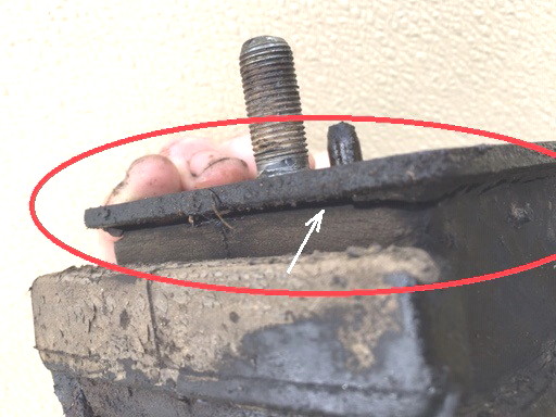

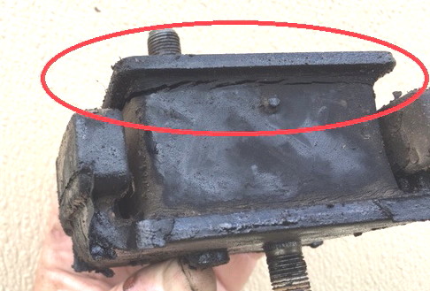

If the motor mounts have never been replaced.....odds are good they have cracks. The rubber dries out and loses its dampening capability.
Here is what mine looked like:
View attachment 3513513View attachment 3513514

Pressing the accelerator increased the engine RPM (creating a new harmonic), I would expect the vibration to go away. Typically between 800 and 1000 rpm it will smooth out. Lower than that is usually where the engine harmonics are enough out of balance that you feel it. When the mounts are cracked or the rubber has hardened too much.....it transfers to the body of the vehicle.
Anytime you feel the vibration....increase engine rpm just a few hundred rpm and see if it goes away. I'd wager it does.
IF it does....consider replacing the mounts and making sure your engine is in good tune (good plug wires, spark plugs, distributor cap and rotor, clean the intake, be sure there are no vacuum leaks, etc).
Yes, you can change out motor mounts (and trans mount) without removing the engine. Its not fun, not fun at all.....but doable.
