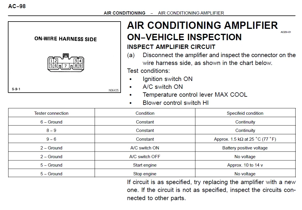

I removed and disassembled both the a/c amplifier and the controls. I don't see anything out of the ordinary on either. I also tried using the switch to manual on back of controls.
I'm just trying to figure out at this stage if I can somehow test the A/C Amplifier before spending big bucks on one. Would it be worth trying another set of controls? If I use pre-97 manual controls, will it "bypass" the a/c amplifier and potentially move the servo?

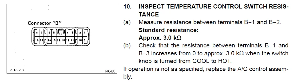

I removed and opened the controls yesterday. I cleaned out the slider part with compressed air but doesn't seem to have done anything.
I may try the test you posted with ohm meter and use a friend's controls to verify that's the issue.

I was able to come up with another amplifier and I was able to confirm that is not my issue. Next step will be to try a different set of controls.
