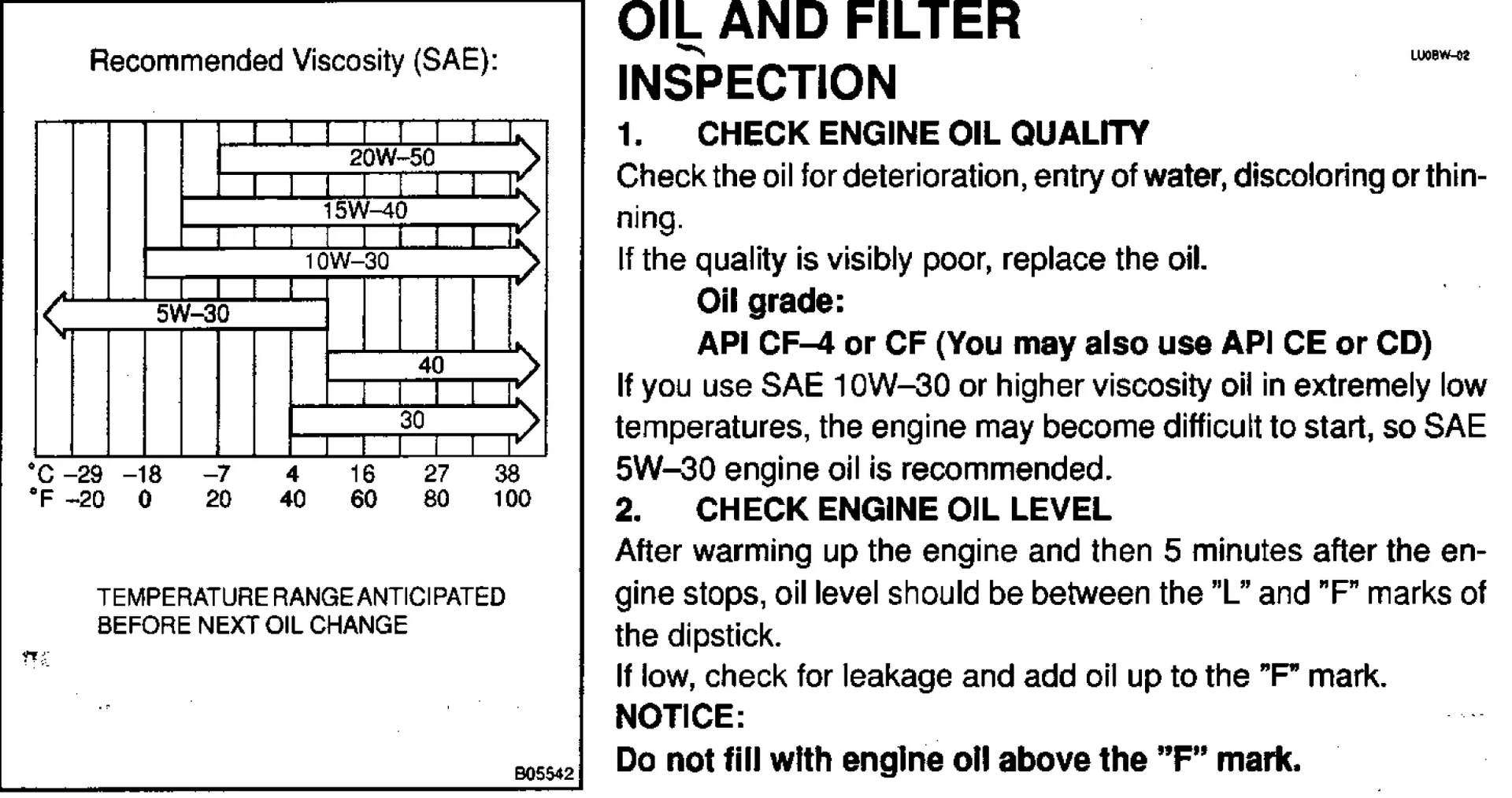

Getting my 1996 Prado soon 1KZ-TE engine,
I am from Alberta, wondering what kind of oil you guys all using? do you switch oil type between summer and winter?

I am not very good at reading manuals, understand some of the "old" vehicles were built for mineral oil only. is 1KZ-TE this case?
Is any where in the manual saying 1KZ-TE engine should better stick with mineral oil?i thought synthetic is always better? no? 🤔🤔

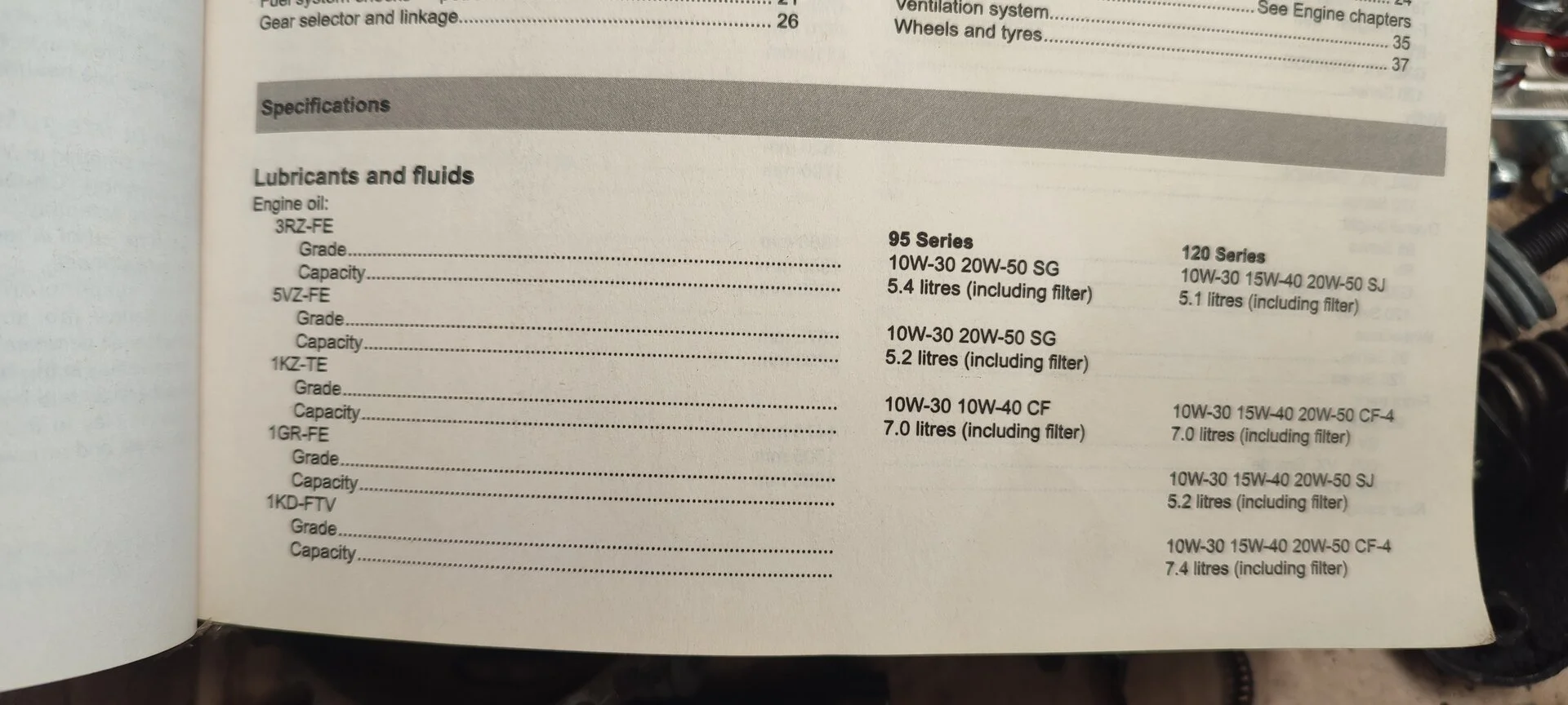

Yes I believe it is the case. I can't remember specifics. I've just got an old engineer friend that knows his s*** and drills these ideas in to me haha I'll try and remember to pop down the shed tomorrow and have a look at the manual for you, see if it offers alternatives.
So here's my manual. I just had my engine rebuilt and the engine builder used 15w/40.

Synthetic won't really help this engine as it produces large amounts of soot and ash in the oil. I believe this engine needs 3K or 6K oil changes. In engines with longer oil change intervals you can really see the advantage of synthetic.
