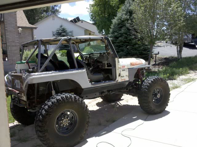

When I want to go wheeling, I drive this:
You can see the 40ft toy hauler parked in the street that it is transported to the trails in.
the cruiser is a play toy and daily driver. Nothing more. they were all dog slow from day one. I appreciate your brand loyalty but in the wheeling world, we run the combination of parts that work the best. 80s are close, they just need a little more mojo. That old forklift 1FZ should have been left in the forklifts. It has no business powering a highway vehicle.
oh, and that jeep? it has a ford 351w efi motor and a full manual valve bodied C6.
Now run along:princess:. The guys who know how to do an engine swap are talking engine swaps in here.

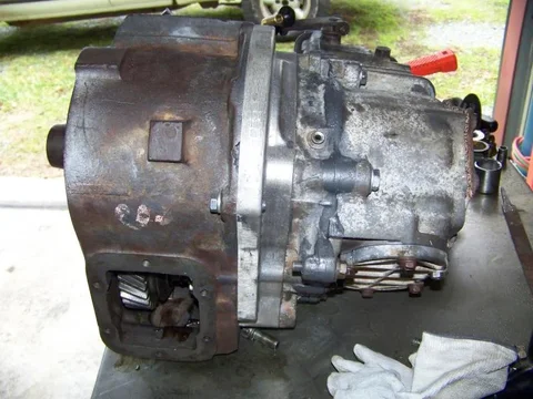

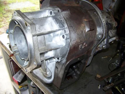

I did not use the AA adapter and shaft for the front of the 203,. I used a 4l65 all wheel drive Denali trans and the factory adapter on the trans fits the 203 doubler with out the factory adapter that comes with the 203. I hope that is not confusing, I will put a few pic of what I'm speaking of. The holes on the 203 do not line up with the 4l65 adapter, but you can drill and tap new holes and this will allow you to clock the T-case up or down to clear the front drive-shaft clearance problems that other's have run into.
Now for the vss that you need, it has to be in front of the 203 box for it to work with the least amount of problems and to do it AA makes a clamp on vss reluctor ring # [716074]. I used the vss sensor off of a np143 all wheel drive T-case and drilled and taped the trans adapter and set the gap at .0010ths it should be the brass blade on your feeler's gauge.
I hope this helps and if you have any questions please don't hesitate to pm me or call.
