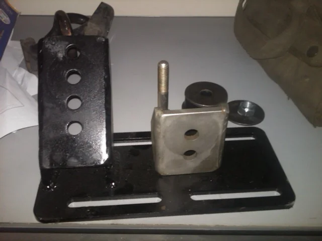

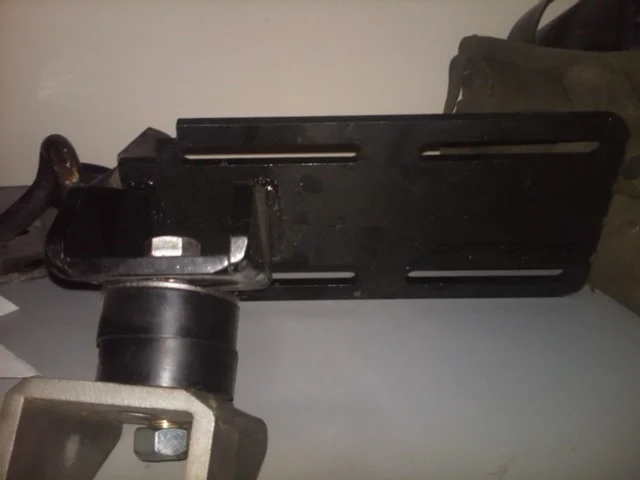

Here is a pic of my motor mounts. Yes, they are fully adjustable. Manifolds everyone run the ls1 blocker hugger headers. There is a guy on Ebay that sells Stainless block huggers for 200 to your door but you need header spark plugs for cylinder 1 and 4 due to clearencing. BUT they are stainless vs painted steel. As for the pan the F-body pan is what you want to run for clearance. Whats the story on this 203/ splitcase how long does it end up being said and done? Shifters?
View attachment 607548View attachment 607549
Hey man. I enjoy reading your posts. Can you help me understand a few things on the mounts. 1. No cutting and welding necessary, direct install onto the frame? 2. Can you send me the link, model number of the mounts. 3. Reuse the oem rubber mounts? 4. Annoying engine vibration noise from using these mounts? dislike the ideal of fabricating aftermarket mounts. My best friend is a nurse and I have the utmost respect on your occupation. I'm an architect and I have worked many assisted living facility projects. Thanks
Direct fit, no cutting, welding...
