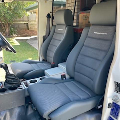

I wish I had such nice seats
Who has nice seats?
I would love a set of gray Scheel-Mann seats. But they’re just not in the budget right now.

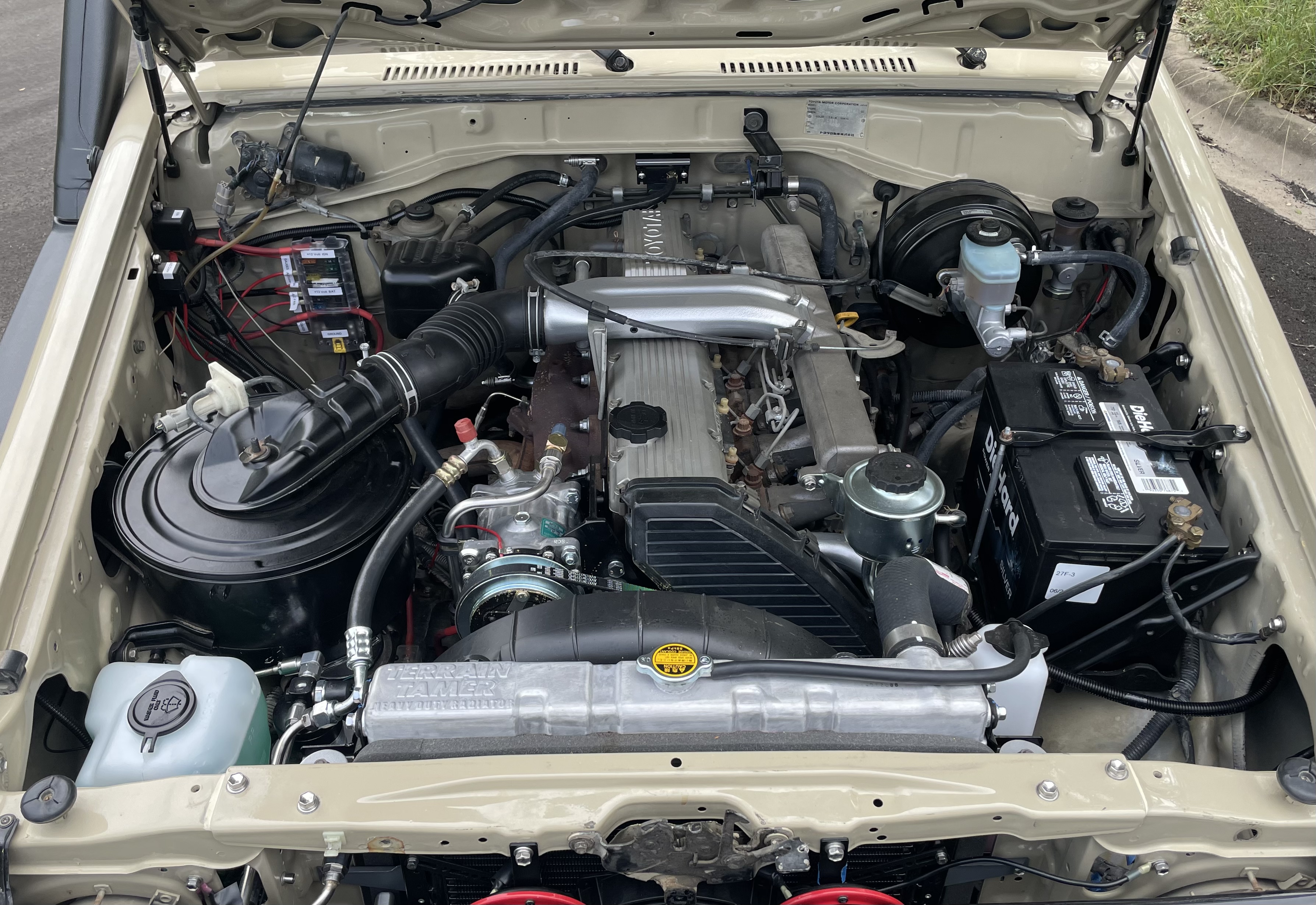

cheers for that! Since my last post, I actually tracked down the culprit of my AC issues ... one of the wires to the pressure switch temp sensor was severed right at the base of the connection, where it plugs into the engine block, right in front of the injection pump. It's a short little bit of wire harness that luckily has connections on both ends so it will be easy to replace, just need to know a part # for it, which is proving to be tricky. Anyone happen to know? See attached pics for reference.
