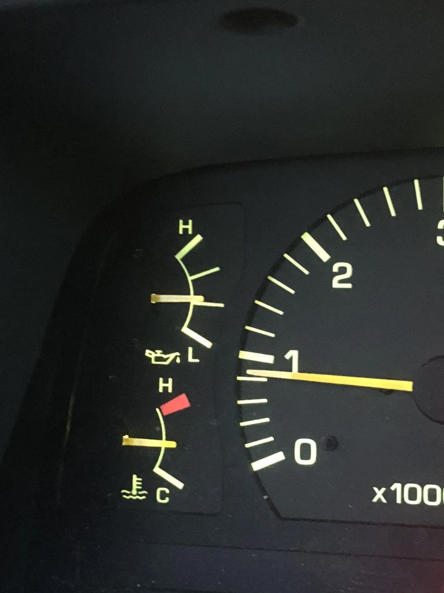

My oil pressure gauge seems to be dipping lower than I remember, but it goes up to the second highest line while accelerating.

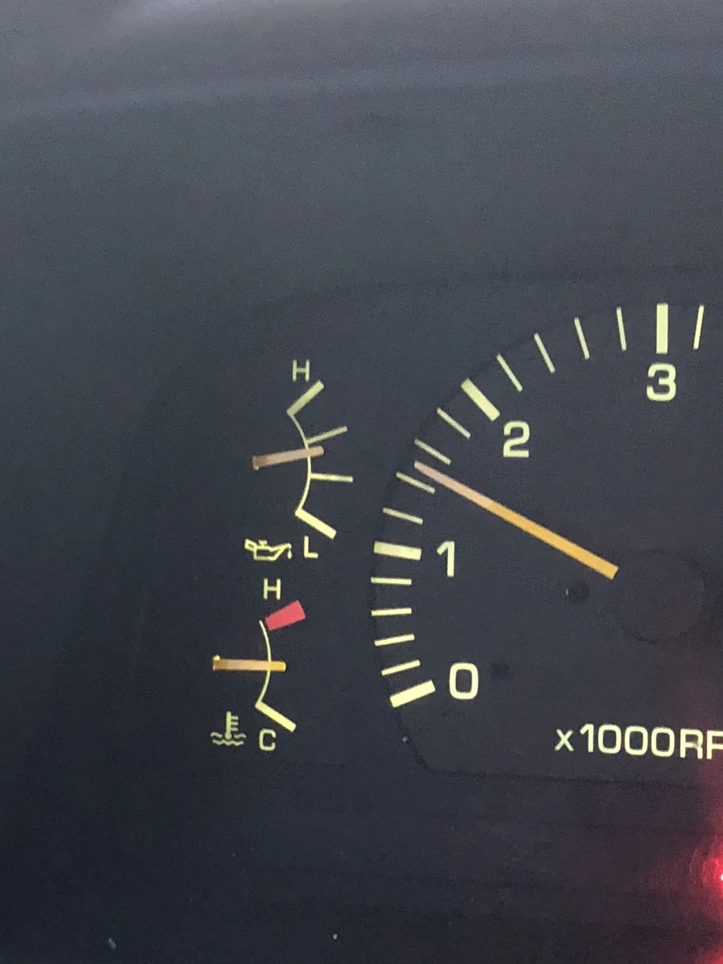

Since then, I've been paying more attention to my oil pressure meter on my dash and it seems to hover lower than I remember it being before.

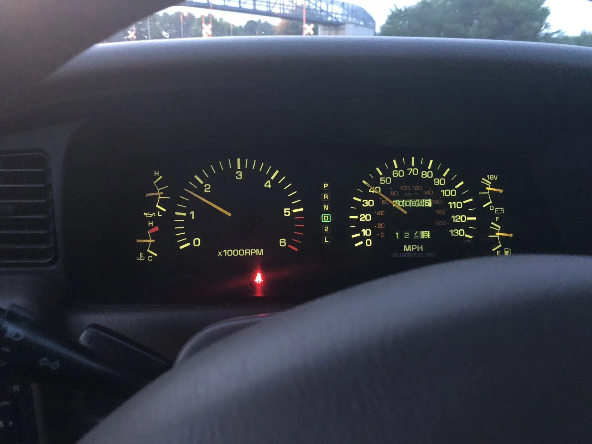

The photo below was immediately after starting my engine following it sitting in 100 degree weather for 1hr - No smoke upon startup
This was while accelerating out of my neighborhood: 1400rpm no smoke
Still accelerating: 2400rpm no smoke
Cruising at 40mph downhill: No smoke
Stopped and idling at stoplight 10sec after the photo above: No smoke while decelerating or after accelerating from the stoplight.

your oil pressures with the gauge look fine, keep in mind that its not the most accurate. its there to give you an idea of the pressure not so much an accurate reading.
That's good to know. I figured as much, but still wanted to call out that it does seem to be averaging lower than I remember it being before.

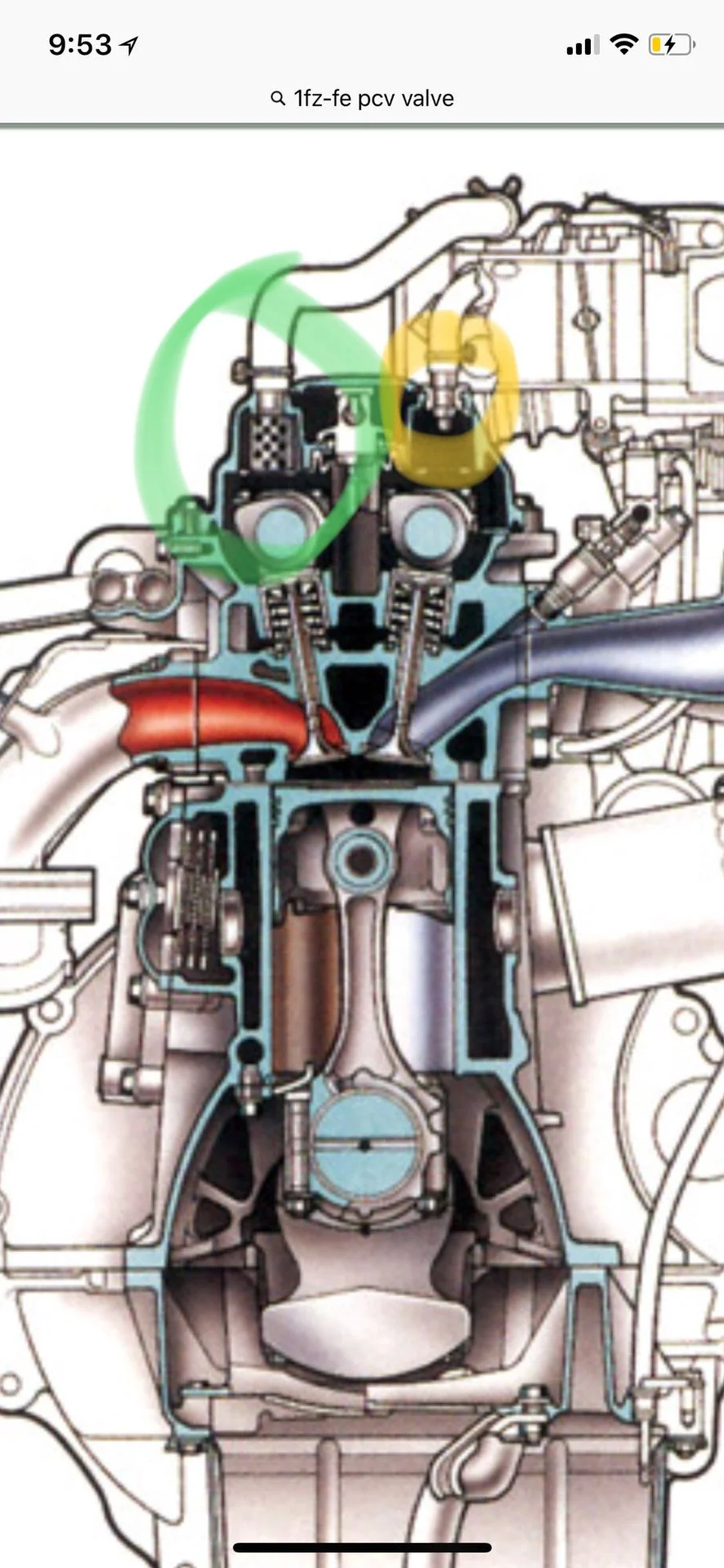

Thanks everyone. I checked my oil catch and I believe that it's actually restricting functionality of the PCV because there's not a drip of oil in the PCV catch.
What I can't seem to figure out is what the heck the other ventilation hose coming from the crankcase to the intake is. And nowhere else on the forum can I find an answer either. I think what's happening is that the PCV line to the TB is blocked so the engine is having to find other means of letting off pressure and it's forcing that pressure out of the other ventilation port on the valve cover, through the hose and into the intake. What the heck is that hose for?
In the photo below, the yellow circle is the PCV and the green circle is the other ventilation port that no one knows what it is. I can't even find explanatory parts on the exploded parts-views for the 1FZ-FE online. All that the I can see online linking to the area is "Ventilation hose".
You will notice the difference of where the OTHER end of each of those hoses attach.
The pcv attaches AFTER the butterfly in the throttle body.
The ventilation hose it BEFORE the butterfly on the TB.
The pcv system will see much higher vacuum at idle than the vent side.
Based on what I'm thinking about in relation to your problem, it is definitely your improperly set up pcv system tight niw. I'll type more next week when at a keyboard.
Get rid of the catch can and install a new OEM pcv valve and hose. And ventilation hose of needed.
