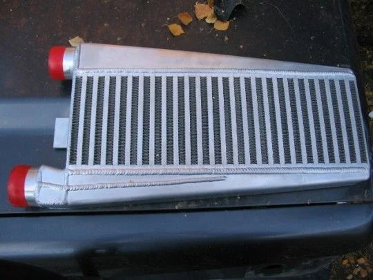

Intercooler install
let me be the first to say that i have a very vague idea of how to install the intercooler in this rig. i have never installed one before and i want to try it on my own rig before i do a customers.
i contacted Bell Intercoolers in Texas (thanks for the lead on the other thread) and Gerhard was great help. we designed the unit to drop .05 psi from the turbo to the throttle body. it is supposed to drop the temp of the intake air from 72C to 30C, WOW!!
i tried to make the intercooler fit properly between the grill plastic and the rad. the front support will be taken out or modified and the lower box support will have a notch cut into it, the next one i order will be 1" shorter in height as this one is just a bit tight.
i found a web site that has all the rubber elbows a guy could ever need and they also turn and reduce to enlarge as needed. this is high end stuff.
anyway, here are a couple pics of what i think will work. if anyone has a different suggestion short of a different cooler feel free to post it up.

Good to know you can order a custom intercooler .. you need to know the amount of CFM to your engine and flow of your turbo .. ?

Looks good wayne!! Inspiration to get off my butt and get the intercooler in the 61.
It's a different style then I thought. I just assumed that the inlet and outlet would be on different ends of the cooler. Looks like it should work well. Are you going to run dual boosts gauges just for a test. I would bew interested in the lost pre and post cooler.

Are you worried about blocking any air intake with your intercooler?
i am planning on using mopac on 16th. i think Marc got some from there or i will order in from Europe from http://www.forgemotorsport.co.uk/content.asp?inc=product&catalog=0022S&cat=0022S , they seem to have a good assortment.
i am running a fixed fan and at this time i am not too concerned at all but if a concern does arrise i will address the problem then.
