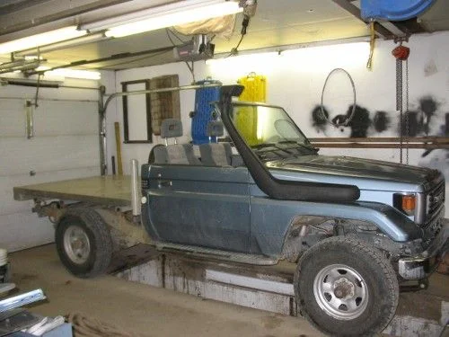

let's see the new custom bumper is sittng at the powder coaters, should be back today or tomorrow.
the 35" Good Year ATS are now on.
the 8274 is waiting for the bumper.
the roof and back have been removed.
the aluminum checkerplate is waiting to replace the door panels
the carpet is coming out for the summer
the bed has been raised 2" to clear the oversize boots
the drawers are now 6" deep vs the previous 4"
the factory windsheild hold downs are on their way from California (www.westcoastcruisers.org )
other than that the intercooler is still sitting on the shelf as is the Propane injection kit
teh 4.56s might be swapped for a set of 4.11s
i have been waiting to get the bumper installed to take some more shots and post them up.

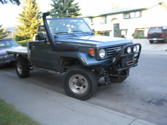

well.

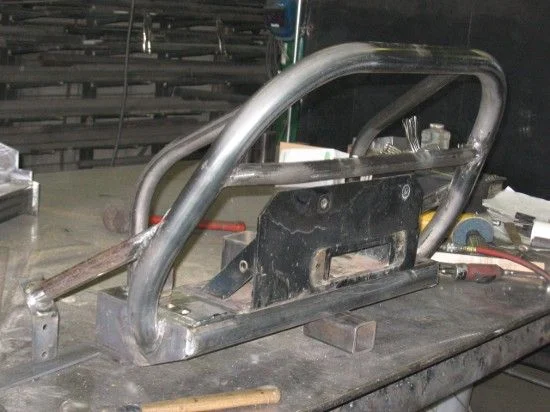

as you know i started loosing interest in this project when it took almost a year to get the trayback done, it still isn't completed. not even close. the shop that is doing the flat deck does FANTASTIC work, he is an artist to say the least but for some reason my projects end up at the bottom of the pile and keep getting bumped back there. I really don't understand why, i pay cash, never dicker on the price (since he knows his stuff and does such great workmanship). the last thing i built for the truck was the bumper, it is my design (some of which i "borrowed" from other fabicators and some of which i incorporated). i think it is a great, light weight, strong setup that allows for the 8274, 4 off road lights, no approach angle concerns and drives the trees or animals under the truck instead of into the cab area.
sad to say, when i started down this road i had high hopes and ideals, expenses and relying on other people to help when needed. once commited, the actual expense out ran the budget and concesions i accepted had to be made. when the project hit a wall then slowly the love of the project died and once the desire has died and there is no forseeable cure to the concerns , then it is time to move on.
the project is dead. the custom bumper is coming off and the truck is gone. end of this story.

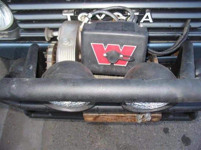

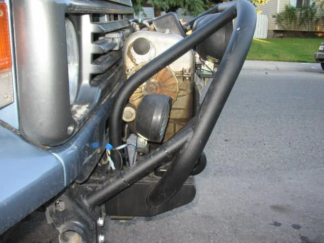

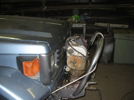

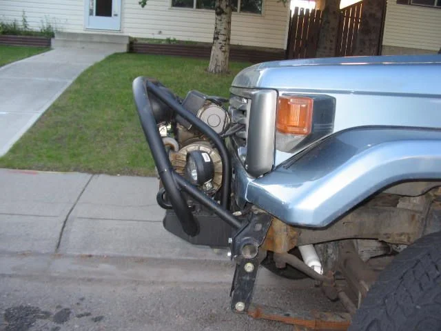

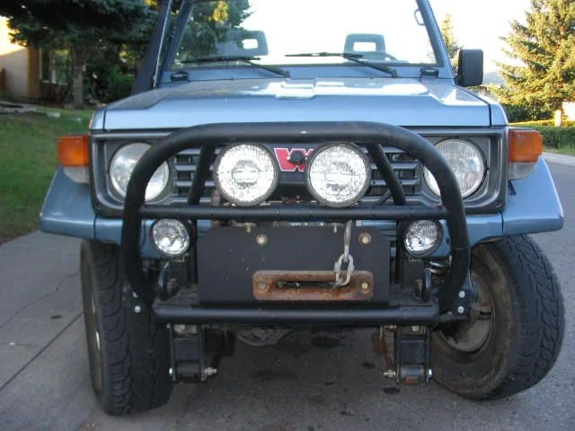

installed on the truck, soon to be taken back off and install on my bush rig. note the clearence as well as the strength points. i bolted to the frame as well as the two side supports. the whole idea was to give the bumper support from more than just the frame horns that the TJM/ARB bumpers use...

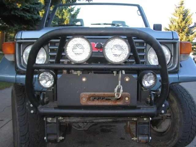

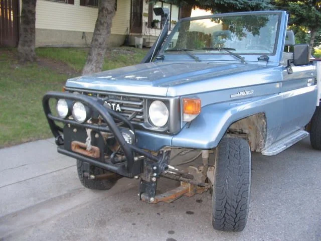

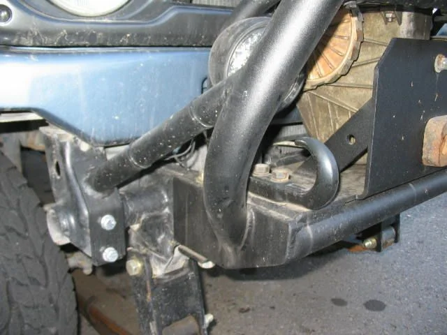

the last 2 shots.
i designed it so that if i wanted to i could add a set of fender protect side bars but never got that far.
