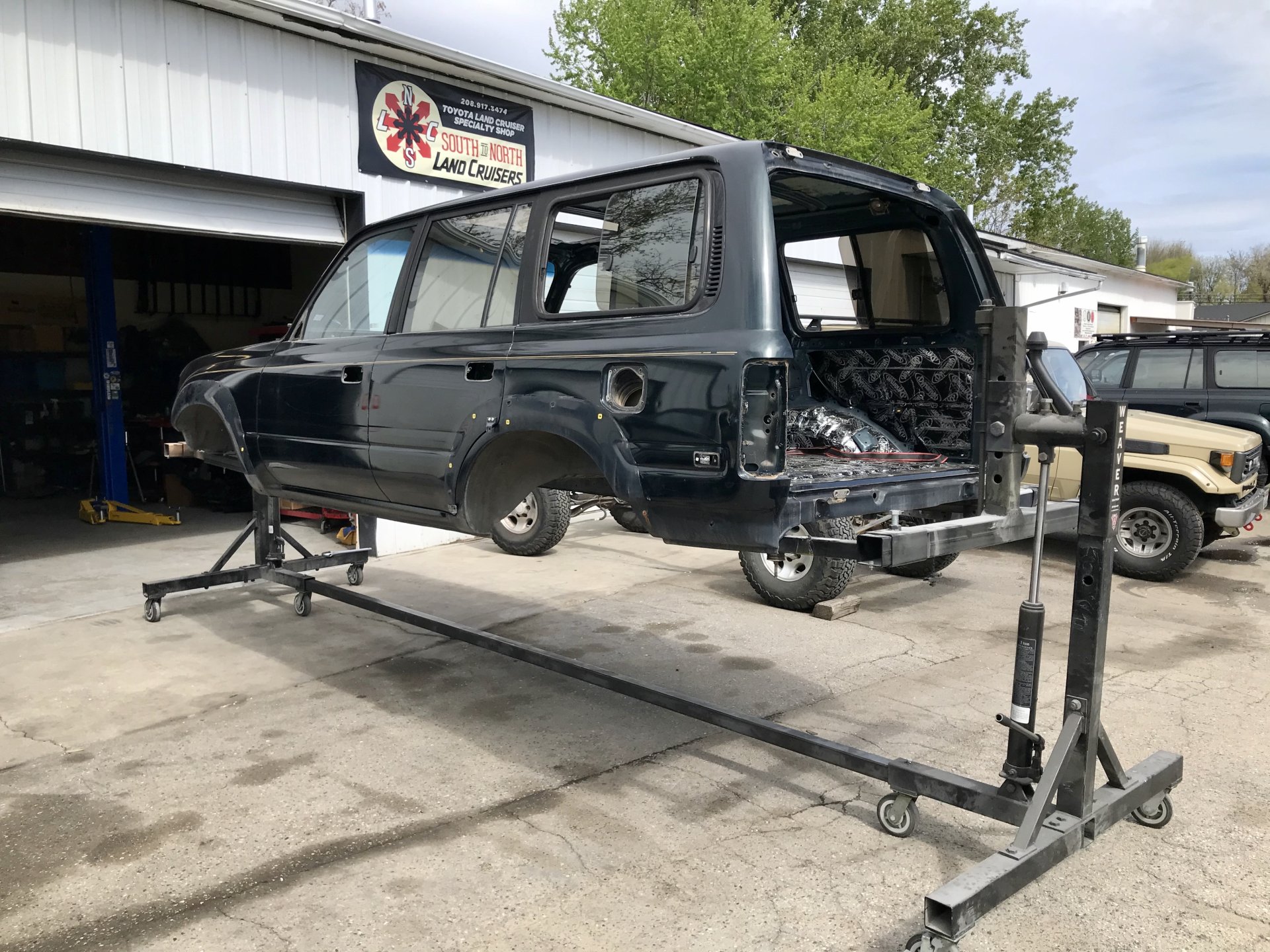

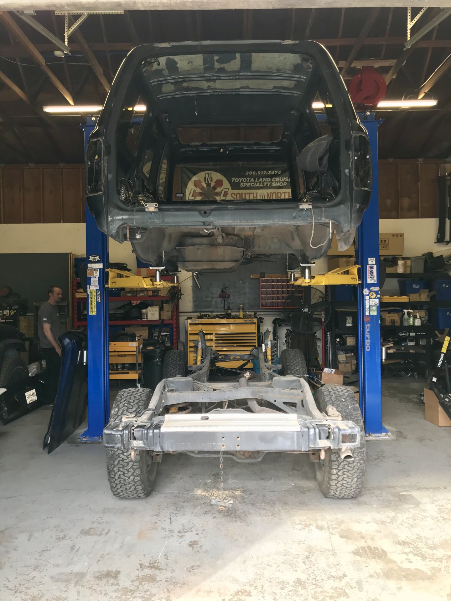

Breaking up the sound deadening job with a complete tear down of the Cruiser. The Cruiser is going to bare frame for repaint and the body is coming off and going on the rotisserie for paint.
