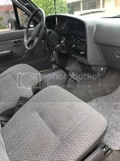

Two months ago I picked up a 1994 Toyota pickup (pre-tacoma) that I'm getting to build into a capable off road rig yet still a pleasantly mannered daily driver.
I was pretty stoked to have found it, and once I looked at it I was pretty blown away. She's not perfect, but a perfect candidate for a clean expedition/rock crawler build. I picked it up for a good price and finally brought her home!

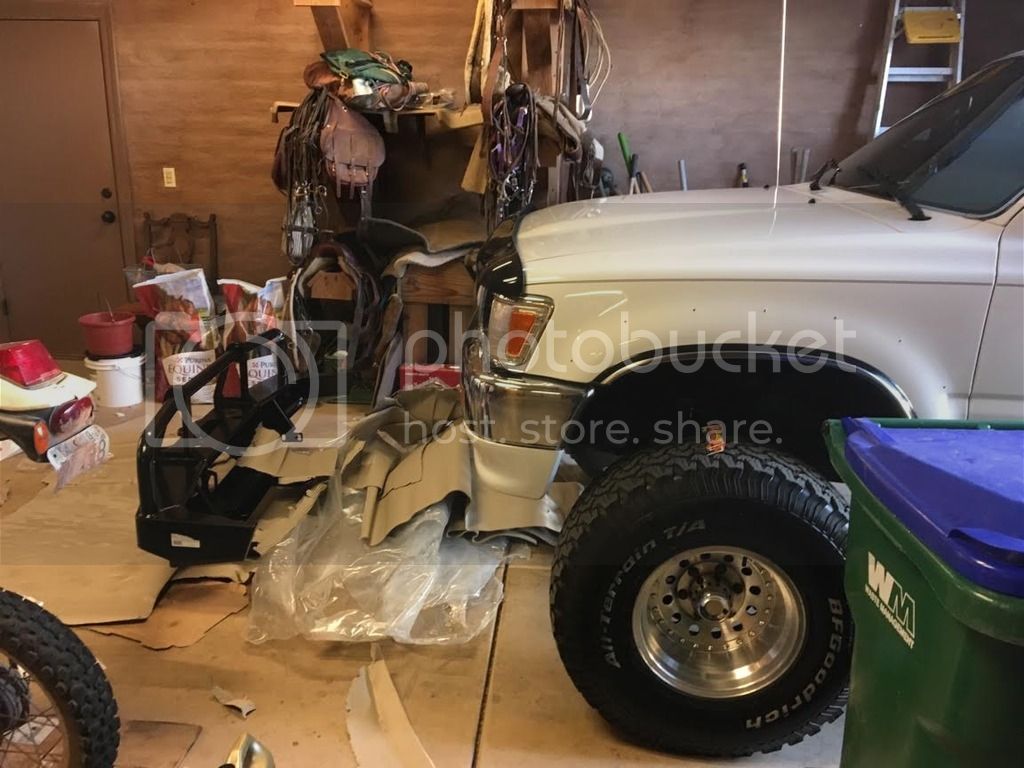

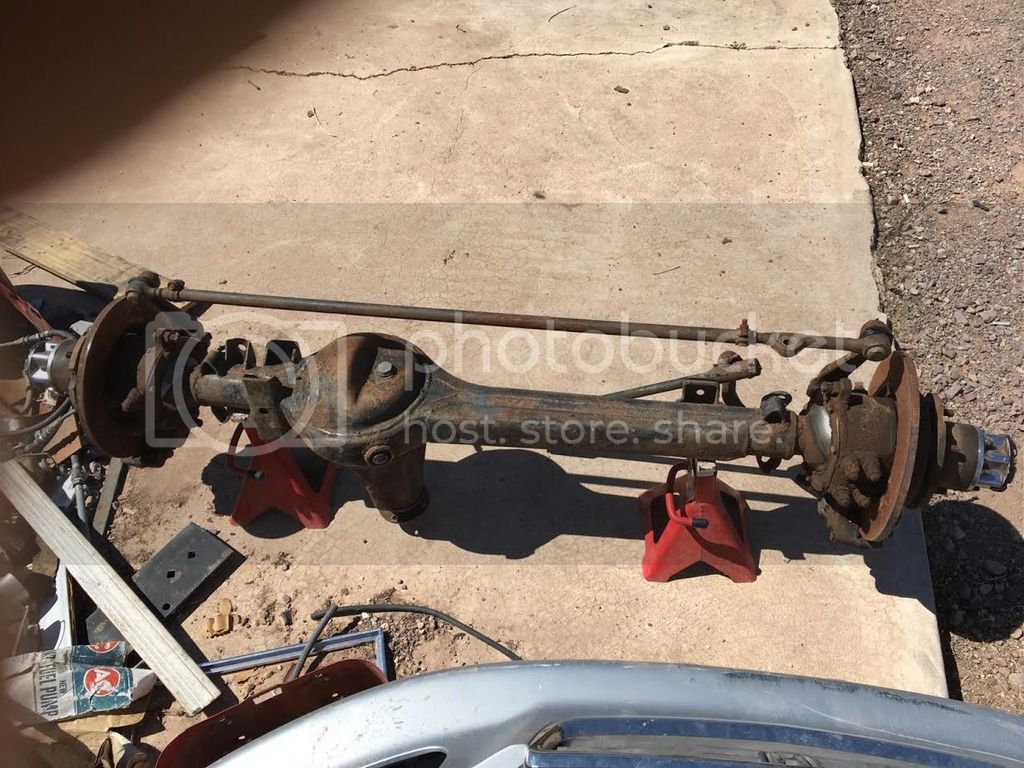

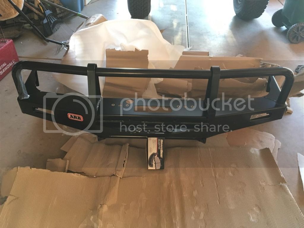

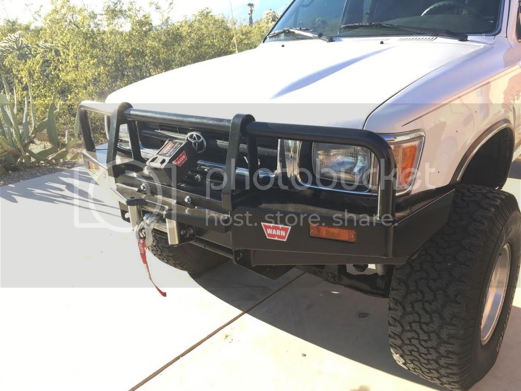

So I finally sold my CJ-7 and was able to put some money towards the Yota. Let's just say I splurged at 4Wheel Parts. I bought the ARB Bumper, a Warn M8000 Winch, the full trail gear SAS kit, trailgear rear lift kit (so it'll sit level) and some lights. I also was able to go out and get a SCREAMING deal on an axle out of a 1985 Toyota pickup - fully complete for only $420 bucks. :hillbilly:
I'm still waiting on the lights, and both the trailgear kits but I was able to get my winch and the bumper earlier this week!
After a little bit of work, I was able to get her on the same day!! I will say to anybody buying this bumper that the instructions that ARB gives you is GARBAGE. Not that it's a hard job, but they literally just give you a bag of hardware and say good luck!

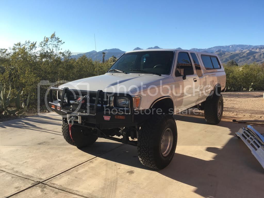

Here's how she sits as of now:
Once I get the lights, I'll throw those on and eventually the TrailGear kits will be coming in and the SAS will begin!! :clap:
