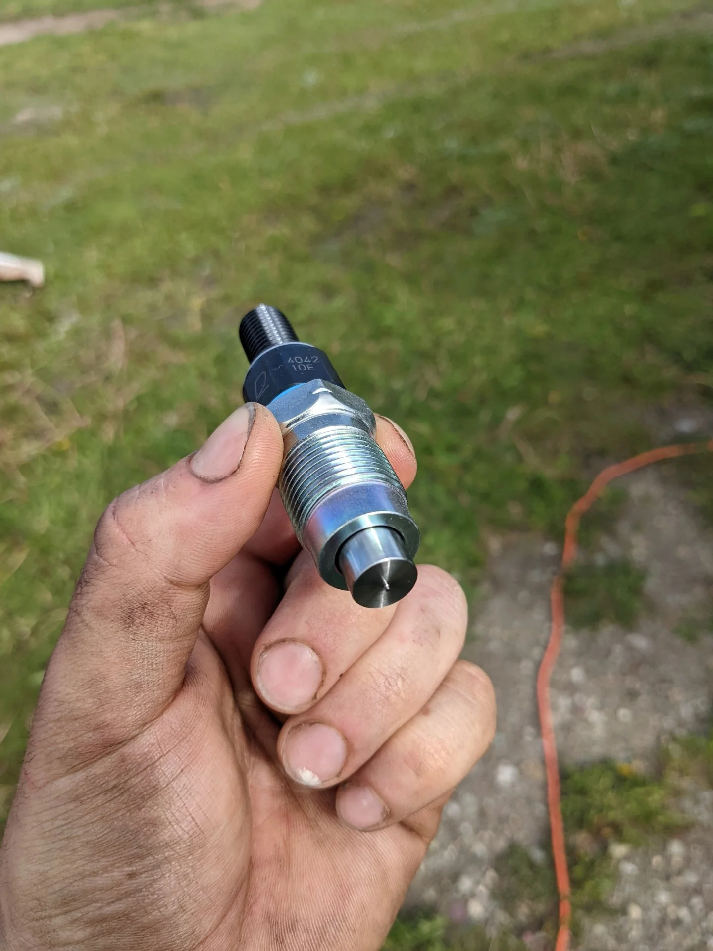

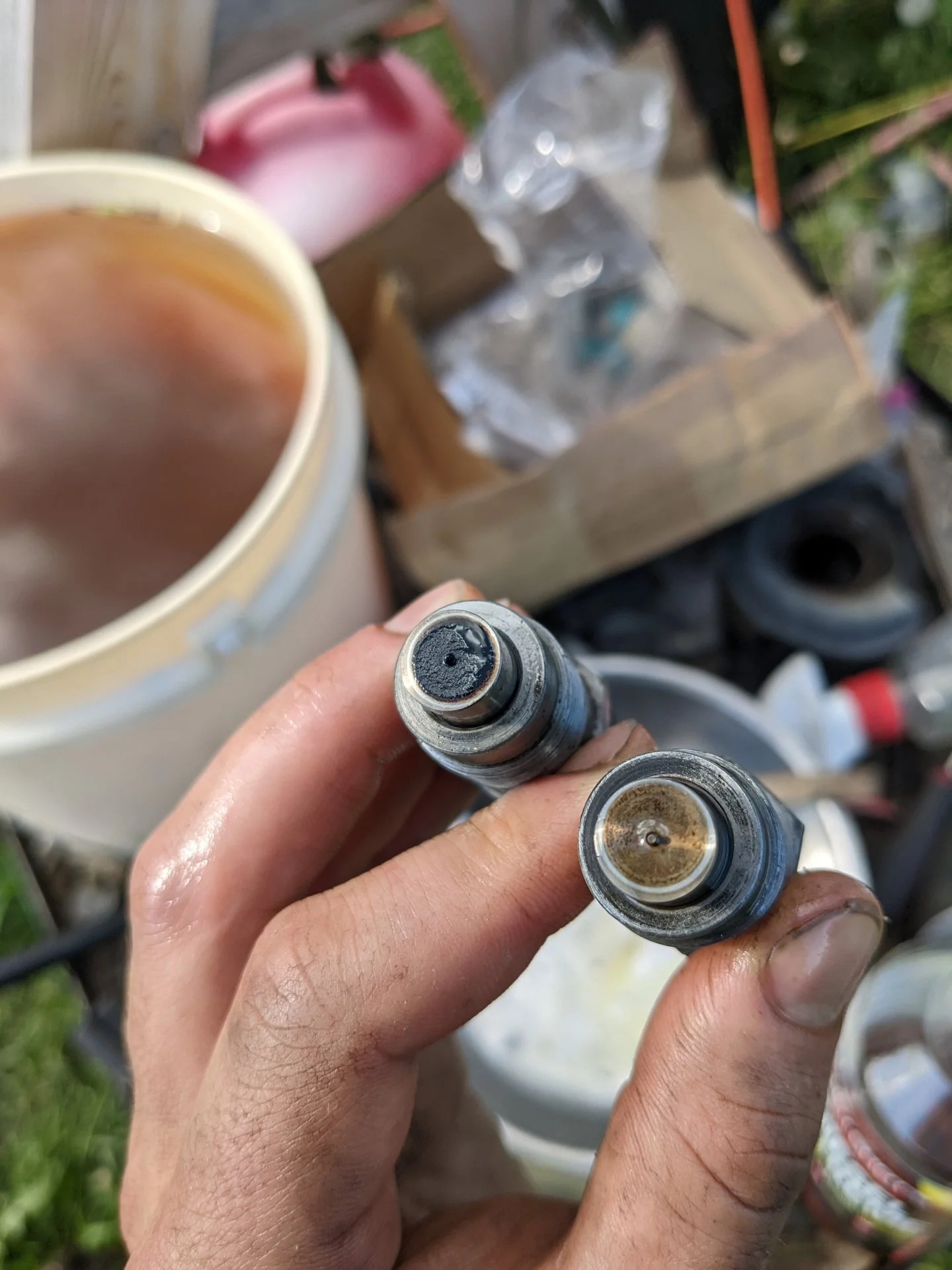

I've tested out a ton of additives most formulations from stanadyne, royal purple, fppf, Lucas, power service, liquimoly but by far the best is hot shots secret, run a tank or two of diesel extreme and then run everyday diesel treat with every single tank. I use the higher dose. I drove cross country after rebuilding my injectors (new nozzles and springs) and felt very little performance improvement, but once I started using hot shots I could use fifth gear on the highway with no issues at all, and no black smoke unless I was really pushing the limit. I was getting 13-14 MPG before hot shots and am now getting 15-16, I even got 17 on one trip, and it seems to be slowly improving. I'm guessing it's giving new life to my injection pump and slowly cleaning it up.
I attached some pictures of the injectors, a brand new one, and two side by sides before and after cleaning. All that black gunk built up after 2000 miles on new nozzles using mediocre additives, I pulled them twice, and I just let them sit in hot shots diesel extreme and it basically wiped right off after that. My understanding is that when you're seeing black smoke, that same unburnt product is building up on your injectors and causing them to run worse. I was in a rush on one trip and was flooring it (I'm pushing a lot of weight, so not all that fast), and had a bit of blow by, and after that I felt I lost performance until I ran through a few gallons of fuel and my injectors got cleaned off again.
I went to a diesel mechanic and told him about some of my problems, asked him to tune my injection pump, and he told me about fuel issues and gave me a few bottles of FPPF total power and fuel power and told me they should take care of it. I thought he was blowing me off because he didn't want to deal with me. Ends up he was totally right, he just gave me a product that wasn't good enough. For the mountains, if you plan on staying in them, you might be able to tune a bit to get a better fuel to air ratio, but I don't know much about that.
Seriously, go buy some hot shots secret diesel extreme and EDT, it'll probably save you so much money and pain in the long run! I really wish I knew to use it as soon as I bought the truck, I would have saved hundreds of dollars on fuel and hundreds on parts and diagnostics fees, not to mention my time pulling things apart (although that was fun).
