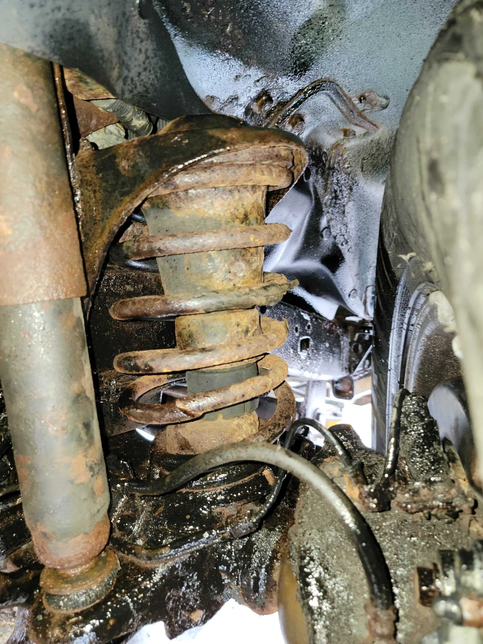

I put a plow on my triple locked 1994 a few years ago. The weight obviously pulls the front end down. Today I noticed one of my coil springs ripping, or splitting. It hasn't broke all the way through. The shocks are due for replacement as well.

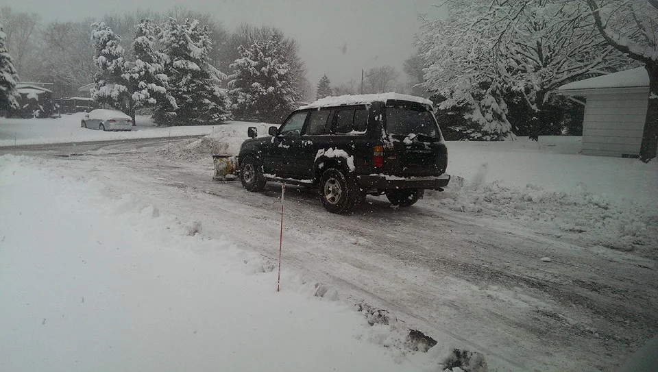

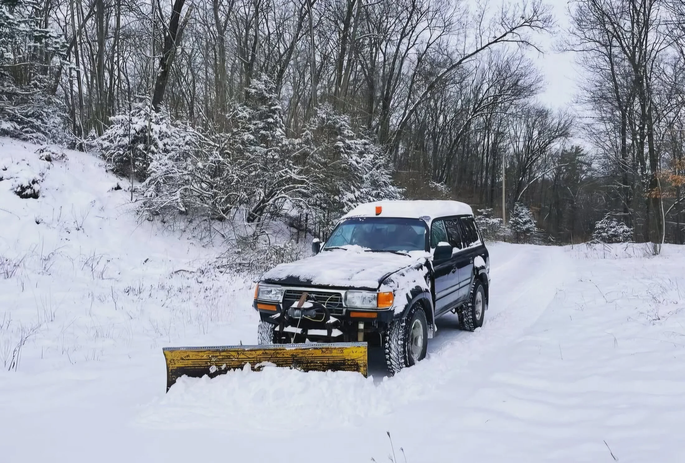

I put a set of air bags in my front coils because I put a full sized Fisher HD plow on mine in the winter. The airbags offset the weight of the plow beautifully. In the summer the plow and plow frame come off to regain my ground clearance. This is my fourth year plowing with this setup and nothing has failed yet. I'm running OME 861/862 springs at the stock height.

It's already sitting directly on the front bump stops.
That front spring is broken, no "starting to" about it.

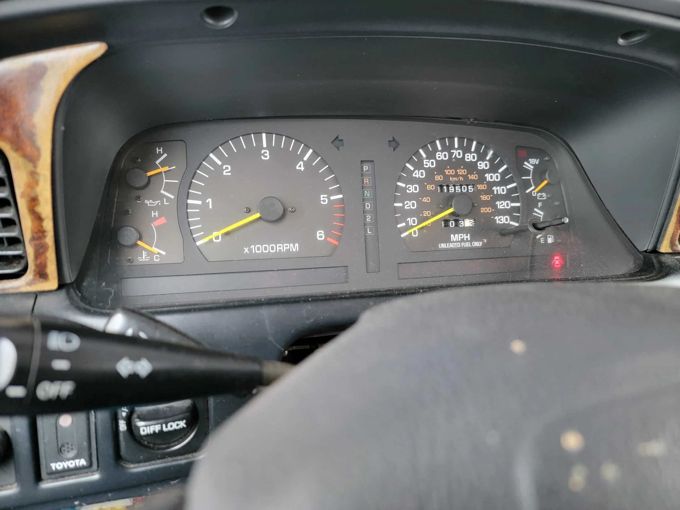

It's a shame that truck only has 119K on it and it's in that kind of shape.
That's a rusty crutch under there.
