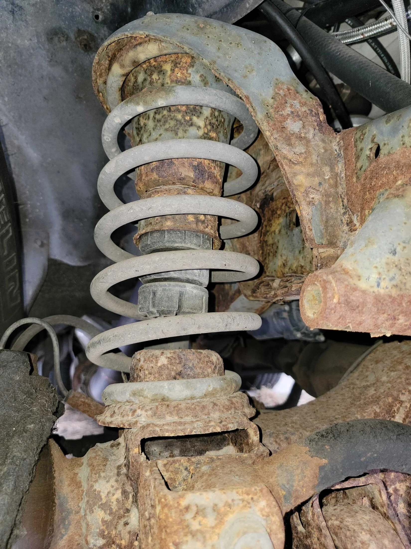

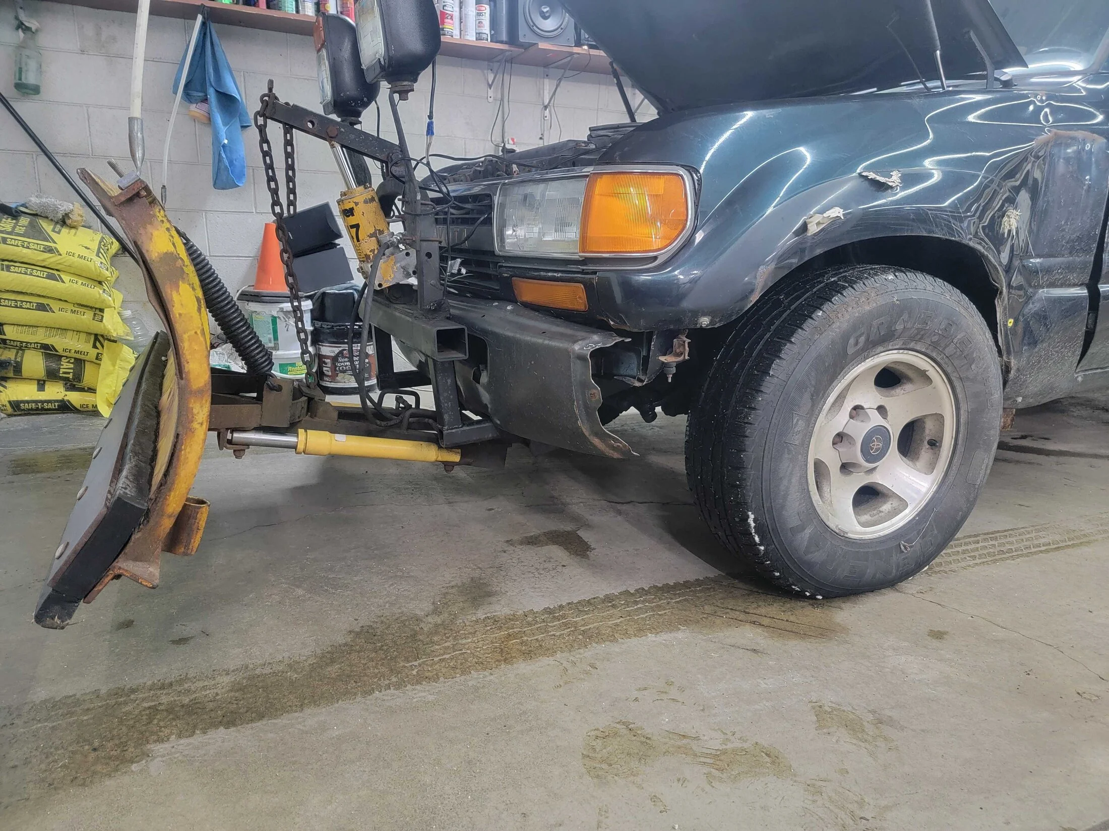

So, both sides are on the bump stops I think because of the weight of the plow alone. I don't think stock height springs are going to work, even if they are new or newer. Drive side is a little better condition, you can see the passenger side collapsing.
I will need something with a couple of extra inches just to account for the weight. I emailed Cruiser Outfitters - awaiting a reply.

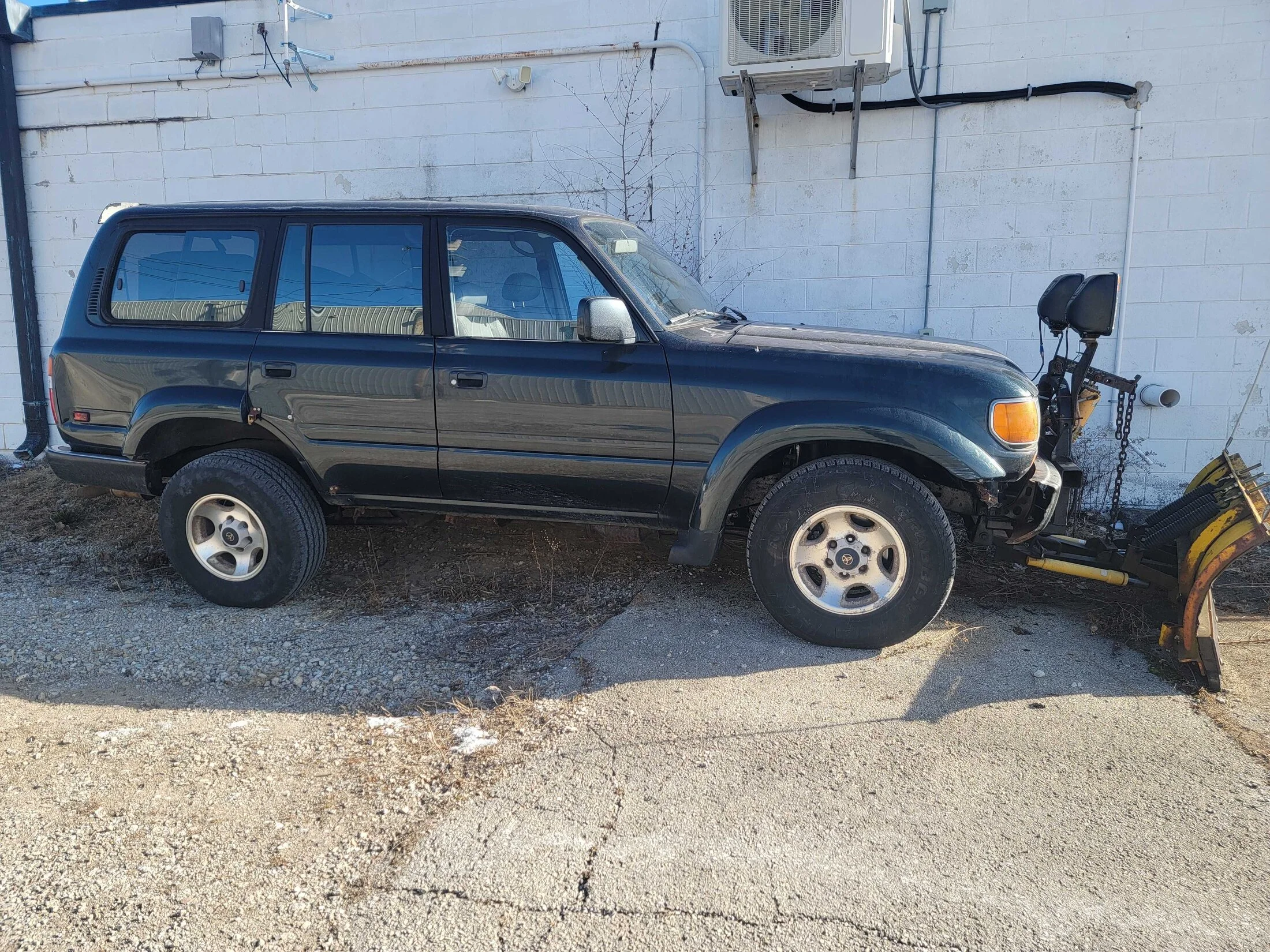

Plow Down
Distance from ground to front fender 33"
Distance from ground to rear fender 35"
Plow Up
Distance from ground to front fender 32.5"
Distance from ground to rear fender 35.5"
