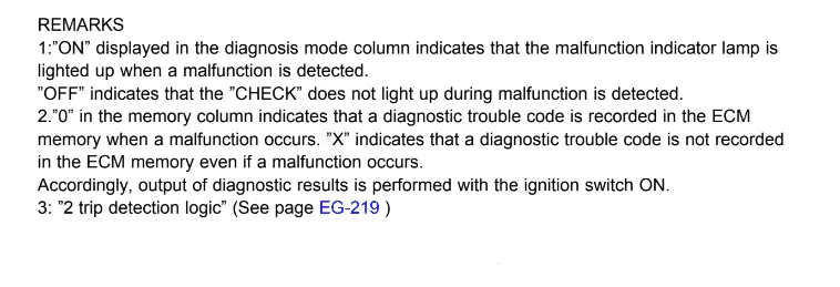

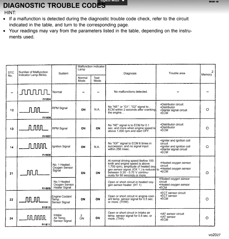

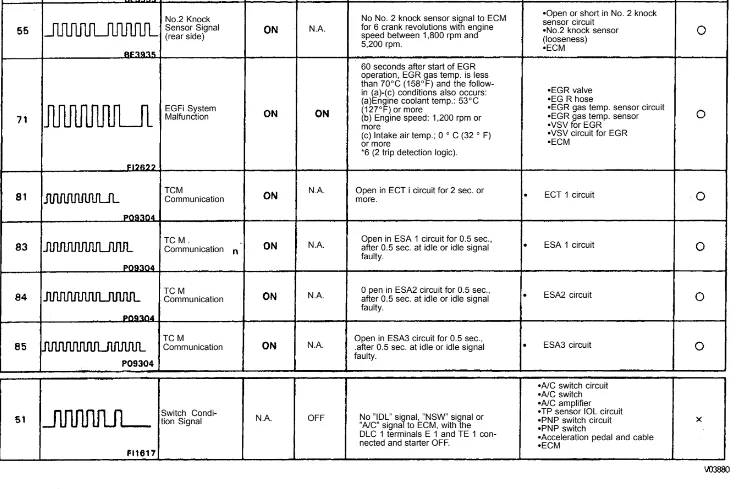

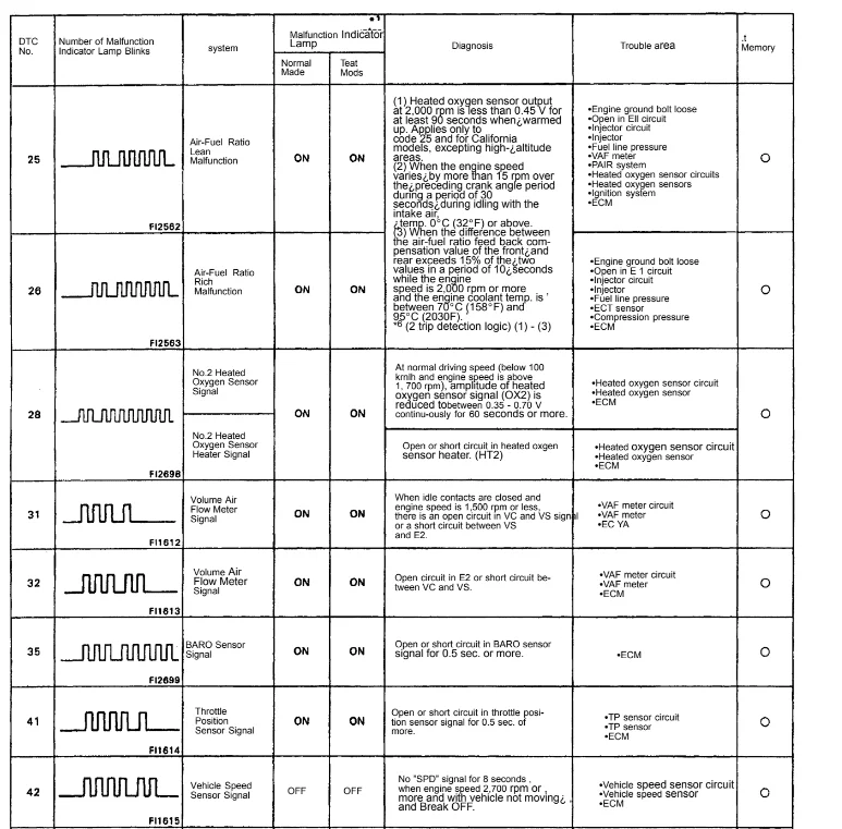

List of codes from the 1994 FSM:

You guys I really appreciate these responses. I was able to get a clear 26 code read.
Where do I go from here?
On my 94 it would throw 25 and 26, lean and rich, being that my o2s were 17 years old I replaced them. You can get the set from Toyota these are different then 95 and up. I would recommend getting the set from Toyota or you may start chasing the same problem with using aftermarket autozone ones. The Toyota for 94 were NTK . Both these codes affected my idle also

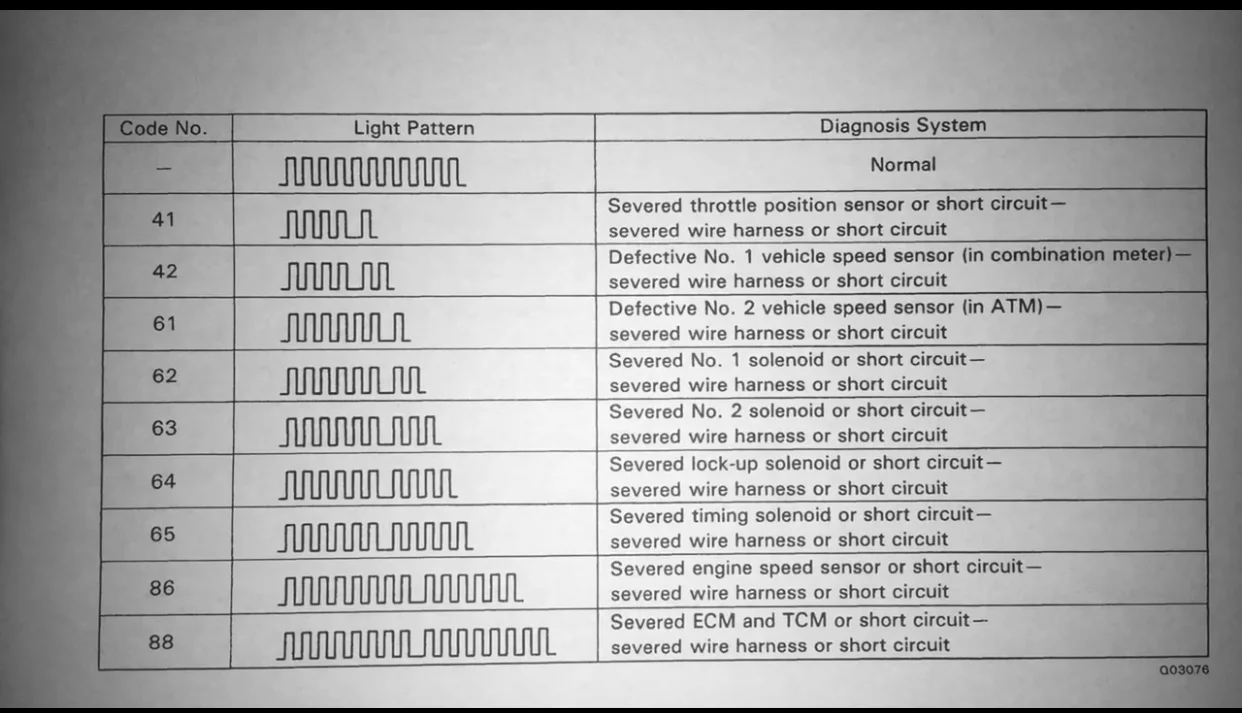

So here’s a head scratcher. The CEL on my 94 has been turning on after 10/15 minutes of driving and then goes away. I jumped the two ports to check what the code is and I got nothing. The only thing that was blinking was the OD light on the dash. Anyone else seen this before? :hmm:
The OD light flashing indicates a fault code with the transmission. Check the FSM as there is a procedure for retrieving the error code similar to code retrieval on the engine.
