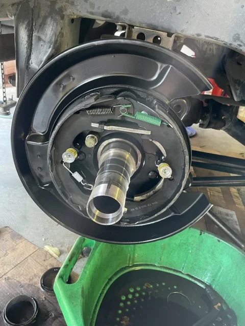

Been working on the rear brakes, bearings and seals. Did a full refresh. Little spray paint goes a long way.
Was in pretty good shape honestly, hub was full of gear oil, no grease, but the bearings have been changed at least once, since they were USA made. I ordered the re-built kits before I took it all apart so went away and replaced bearings, seals, parking brake pads and parking brake hardware kit. Autozone has an inexpensive parking brake spring and clip kit. It only has 2 springs for the parking brake lever arm, you need 4. So I reused one spring, gave a it a shot of spray paint looks brand new!
Got the rear axles, hubs, bearings, parking brakes all done. Waiting on the tool to torque the axle nut to show from Amazon. It was cheap enough to just get it. Laying out the suspension parts, going to do the rear while it’s opened up. Got new o Reilly rear rotors and brake pads. New OEM Toyota calipers and hoses from McGeorge Toyota.

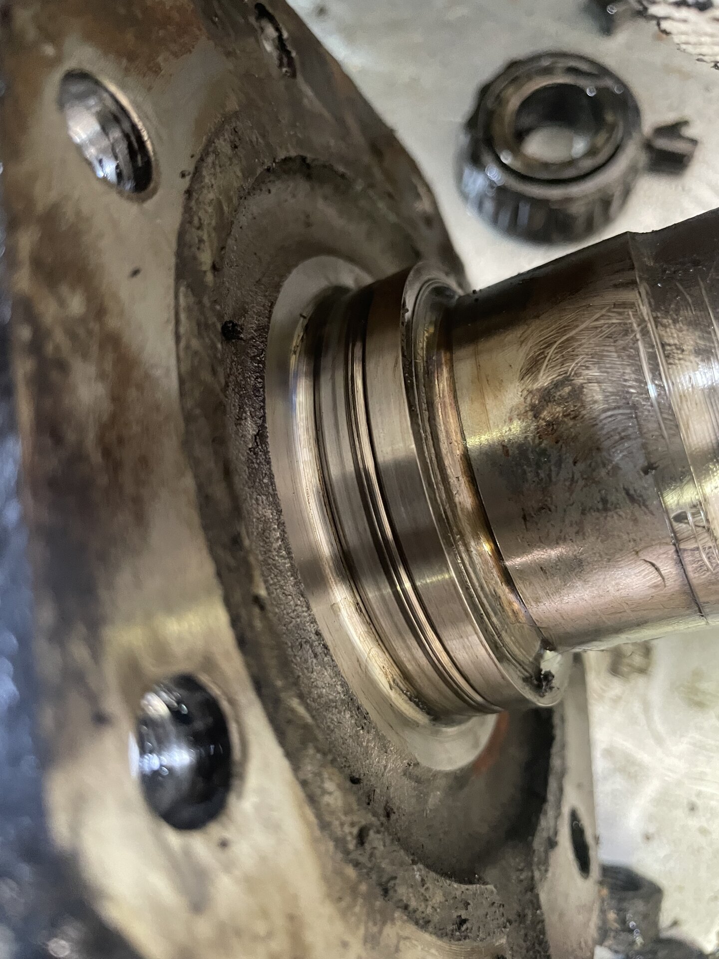

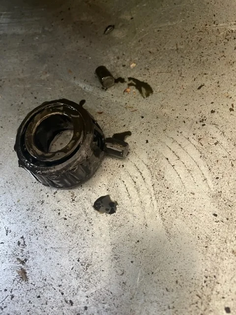

That spindle is beyond done.
Trunion bearings should be replaced between 60,000 and 90,000 miles. They take an enormous amount of punishment. Especially the lower ones.
Thanks for info! Will do. I got the complete kit from cruiser parts. Have to get some spindles. Probably get new hub retaining plate as well. Already got new birfs with my kit. Thanks.
