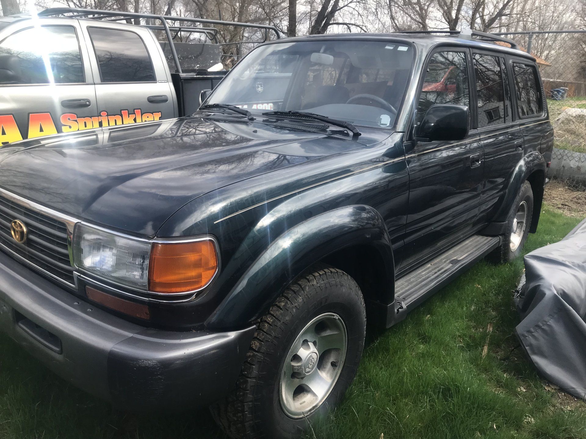

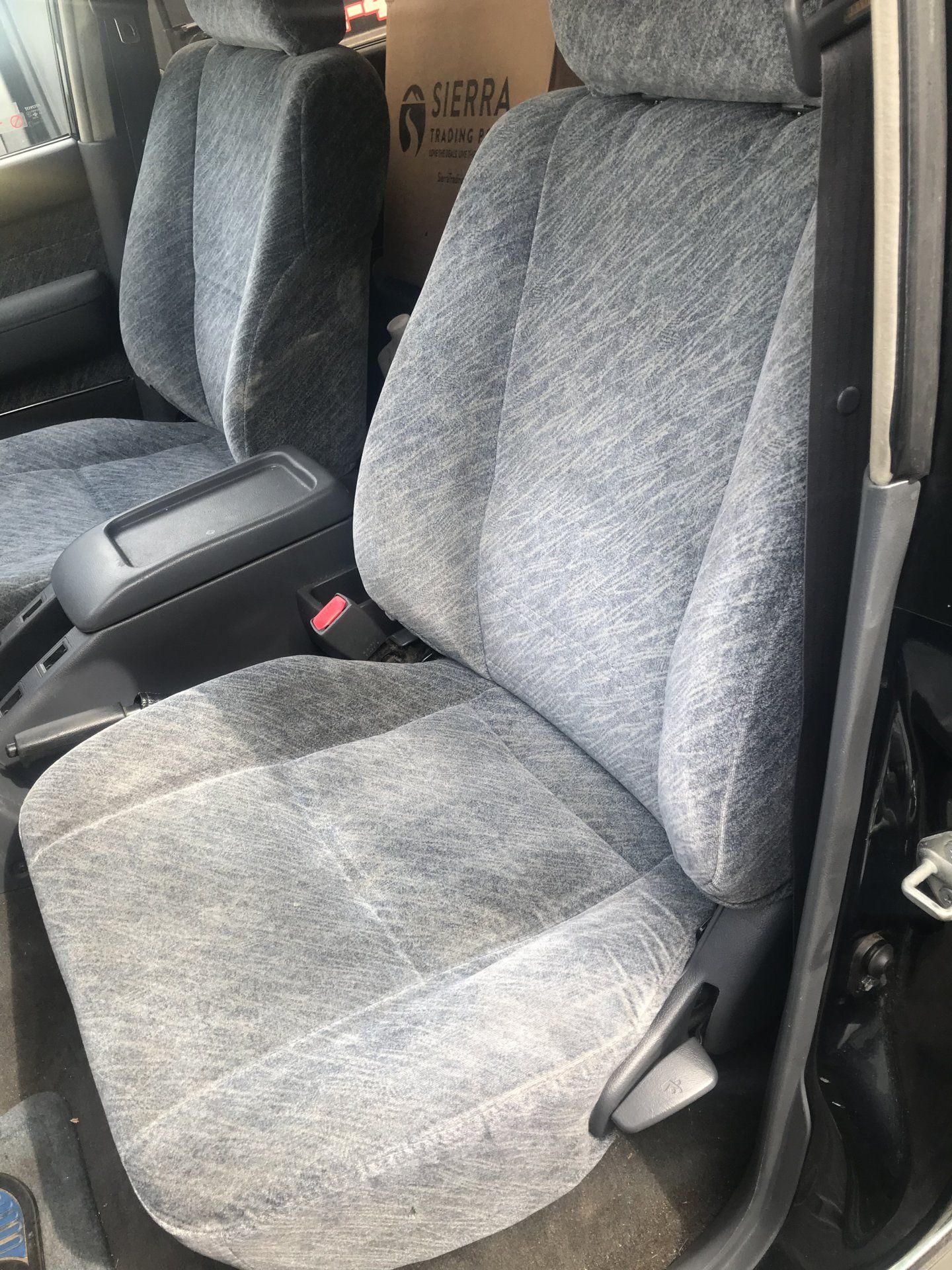

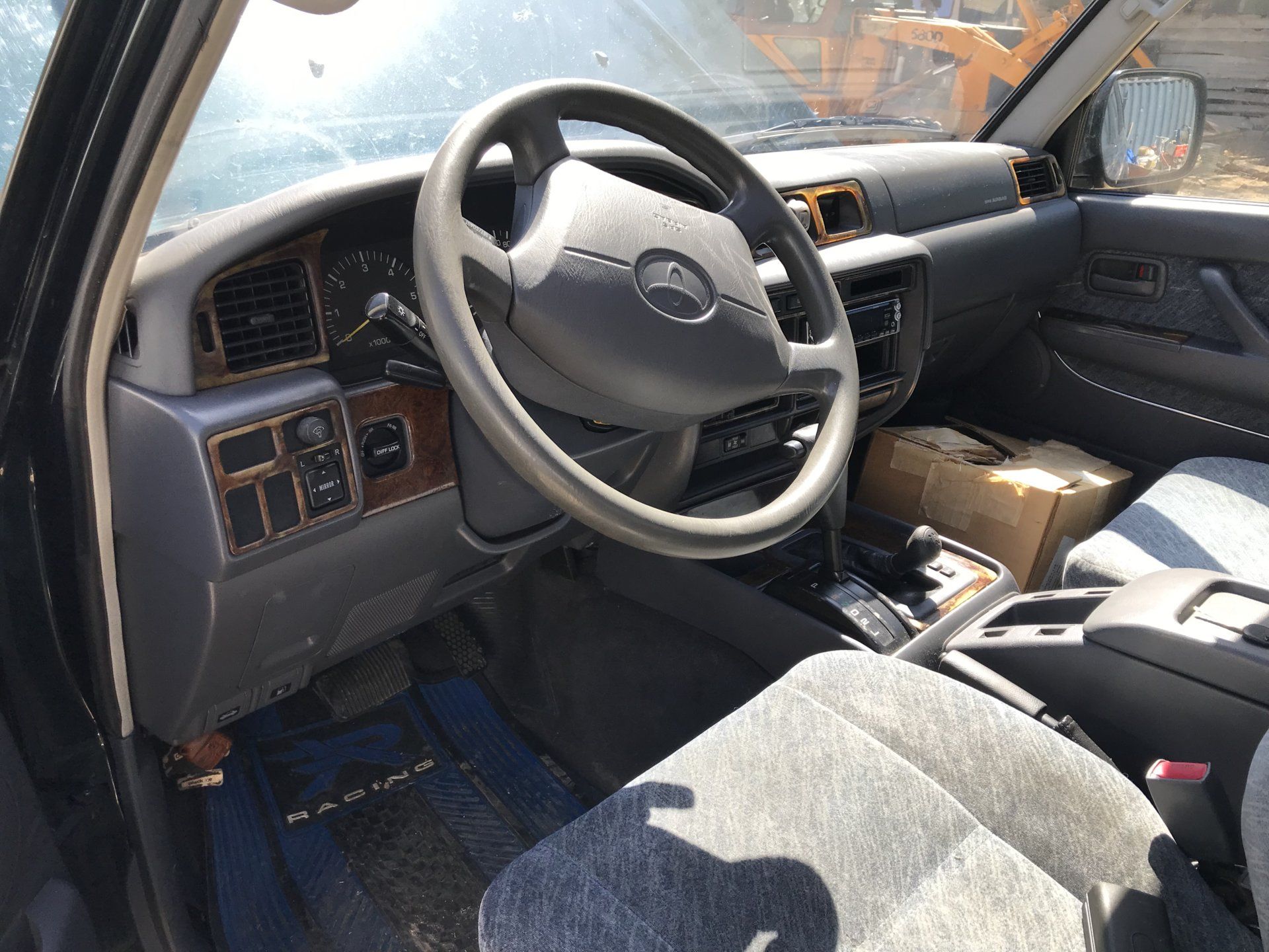

So I ended up with this 95. Didn’t really want it but ended up with it anyways. It has a bad engine but otherwise is really nice.
Not sure what I am going to do yet but I don’t really want two money pit Cruisers. I am mulling over a few different options. I do need an 80 chassis for a clients build so that is probably going to be one of these two Cruises I own now.

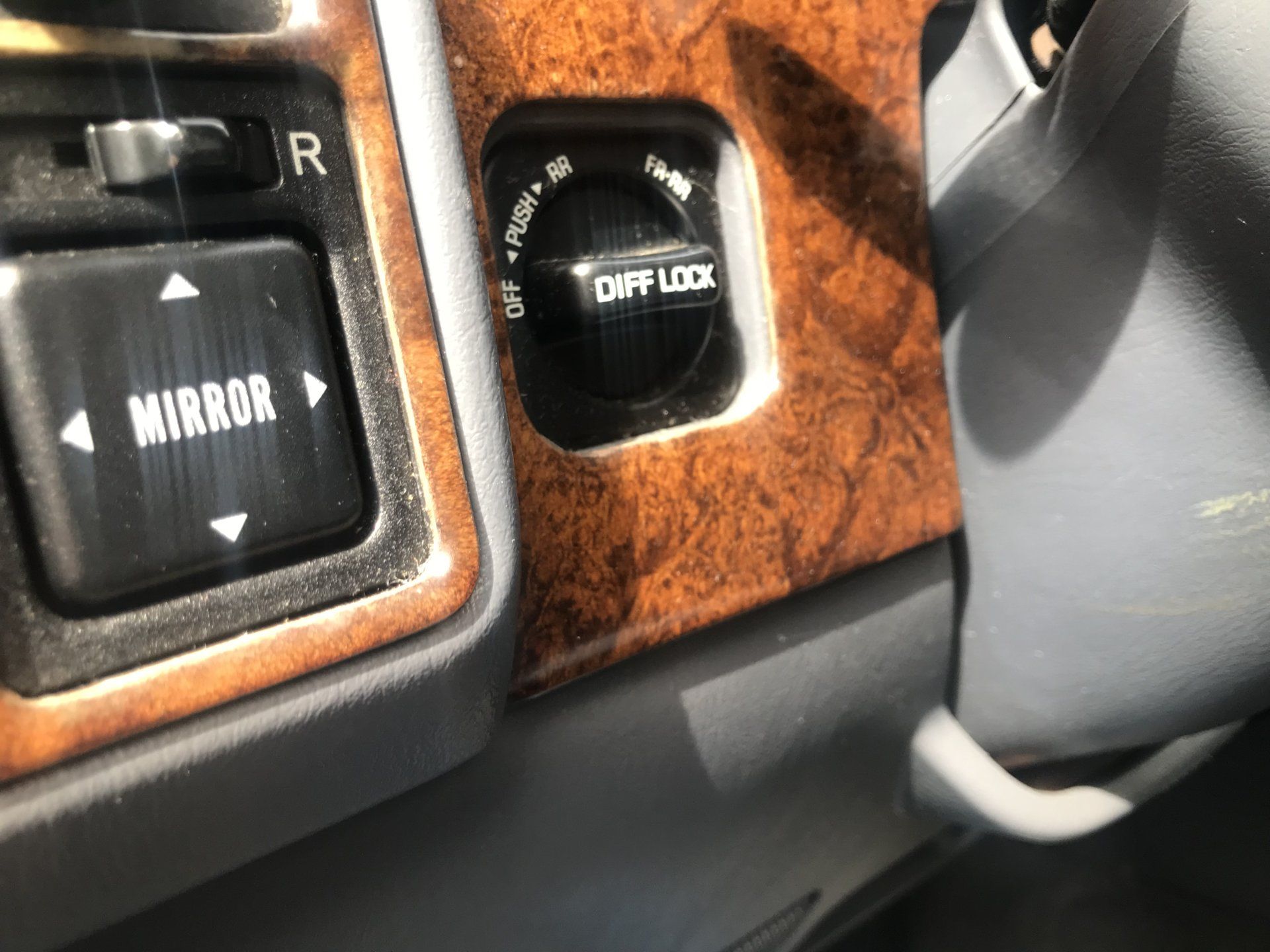

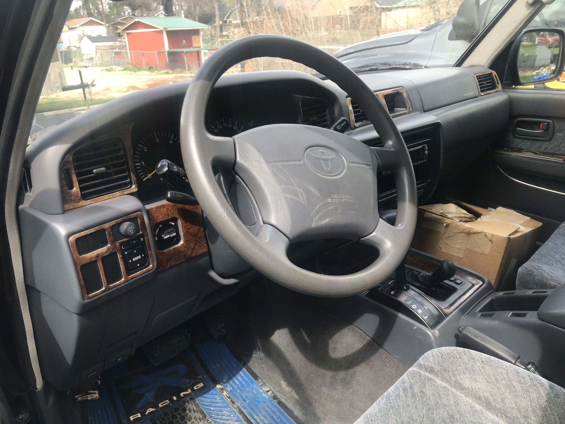

Cloth guts and lockers is quite an unusual combination.

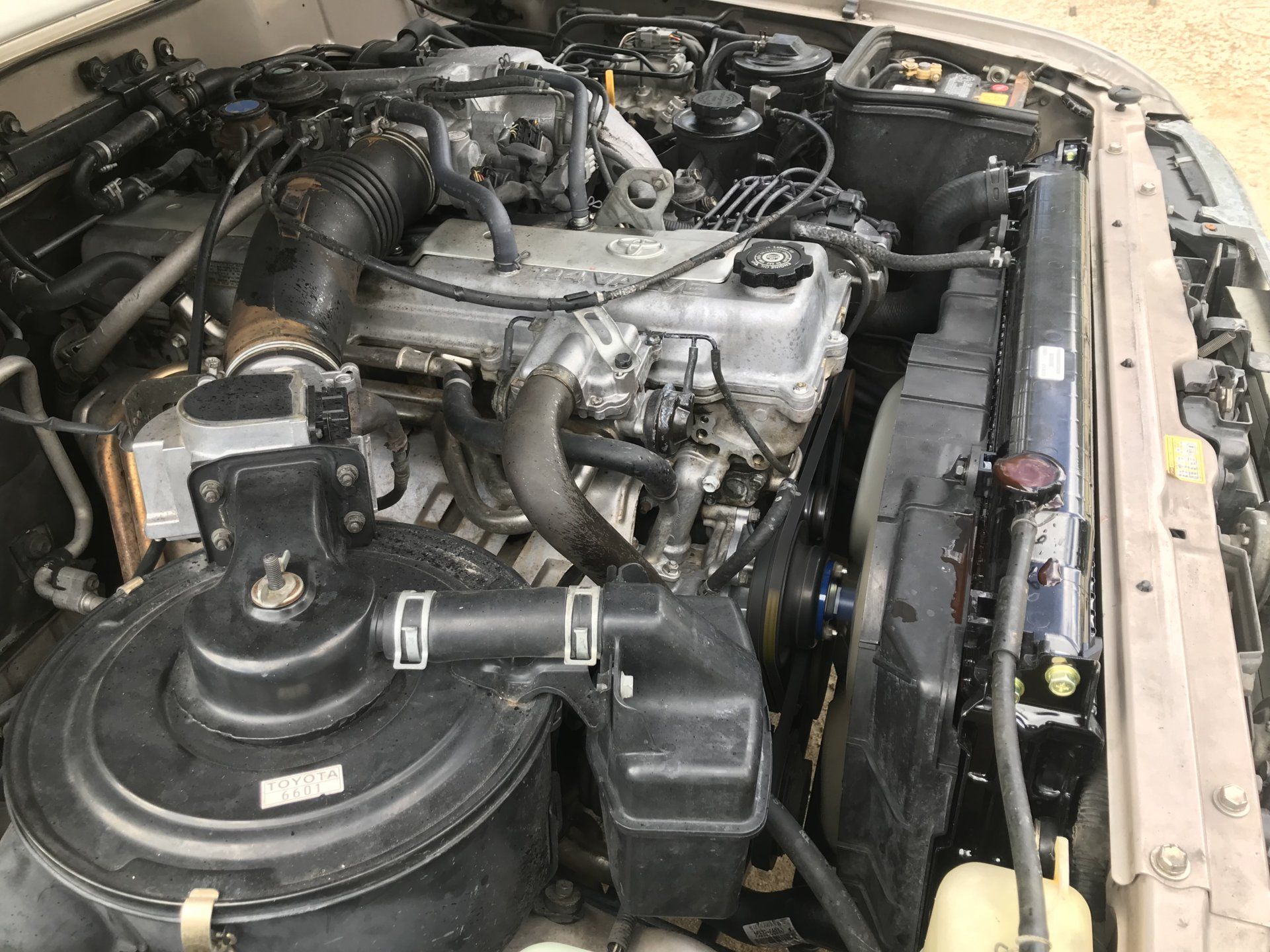

Gold emblems too and I know. I am considering swapping the engine from my 93 over. The 95 is a better truck but the 93 is OBD1. Haven’t explored what’s involved yet or how much is involved. I guess swap the harness and related ECU’s at the same time.
There is also an H151 sitting here at my place suited for the 1FZ. New trans assembly I may be able to acquire.
Ho-hum....what to do!
Cheers
You can't swap the electrical. To put an early motor in a later truck you need to move the crank position sensor components to the old motor as well as the throttle body and EGR temp sensor.

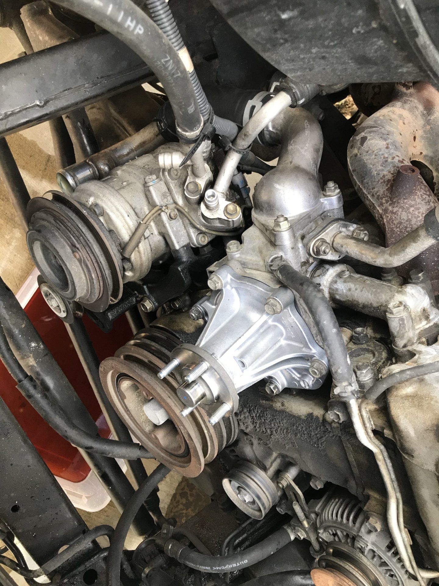

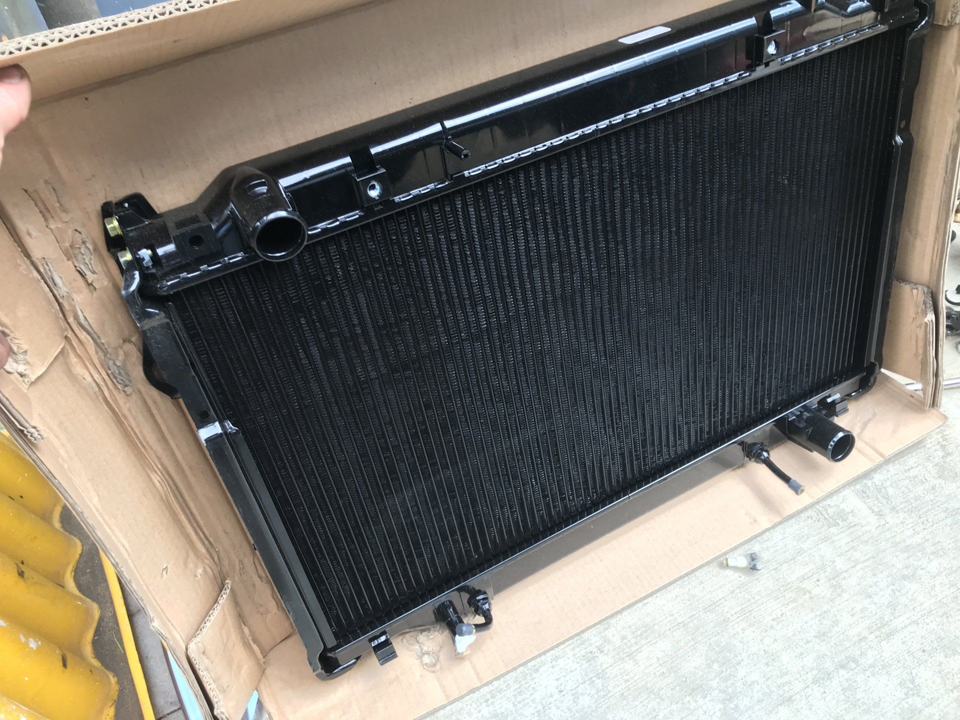

Gave my 80 some love yesterday, as you can see the old radiator was about to blow at any time.
I installed a new Denso rad, water pump, upper & lower rad hoses, belts, thermostat, plugs, wires, cap, rotor and a new fan clutch.
It’s running great, going to take it on it’s first good road trip this weekend since I bought it.

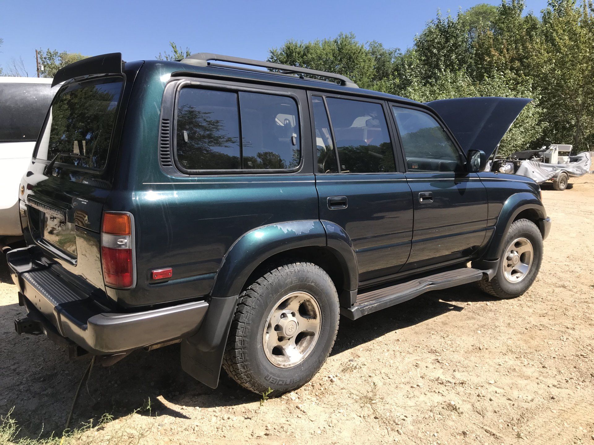

I am moving the engine over to the green 95 pictured. It’s the better Cruiser so why not!?
Cheers
Nah, it’s all stock.
Cheers
Besides the locked axles, what’s better about it?! It’s green for Christ’s sake! (Sorry Dan)
Better condition. Interior and paint is a lot better. I like the green! My best friend (who is now gone) bought a new 80 in 1994, it was green and I was with him that day.

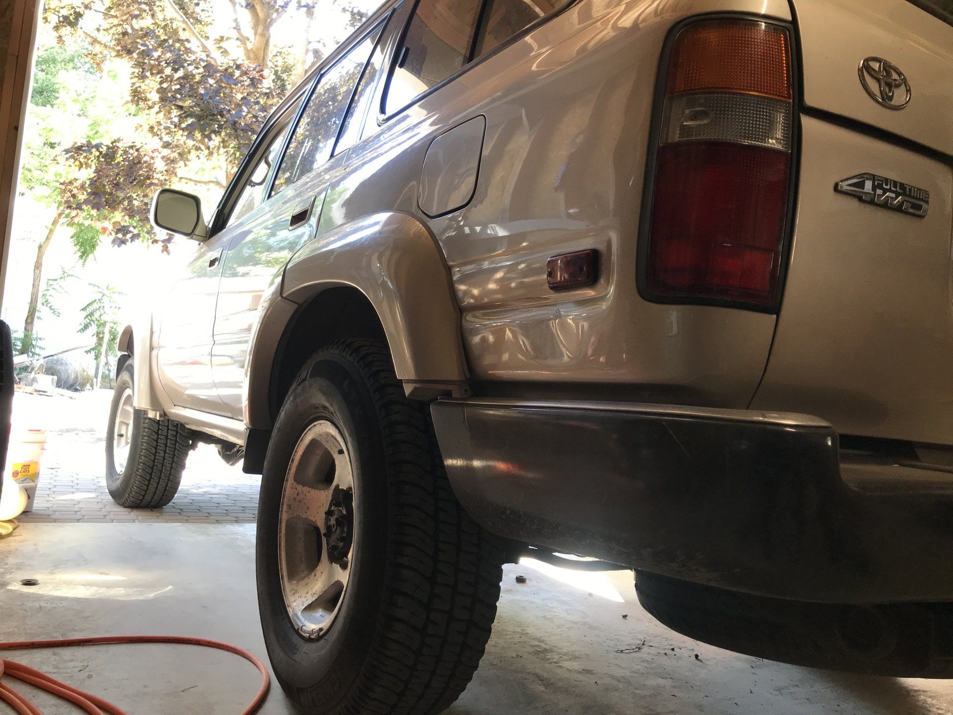

Just lifted the 93 yesterday, tossed in an OME medium kit.
It needed it badly, only had about an inch of up travel to the bump stops on the original springs and shocks.

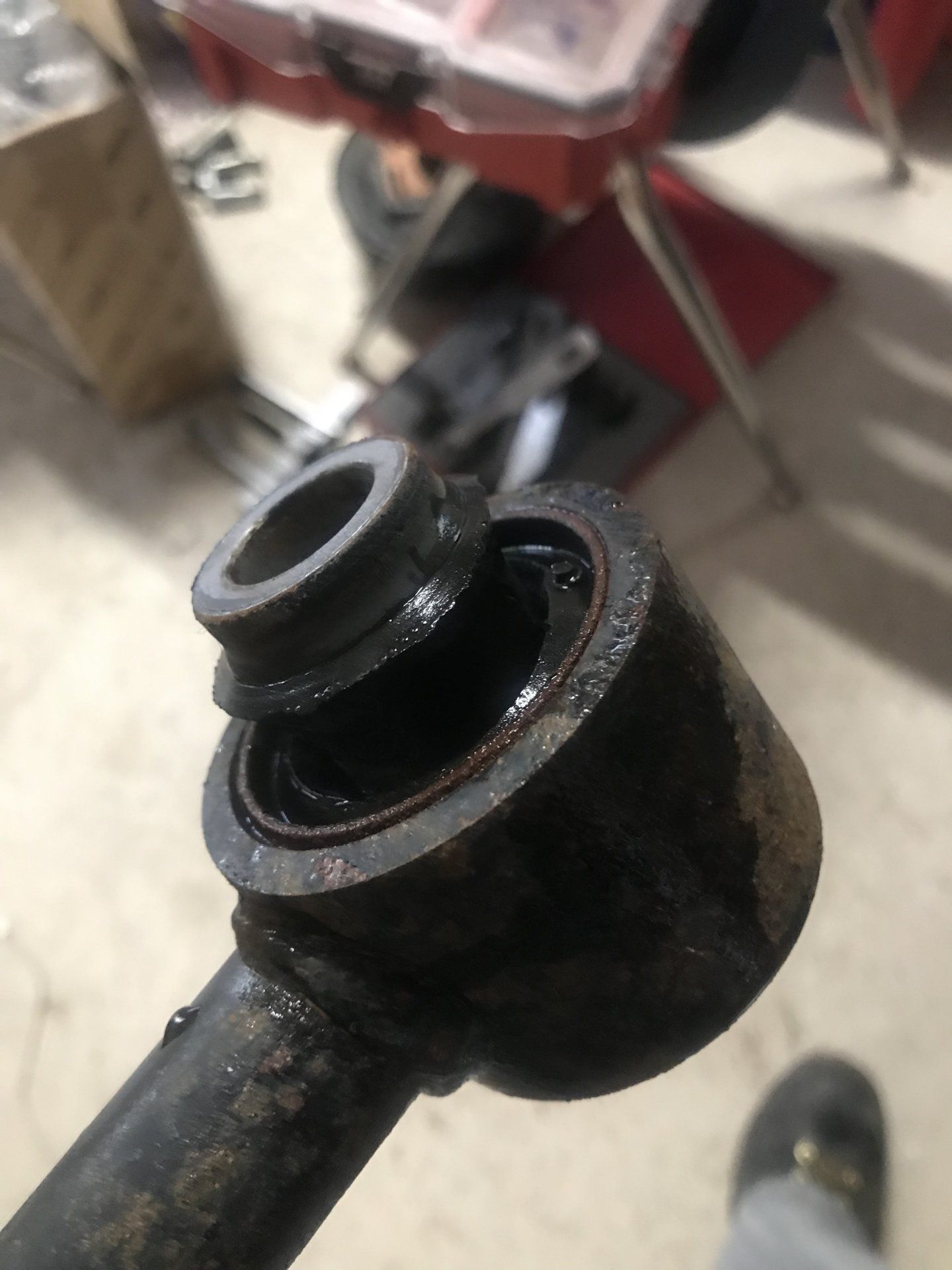

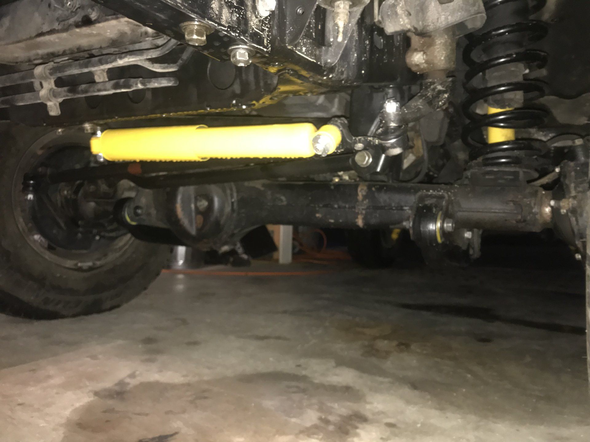

Ton of work done on the 93 Cruiser recently.
-new p/s pump, high pressure line and low pressure lines, new reservoir as well.
-new booster & master
-new coil
-cleaned TB & intake. EGR system was clogged, all good now.
-had some powder coated radius arms laying around so tossed some OME caster bushings in and installed the arms.
-new bushings in the entire suspension. Sway bars rebuilt too. New hardware throughout the suspension.
-new tre’s.
-Blackhawk adjustable rear panhard.
-SLEE belly skid.
-Metaltech sliders.
-replaced ALL vacuum lines on engine.
-new fuel filter and screen in tank. New sending unit as well.
-new stuffing on drivers seat bottom.
-new steering wheel.
-powder coating stock wheels a gun metalish color. 315 Geolander M/Ts as well.
-pretty much every single hose in the engine bay is new now, every one was hard as a rock and needed it.
-dizzy o-ring and timed it while I was at it.
I think that is most of it. Headed to Moab in a week so wanted to give the Cruiser some love before I ask it to do my bidding! :)
