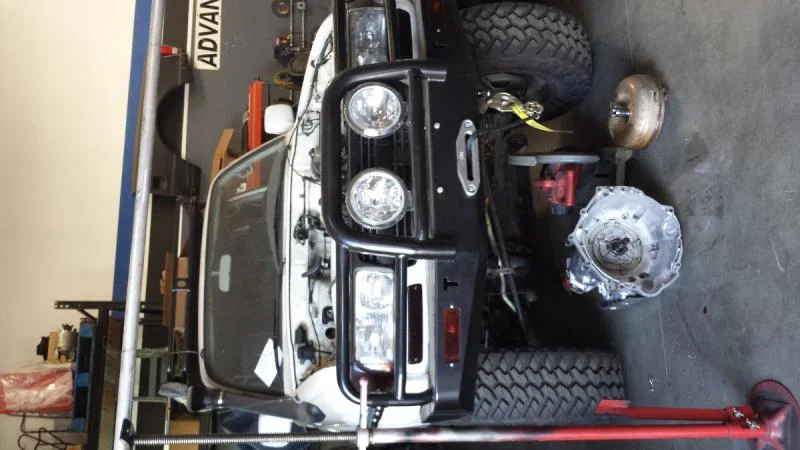

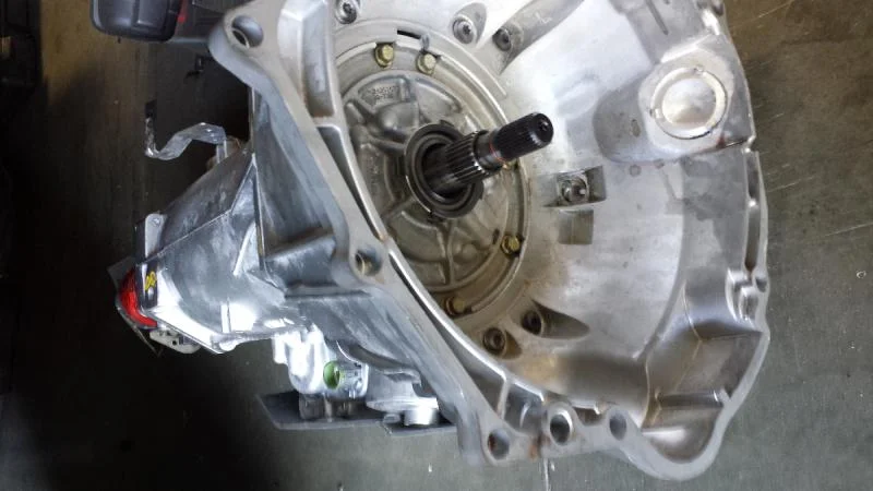

So we figured out that the transmission that we purchased a while back was a 4X4 and not a 2WD like we need for the swap...
Now we're taking it apart to swap it with the correct one.
Surprises all the way to this point, but after this we think that things should go smoothly.
More updates in the next few days...
We are waiting on American Dismantling to find a low mileage 2wd transmission... :bang:
This sucks! Stuck until after this holiday... Hopefully we get it soon so we can get back to it...

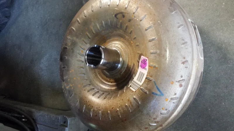

Well.... I finally bought a new transmission... is out of a 2005 Avalanche with 42k miles.
It is finally at the shop and now is ready to put it together...
I'm also getting the cat converters and 02 sensors to make it smog legal..

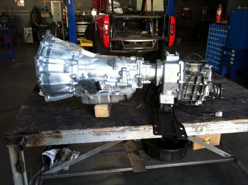

The transmission is attached to the adapter and the adapter to the transfer case... it finally looks good and it is the proper fitment.
The guys at the shop are going to mount it and weld the new motor mounts.
We also have the radiator and headers ready for install... the radiator will require custom mounts that will be available for sale as a kit for 80 series LC's by Steel Nutz...
More to come soon ;)
Interesting placement of the 4L shifter base on that adapter.
