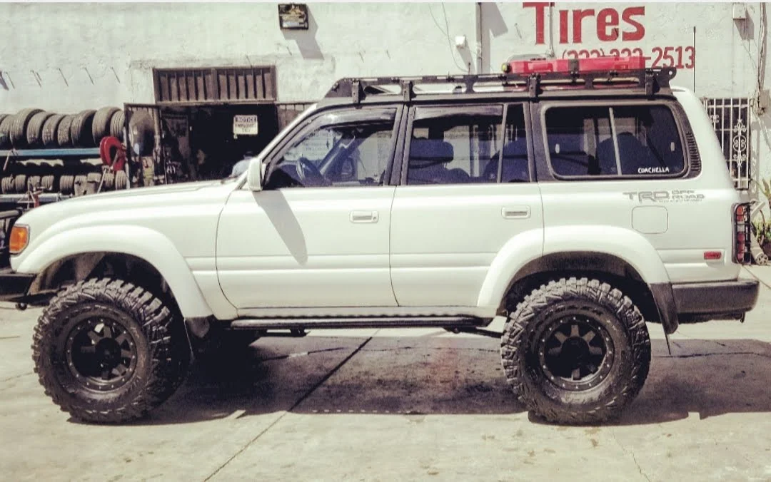

Below is a pic of my rig on 35s. it has a winch/arb bumper, sliders, Icon 2.0 3" lift with no rear bumper and a roof rack. I did have a Landtank caster plate for added caster when the lift was installed and i would strongly suggest adding that to your OME lift. and avoid using caster bushings...

Dude. That thing is badass. Yes I do plan on putting a rear bumper with tire carrier, and rooftop tent.
I would go OME heavy if that is the case.
