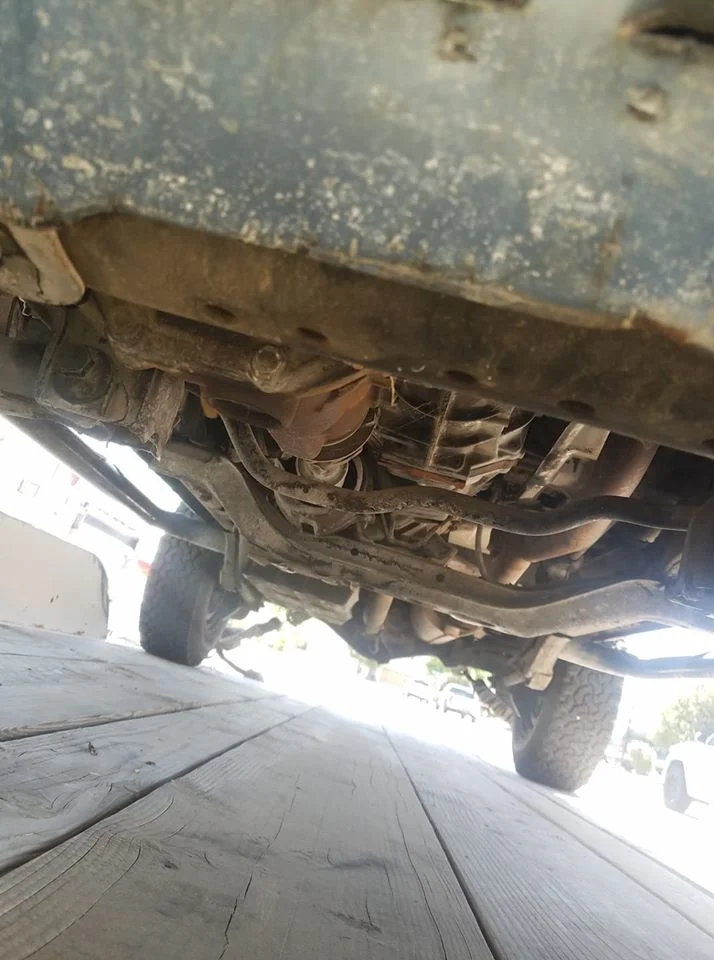

The truck is beautiful.. 151 original miles.. 1990 SR5 with the 3.0/5 speed. Timing belt, all hoses and the clutch was done at 120K. Interior was VERY clean with a small tear in the drivers seat plastic. Tires are 30x9.50x15 BFG KO's and essentially full tread (but being replaced shortly. It has AC that doesn't currently work, but the PPO said he used to add a can a year and it worked perfectly. Sooo who knows.

Nice. The SR5 trucks with the 3.0 came stock with 31x10.50s in 1990. Does it have the OE rear tire carrier? Big win for a $1 or $1000...perfect first car.
Maxxis RAZR 33.10.50 will look perfect.
Tire is under the bed of the truck. Did they have an optional bumper tire carrier?
