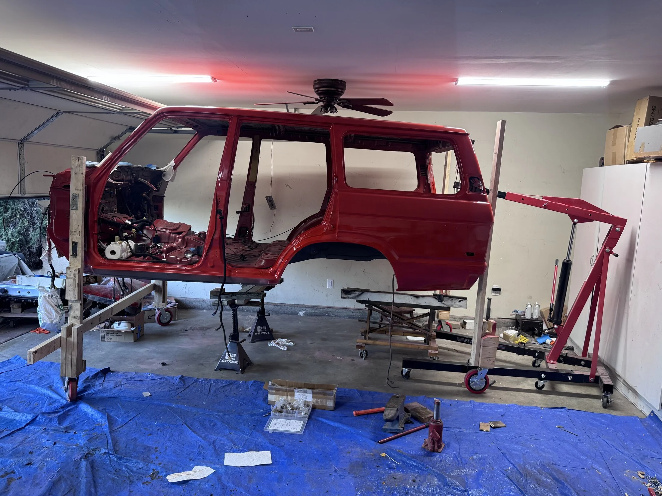

Arnak,

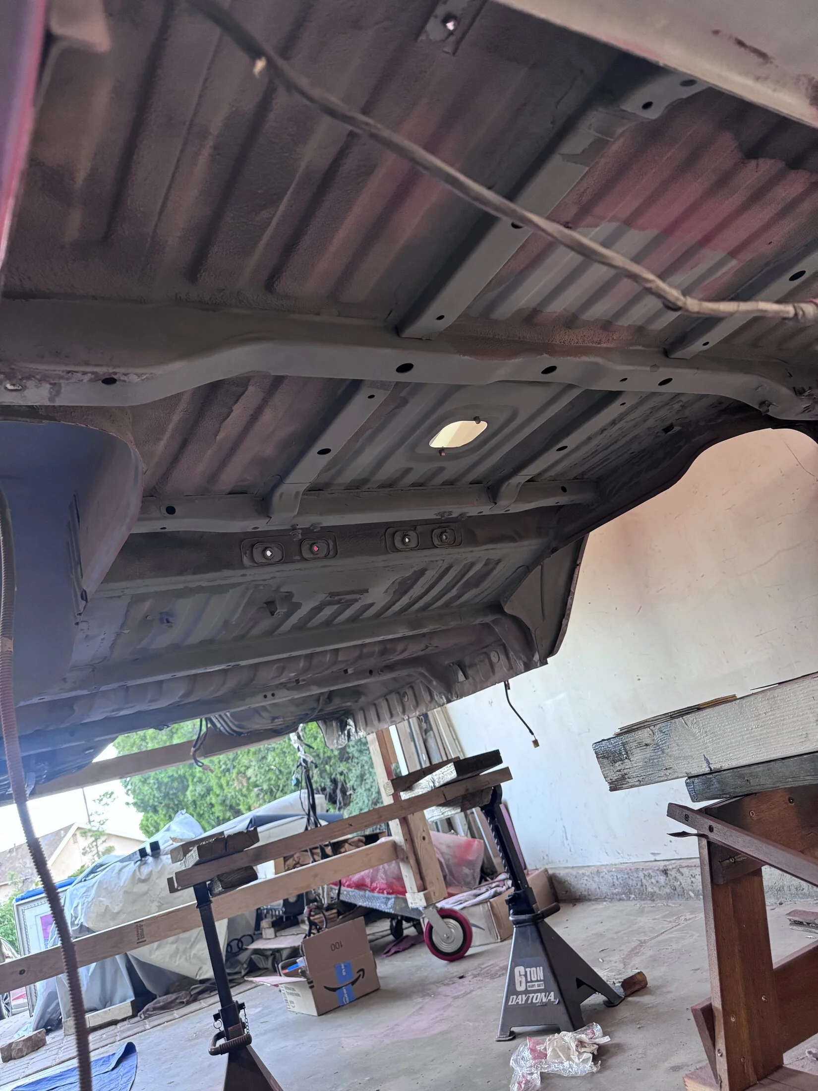

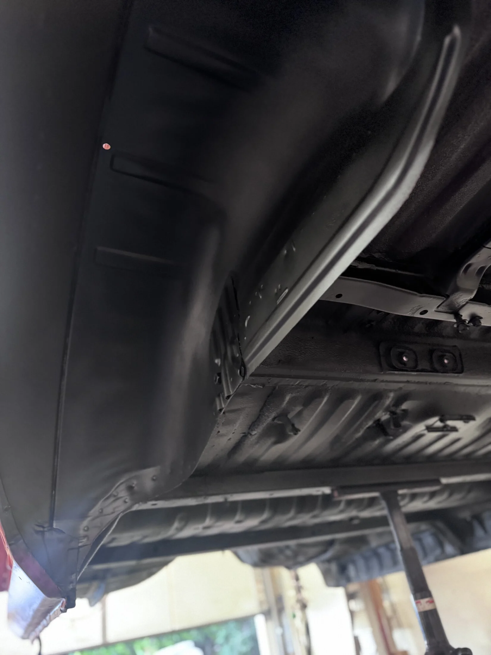

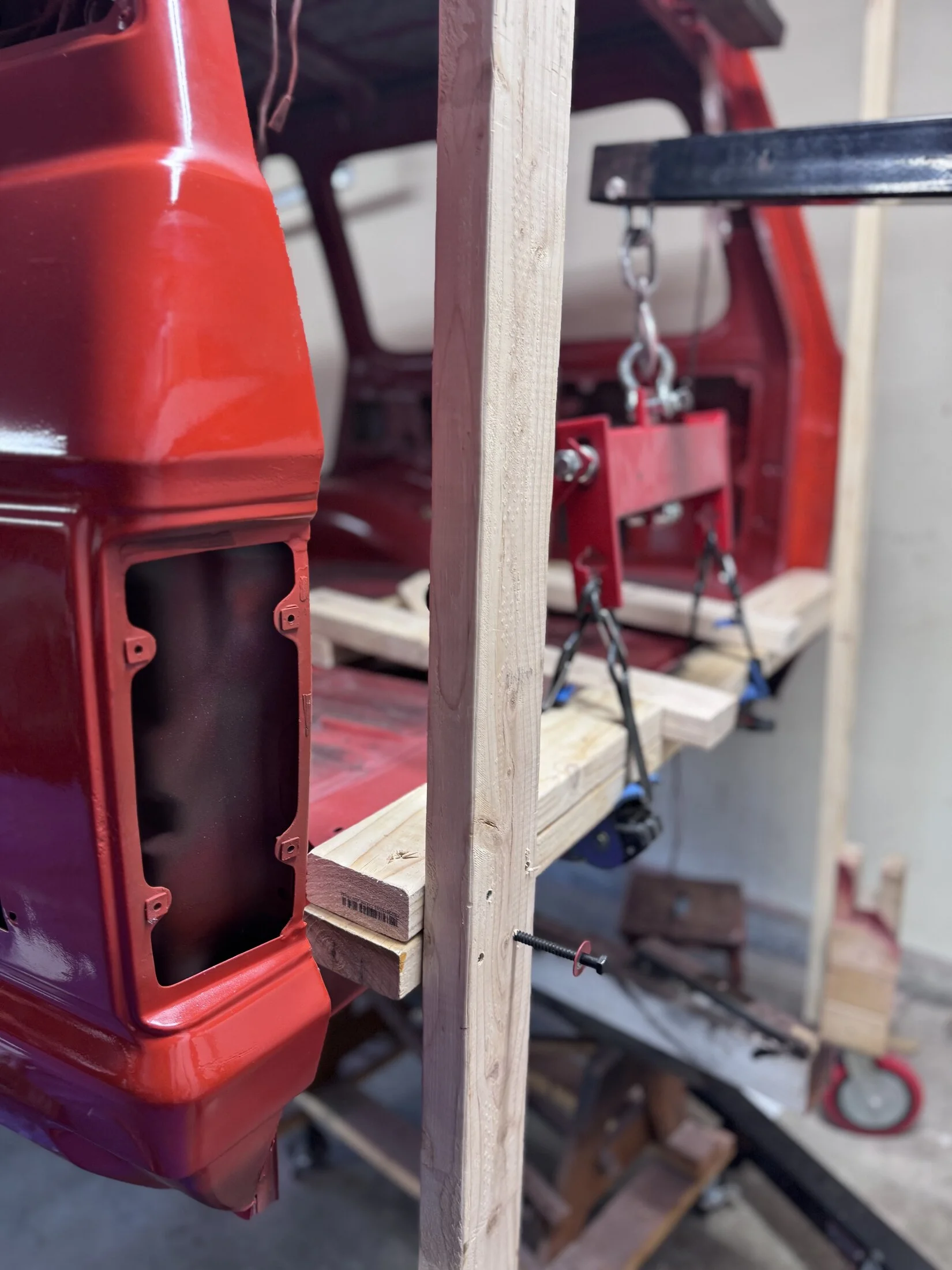

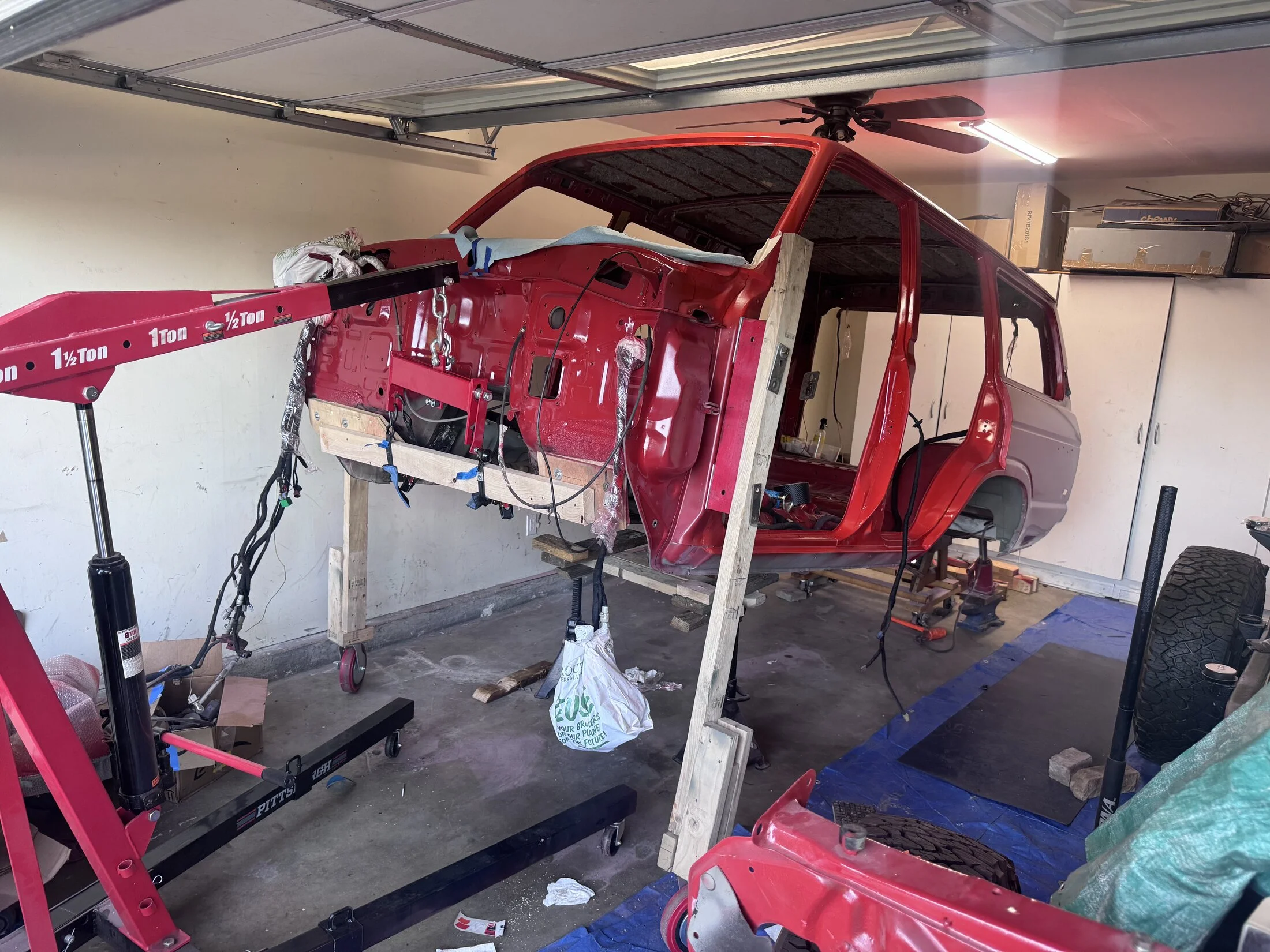

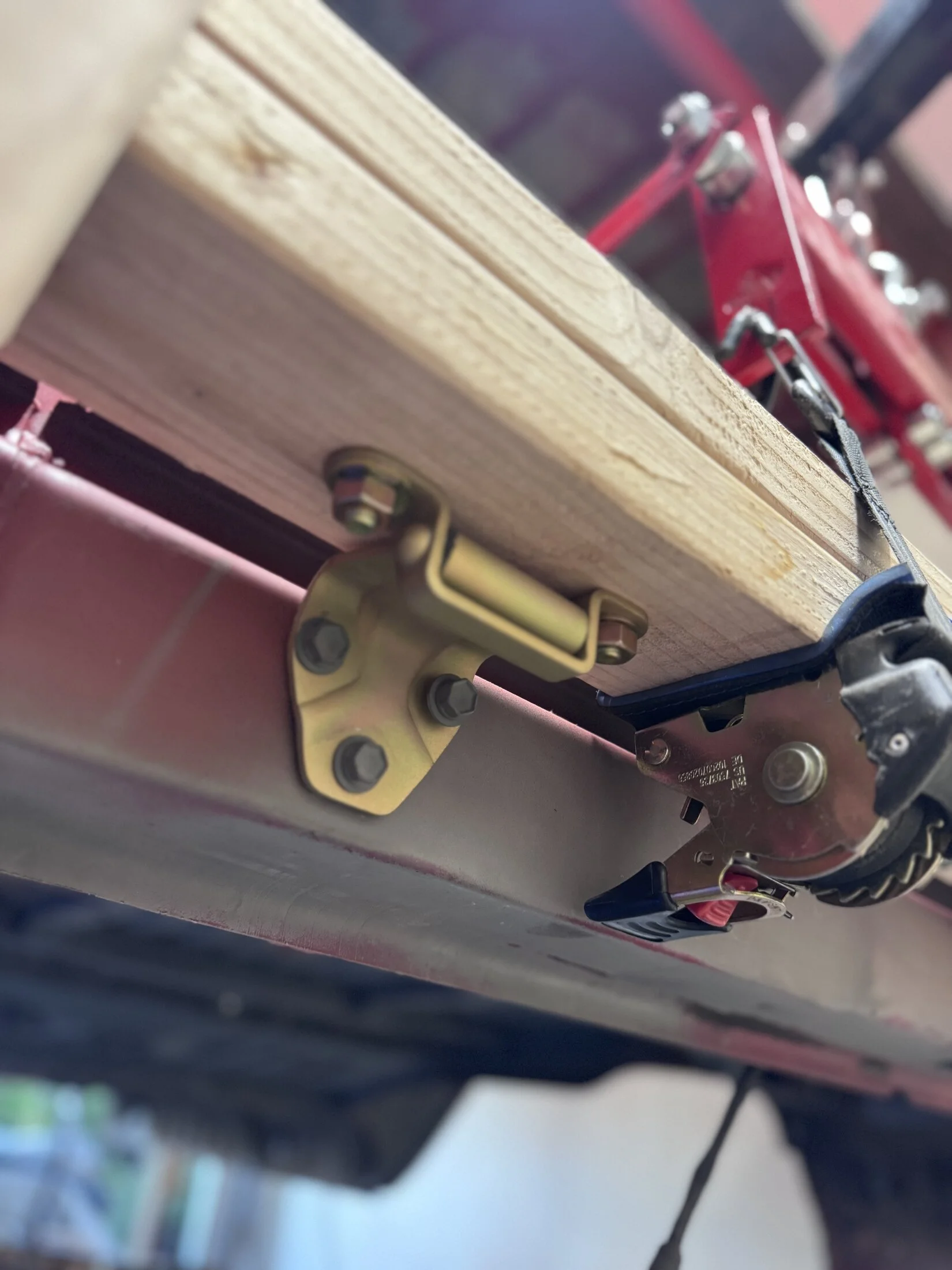

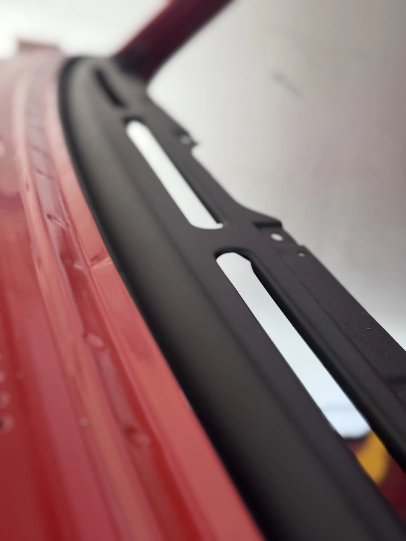

It’s only sketchy as f***, unless it works. But please do not get under it without some backup support. The photos alone creep me out.

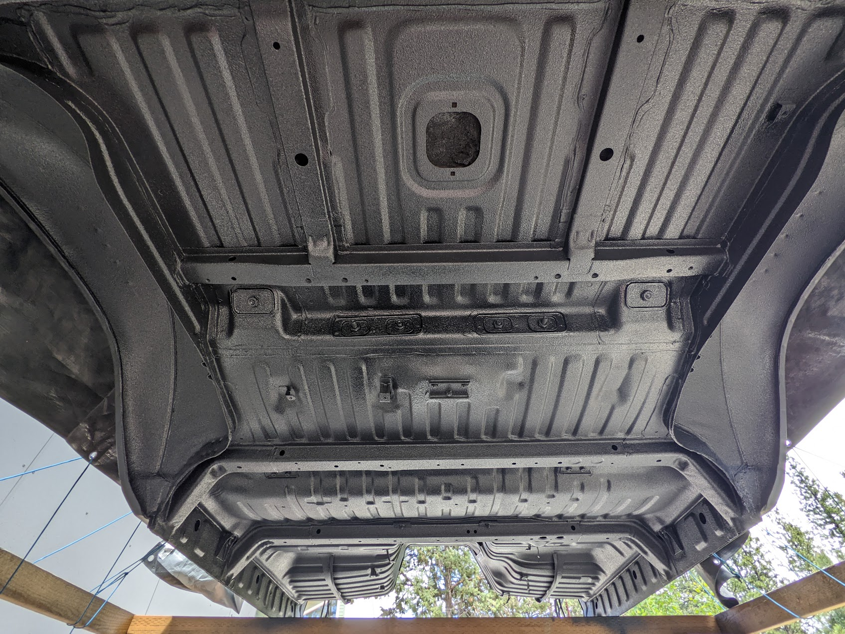

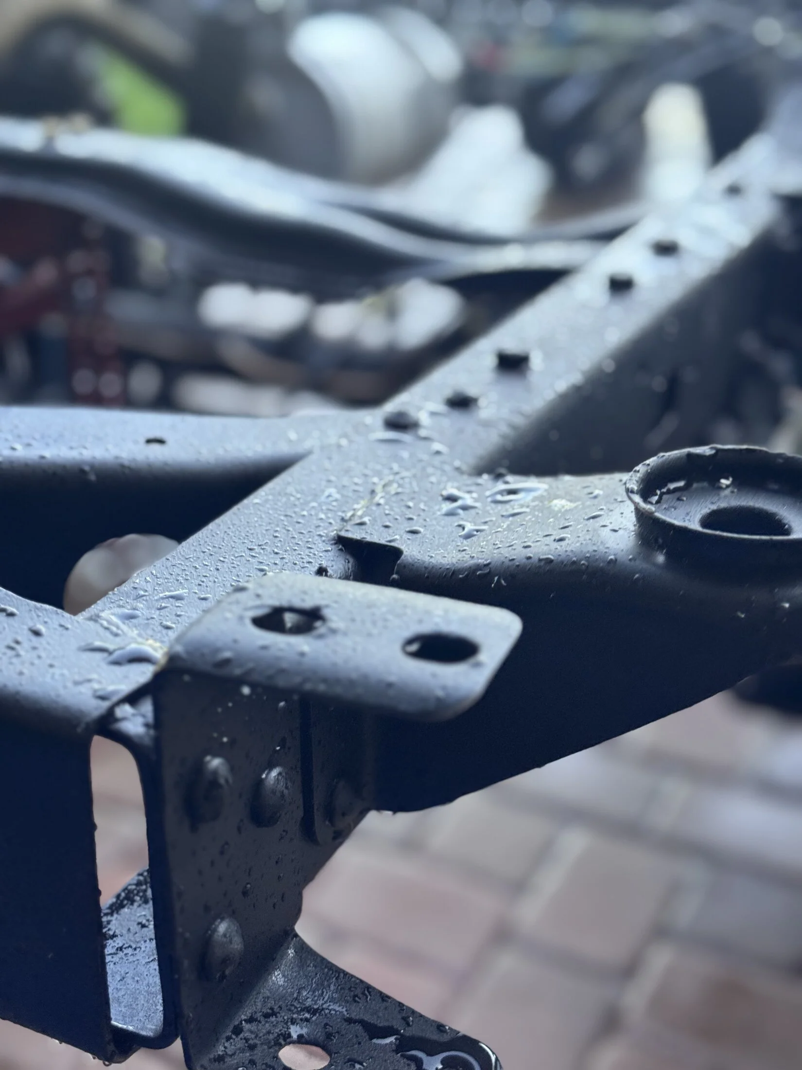

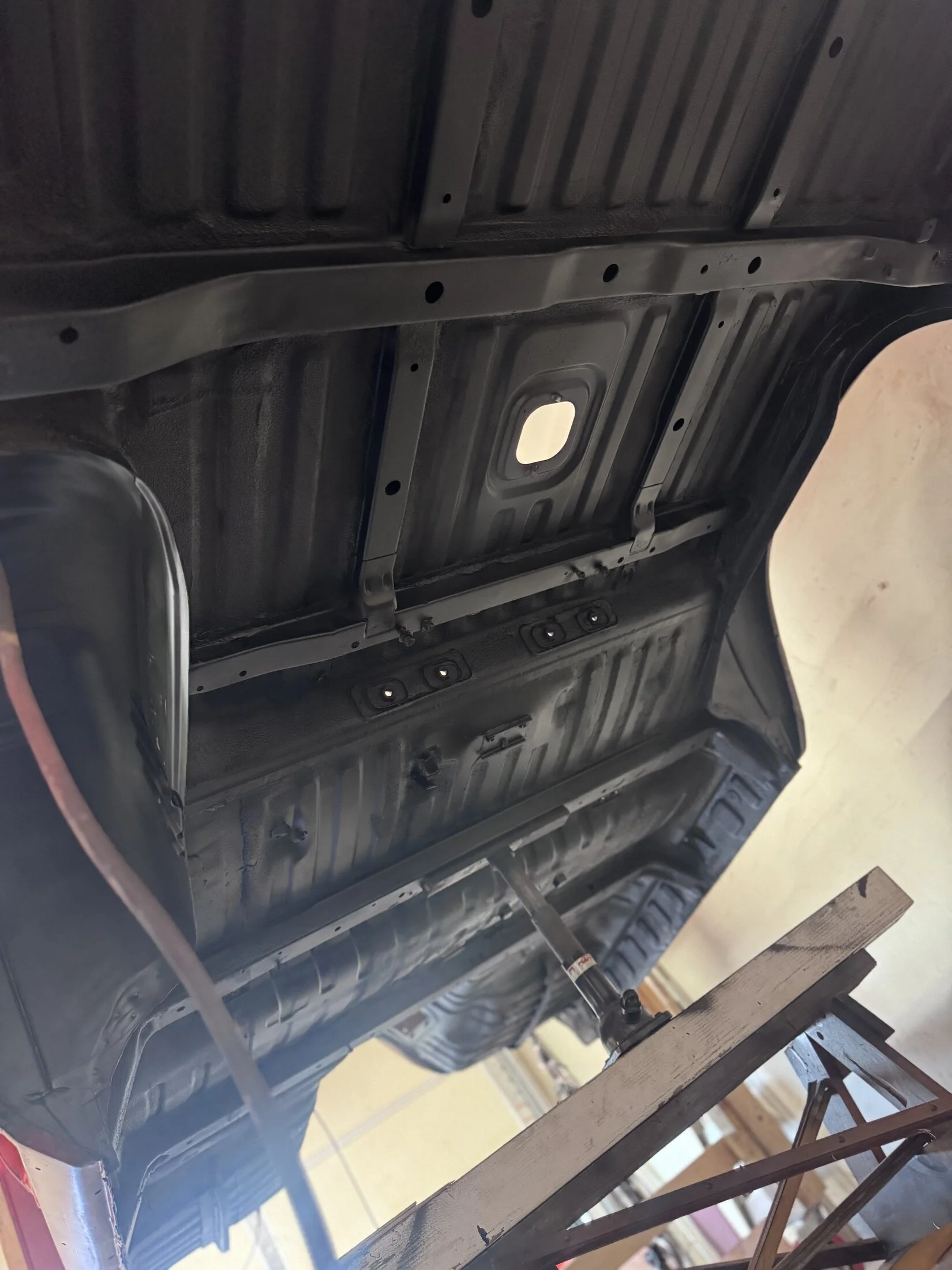

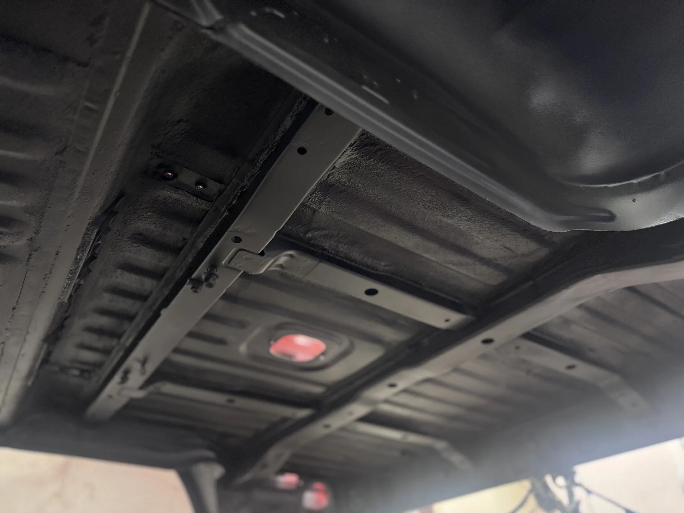

Does anyone know what’s the best thick rustproofing paint I can use underneath the body? It’s primered and undercoated so far Sherwin Williams just wanna use like a thick rubberized maybe rust proofing???
I coated mine with raptor liner after I stripped and primed the bottom side. It's held up well so far..
I didn't want to use anything rubberized for fear that moisture might get behind it and get trapped.
Interesting, how’s the sound proofing? I live in Los Angeles it’s dry here so I’m not too afraid of moisture, because it’s primered fully and then undercoated and then rubberized sealed also the rubber wicks off water really well, that’s what they use in New York for rust proofing it’s a weird texture it’s soft like foam it’s held up in Florida with multiple floods
I dont think its any/much worse than it was before I stripped off the factory coating. one day I have plans to repaint the upper side of the body and when I do that I'm expecting to strip the interior and coat the inside in a spray on sound deadener like lizard skin.
