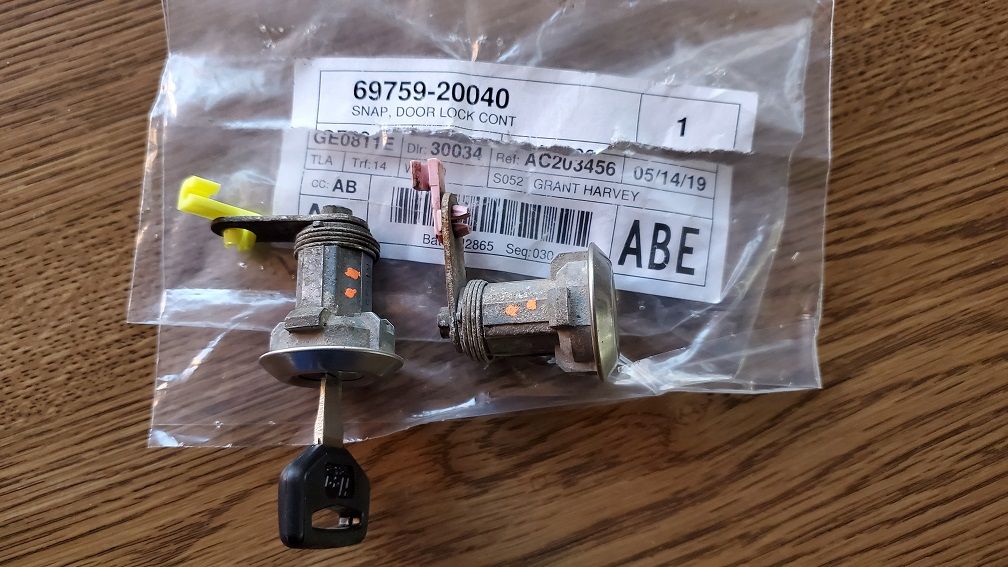

After this discussion, and discovering that those cylinders are NLA, I decided to harvest the cylinders from a truck at the boneyard. In the process I broke one of the clips. If you look at the parts microfiche for the lock stuff the little clip for the lock cylinder doesn't show up. Those plastic clips do show up for everything else.
I needed a key for these cylinders anyways so I talked with the parts manager. He looked up the cylinder and confirmed that the clip is part of the cylinder assembly, and not available separately ... but the cylinder is NLA. So he takes me to the back and we start going through the bins. Sure enough, there was a matching clip. Note that left and right matter, at least on the cylinders. But, functionally, I'm not sure it does.

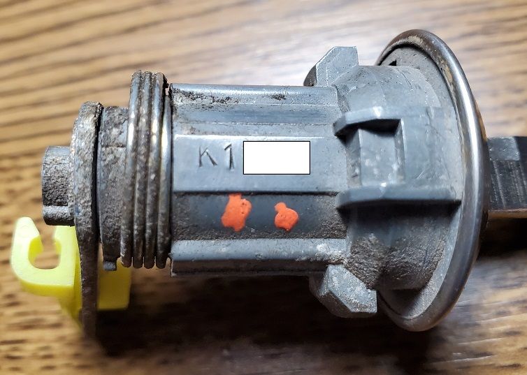

Also, I've mentioned this before, but it's worth repeating. If you drive old junk the key code is stamped on the passenger side cylinder. With that you can go to the dealer and have a key cut.
I will do a little homework later and see if I can track down what this clip went to (edit:donedeal). Doing so should give me the part number for the other side. Clearly since it does have it's own number another application will show it on the microfiche. In the mean time, enjoy the pic. The yellow clip is the new part. The pink was a clip that survived the harvest.

Hi Pappy, do you have a photograph of where the code is stamped on the cylinder?
You mentioned that "the key code is stamped on the passenger side cylinder". Is this to mean that it is always on the passenger side regardless of correct driving position?
Well, since I'm a Yankee, yes, passenger side. But you bring up a good point. So, for the international lurkers here ... right hand door lock cylinder. Let me see what I can do. The problem is if I take a picture of what I have, the world will have my key code, a bad thing. The code is on the side of the cylinder, opposite the pawl.
