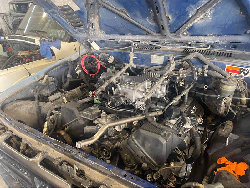

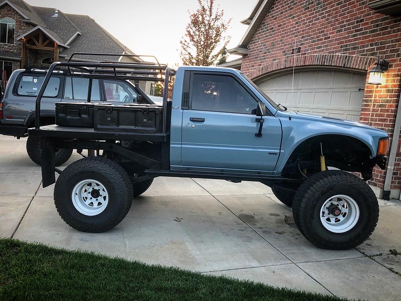

Here's the truck. The motor is in and mated to a A340F automatic from a 4Runner and a single 4.7 geared tcase. I just need to get the cooling system and fuel system sorted to finish it up. Some fuel system questions might get asked later on.
Don't judge too much here, this is just after getting the motor placed. It's much cleaner in there now.

Cool build so I'm going to follow along. What front fenders are you running? They're huge.

Fenders are Hanneman fiberglass. Not sure you can still get these, but the same style is also sold by ToyotaFiberglass.com and a couple others I think.

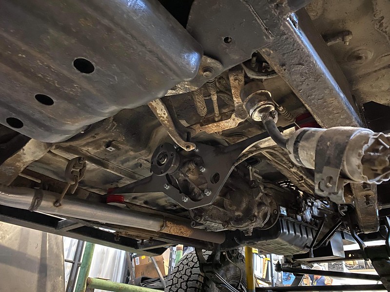

In my race car I used a Griffin Radiator with dual elec Spal fans and their shroud. plug and play. I used the correct size exhaust pipe to run the coolant from the front to the back, had exhaust shop bend the pipe but you could weld elbows together. Then use the proper silicone or rubber radiator hoses to connect it all. It takes a little while to bleed, may need a steam port on your engine?? Keeps my LS happy!
I have done a few rear mounted rads and I have found that putting a shrader valve on the four highest corners helps when it comes to bleeding the system out. I like using the jeep xj rads as they are wide and short. They fit nicely into behind the seats in a few buggies I have helped out with and cool pretty well. Also the inlet and outlet are on either side so running the coolant down one side and up the other works out pretty well.
On my sons buggy we ran the coolant in the two main frame tubes at the bottom of the chassis. Maybe you could run the coolant tubes inside the frame ?

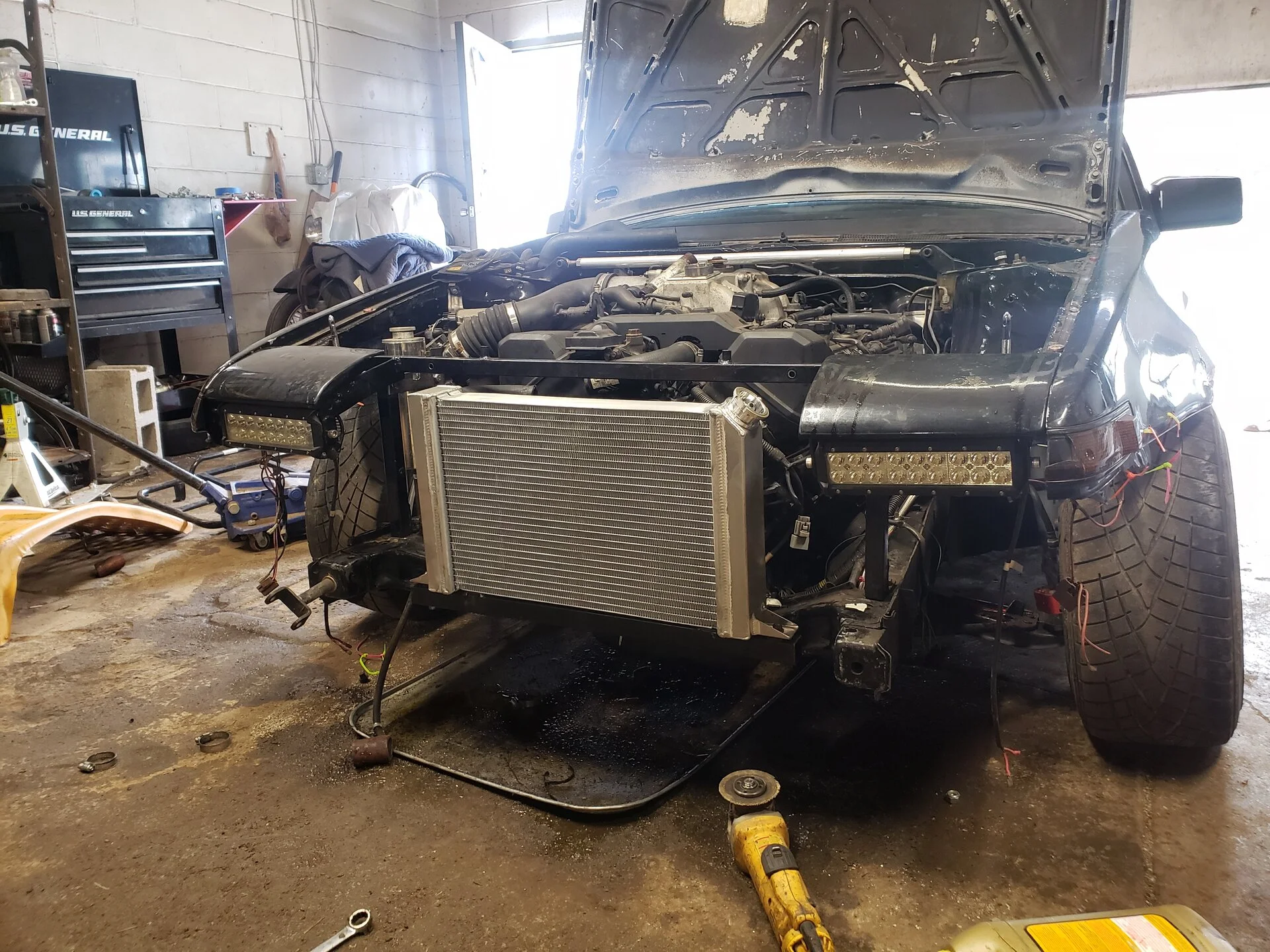

Another option would be to cut the core support and stuff the rad in there. A few inches forward of the usual mounting. Seen it done before but still requires some added support up front.

Are you absolutely sure you can't sneak a rad up front? Mine is fairly small with a single 12" fan. My car will get hot towards the end of a session, but never in normal driving.
The only way I could fit it up front is to cut out the core support and move it forward. If I put a radiator and fan up front it will be so close to the front of the motor that I would have to pull the radiator to change the belts. I'm not wanting to be forced to do that.
