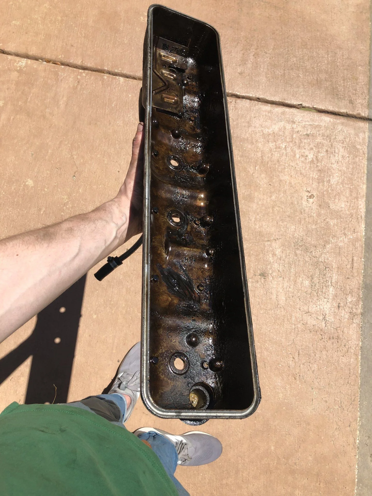

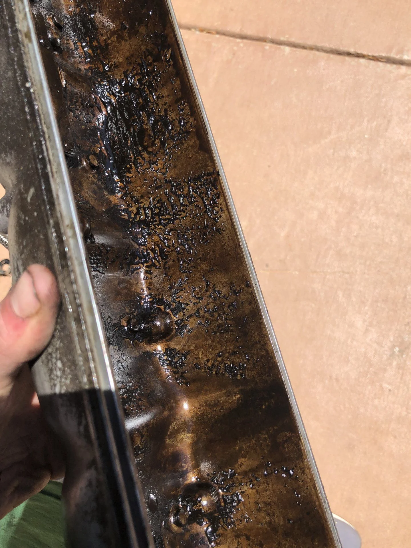

I took the head cover off, no peanut butter milkshake, just some pretty thick black deposit in some areas.

With some research I found threads on the Oil Galley Plug on the head, don't know too much about it, but will post a photo to get feedback from you guys.
Until then, enjoy this photo of my head cover.

And last, how many miles on the engine? The oil gunk in the valve cover is somewhat concerning, as sludge may build over time, can be cleaned out with a seafoam or distilled water steam treatment.

Finally, Im currently at 238,355 on the OD. I went ahead and cleaned out the head cover after taking pictures, as it was a thick sludge of oil it seemed.
