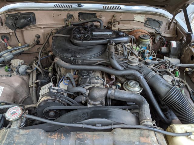

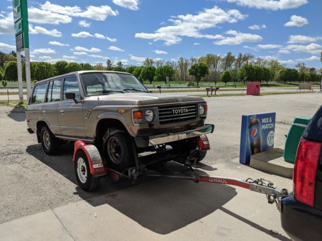

Hello - long time lurker, but finally an owner as of April 2020. After a long search, I finally found her 5 hours away. My buddy and I made the drive and towed her home.
I tackled the engine first:
-replaced all vacuum lines
-replaced any hose I could (lots of cracked hoses)
-new thermostat, housing, and gasket
-new water pump and gasket
-new radiator (old one leaked)
- Rebuild carb
-Steering pump mount for Saginaw pump (Thanks Georg!)
-replaced oil pan gasket
- oil change - new oil filter
- cleaned valve cover and replaced the seal
- stripped and repainted the air filter housing - new air filter
- replace fuel lines
- updated A/C
- new belts
- new spark plugs, wires, distro cap, and rotor
-carb fan wasn't working - was not grounded properly
-Stainless Steel battery tray
-cleaned the engine compartment

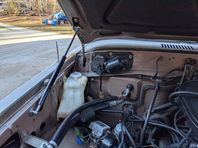

More recently I have added the windshield washer reservoir and lines/sprayer as well as the mod for the hood hinges.
I have new battery cables from Fourrunner, but have not had time to install them.

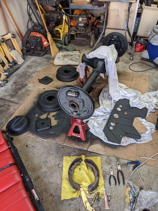

After the engine got some love, I moved to the Suspension and steering:
- 2.4 in OME lift (Med in front Heavy in rear)
- rebuilt knuckles
- rebuilt hubs
- rebuilt brakes
- new bearings and seals in both axles
- gaskets replaced
- steel brake lines
- new TREs

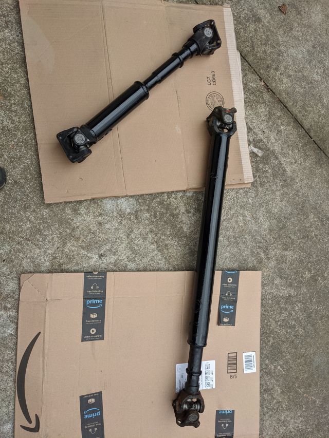

Right now I have the driveshafts out for rebalancing and new U-joints due to vibrations after 55 mph. I have been working on tuning the engine as well. Tested compression, set timing, and performed a dropdown test on the carb. with a new choke cable, cold starts are no longer an issue as she starts up great.
I have noticed a "clicking" though and not all the time, seems to go away after the engine warms up, but I took a video just to see if anyone with more experience hears anything unusual.

Nice work here. You really got after it.
Hard to truly evaluate an engine sound via video, because it depends so much on whatever device is recording, and where you're at - but yours sounds pretty normal to me. Like an industrial sewing machine. The steady 19 on the vac gauge is a good thing.
I have those same wheels in the same size. Like them a lot. I think I painted them with Toyota Forklift paint, which is a medium gray.
I'd say valves but your vacuum looks solid. Since the tick exists when cold, it could be exhaust leak and/or a loose valve. I'd do a valve adjustment just to check and see what you're working with if you haven't already. What weight oil? Out of curiosity, did you check your timing at idle with vacuum advance hoses removed? I feel like I hear a vac leak but again, vac looks solid. I'd be curious what it all looks/sounds like when warm.

Thanks guys, I've had a lot of fun working on her. Weather permitting, this weekend I'll run through some of the suggestions mentioned.

I second what mattressking said about “I thought I heard a vacuum leak.” Must be the air from the fan hitting the microphone or something.

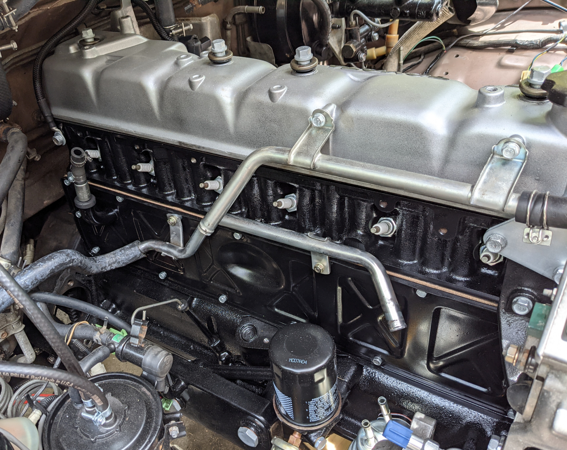

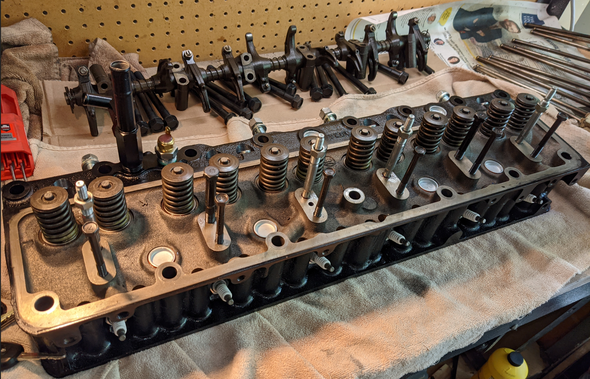

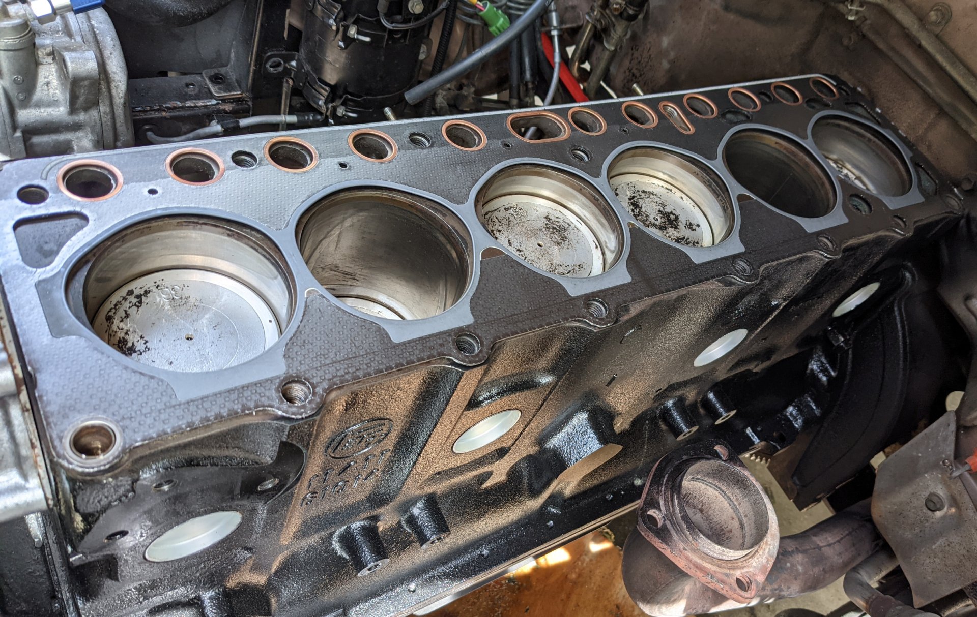

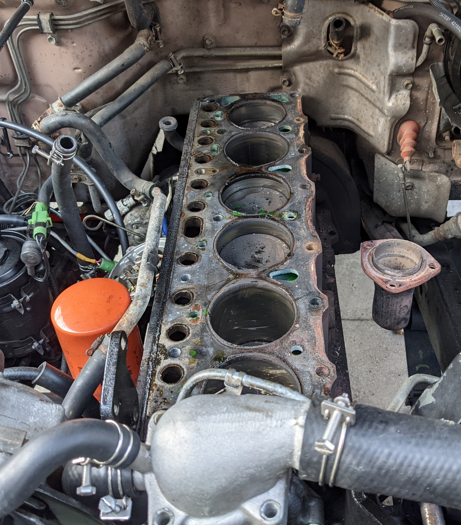

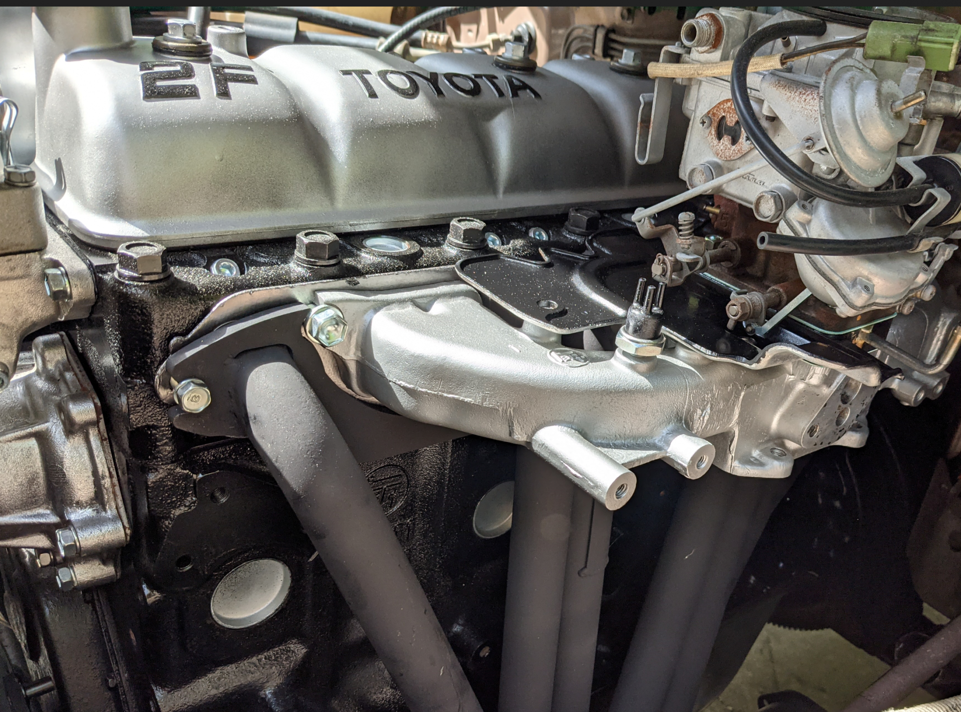

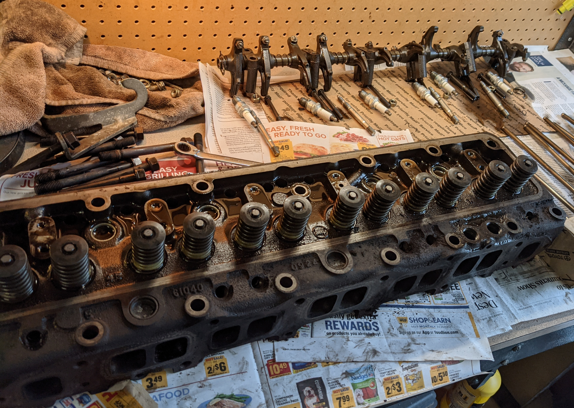

Some updates to the build. While chasing a ticking noise, I decided to de-smog and clean up the engine some. Replaced the head gasket, and cleaned up the cylinder head.
Been a few years. Still chasing a faint tick from the engine after the rebuild. Stethoscope says its from cylinder 5 or 6. I believe I've got the sniper dialed in, pulls and cruises great.
