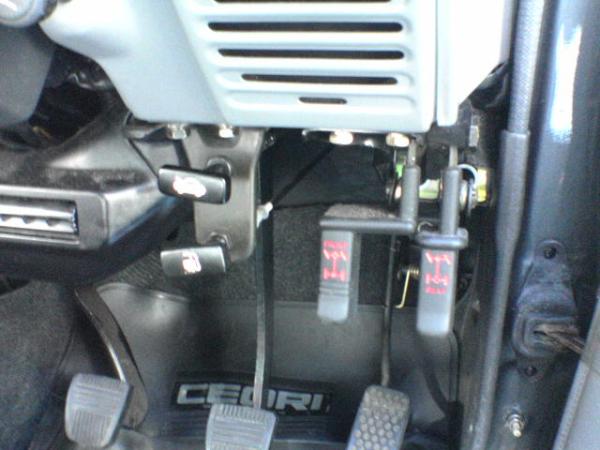

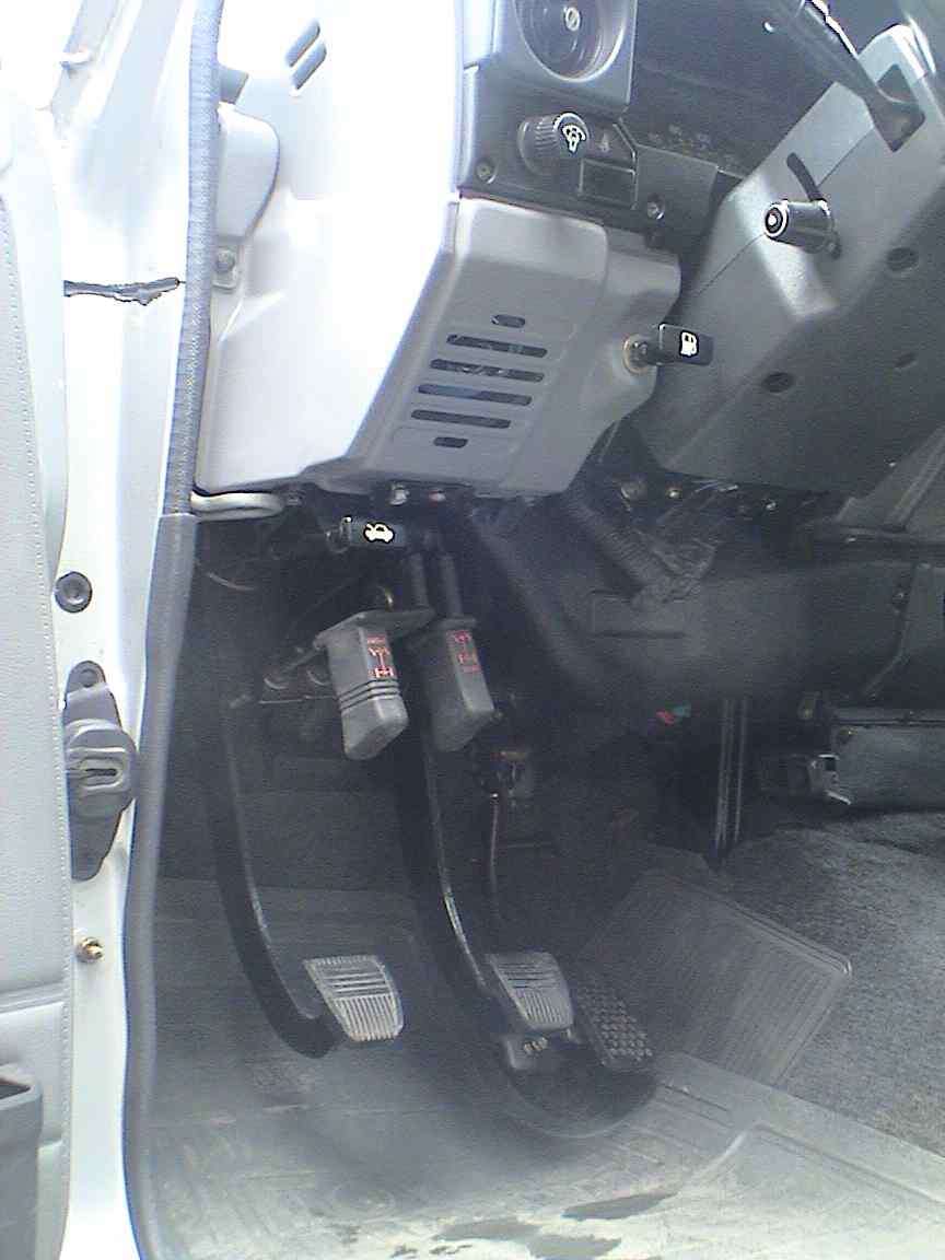

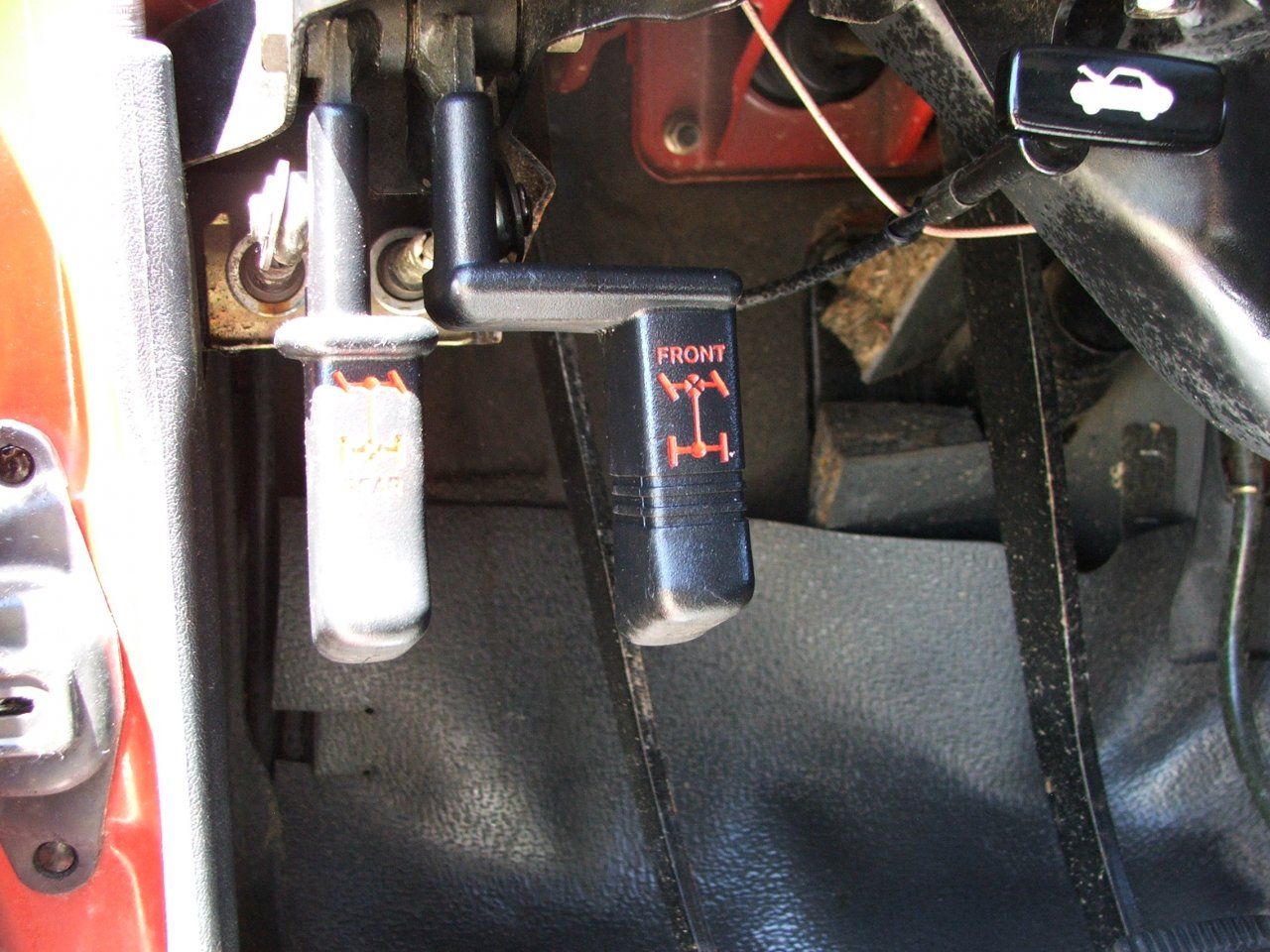

Got some motivation and finished the cable locker handle assemblies. When I bought the cable lockers from Sheldon, he sent me some photos of what some of his customers have done to install them and some other photos I've found here (some courtesy of Sheldon and some of Delancy)
RDH Cable Locker Handles on a RHD vehicle:
LHD Cable Locker Handles on a LHD vehicle:
RHD Cable Locker Handles on a LHD vehicle:
Cables exiting the cabin on a LHD vehicle:

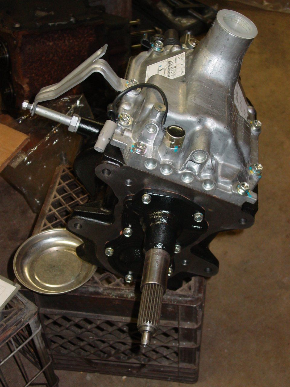

Pete @94SRUNNER went to dinner with Onur and hang out for a little while. There is nothing wrong with the H55 that is currently on the truck, but since they are still available from Toyota and the price is not terrible, I figured it was worth buying it instead of rebuilding the one on the truck when needed.
Since the only H55's that are available new from Toyota are the ones for the F/H type input shaft, I bought a brand new B-series input shaft for the H55 from Yan @Akella to later swap it into this new H55. I took it to JimC @FJ40Jim for him to do the input gear swap.

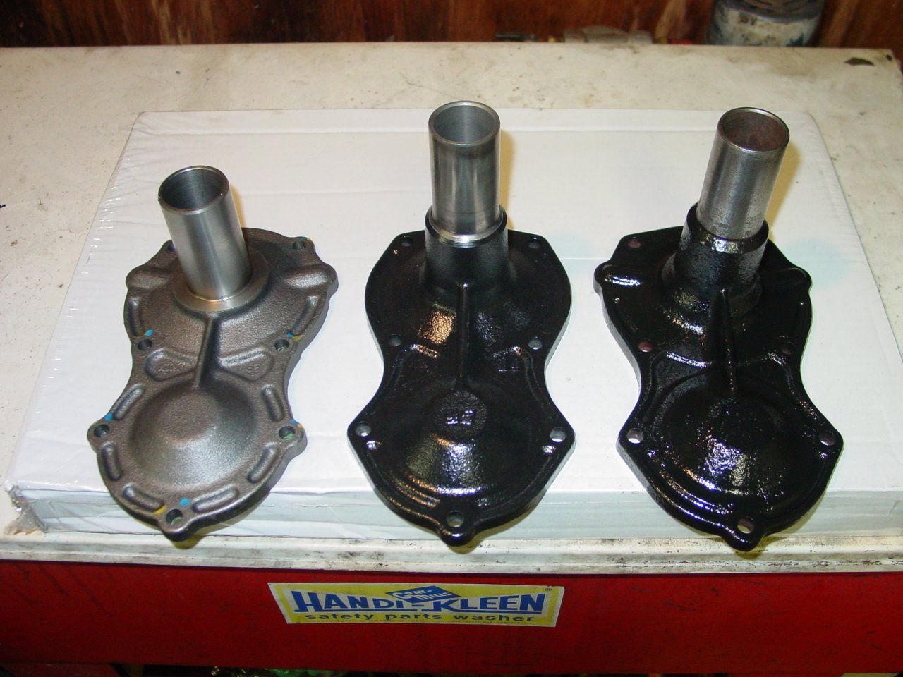

We later ran into some issues with the front bearing retainer as they are different from the B to F series, but they are also different from the early/late style H55. See these two threads for reference:
https://forum.ih8mud.com/threads/h55-86-newer-nosecone-bj7.839856/
From JimC:
Pictured below L to R, the brand new snout that comes on H55 to fit 2F, the wrong (small bearing) 3B snout, the correct used 3B snout from EBI.
And the new H55 configured for BJ70:
Thanks, Jim, for all your help and hard work on this.

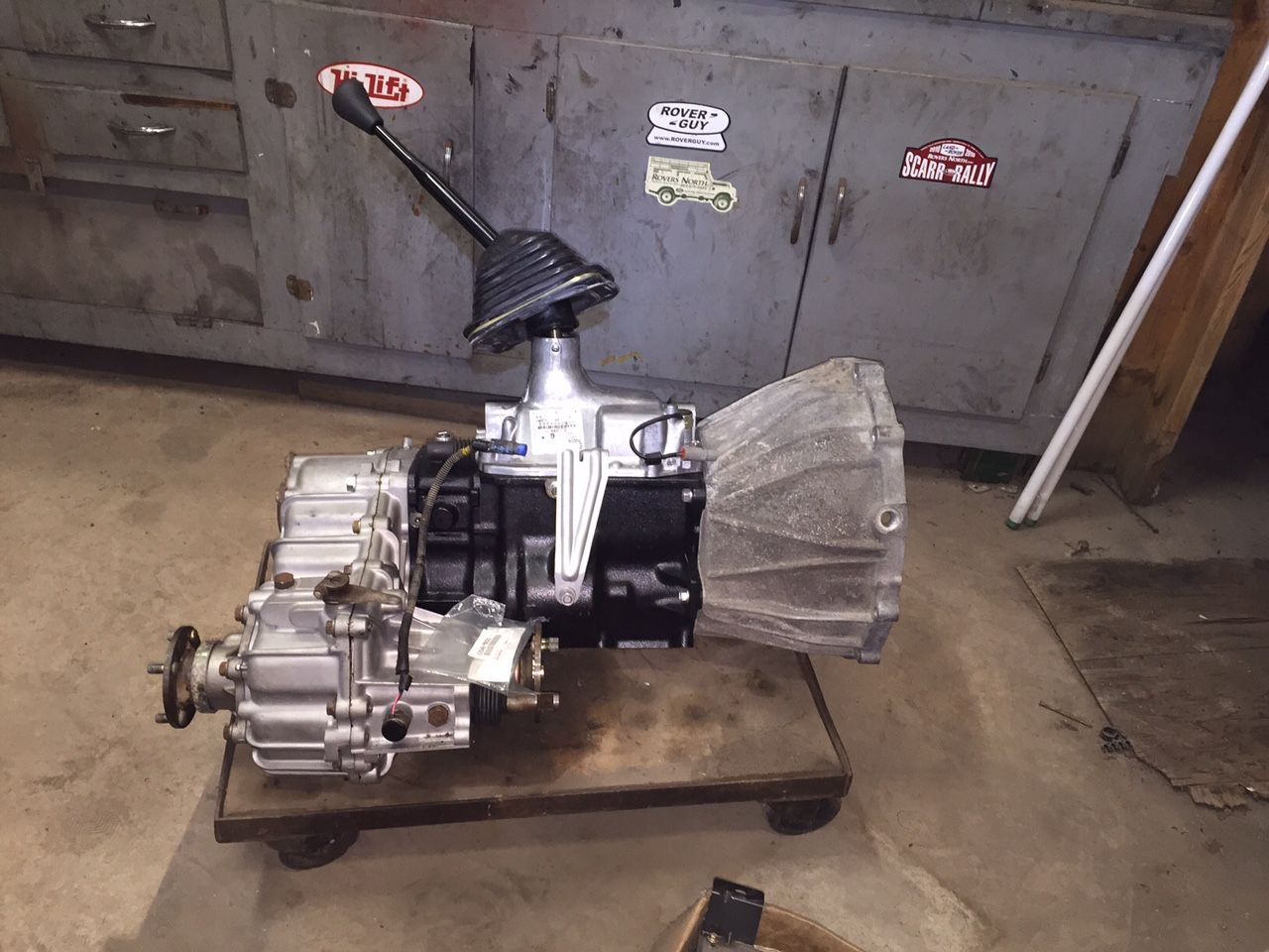

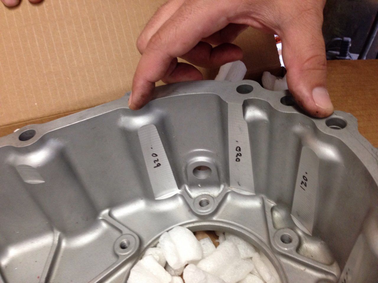

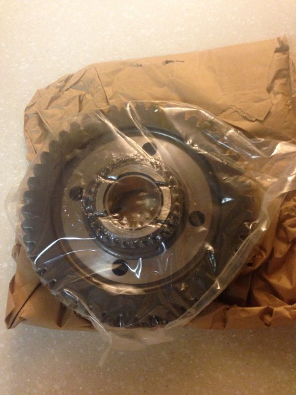

I later bought a set of AA 4:1 gears for the Tcase from Georg @orangefj45 along with machine Tcase halves (also from Georg) to install these gears behind the new H55. JimC @FJ40Jim also completed this step of the assembly.
Note the machining needed to accept the lower gears:
Thanks, Georg and JimC for all this work!
-Alberto

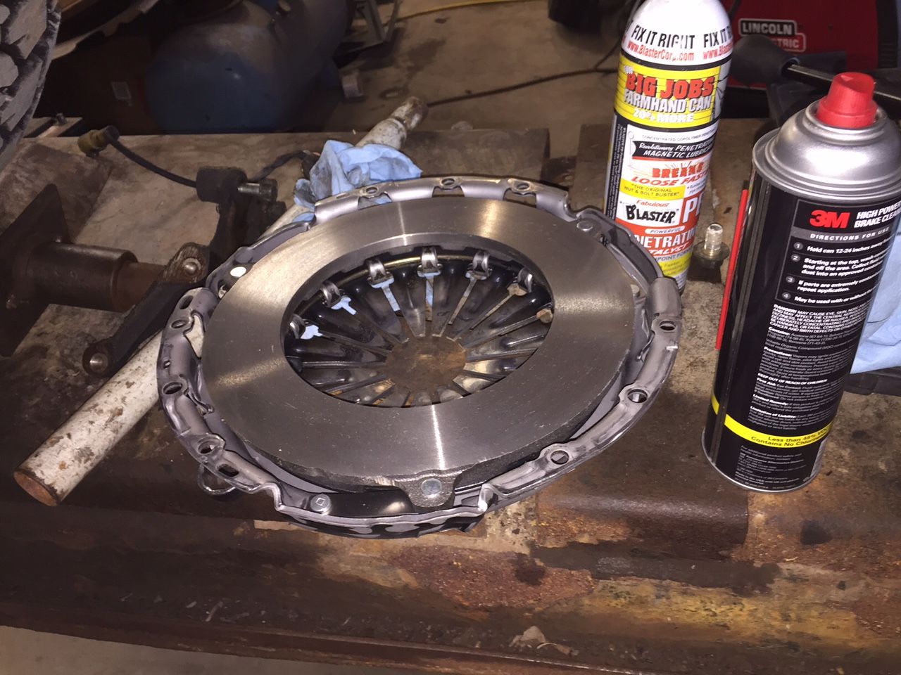

Along with the new H55, I installed a grinded flywheel and a new Genuine Toyota Pilot Bearing:
A new Genuine Toyota clutch disc:
A new Genuine Toyota pressure plate:

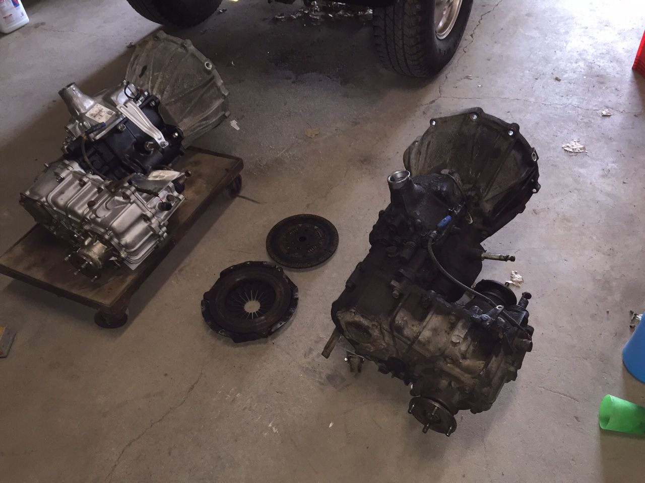

Out with the old and in with the new:
532-jpg.1123057
So what is to become of that old thing.... :p ;) Is it something worth having rebuilt vs. just buying new now that its out? I'm really thinking about a 5-speed manual conversion on mine...this auto is just not doing it for me.... :-/
