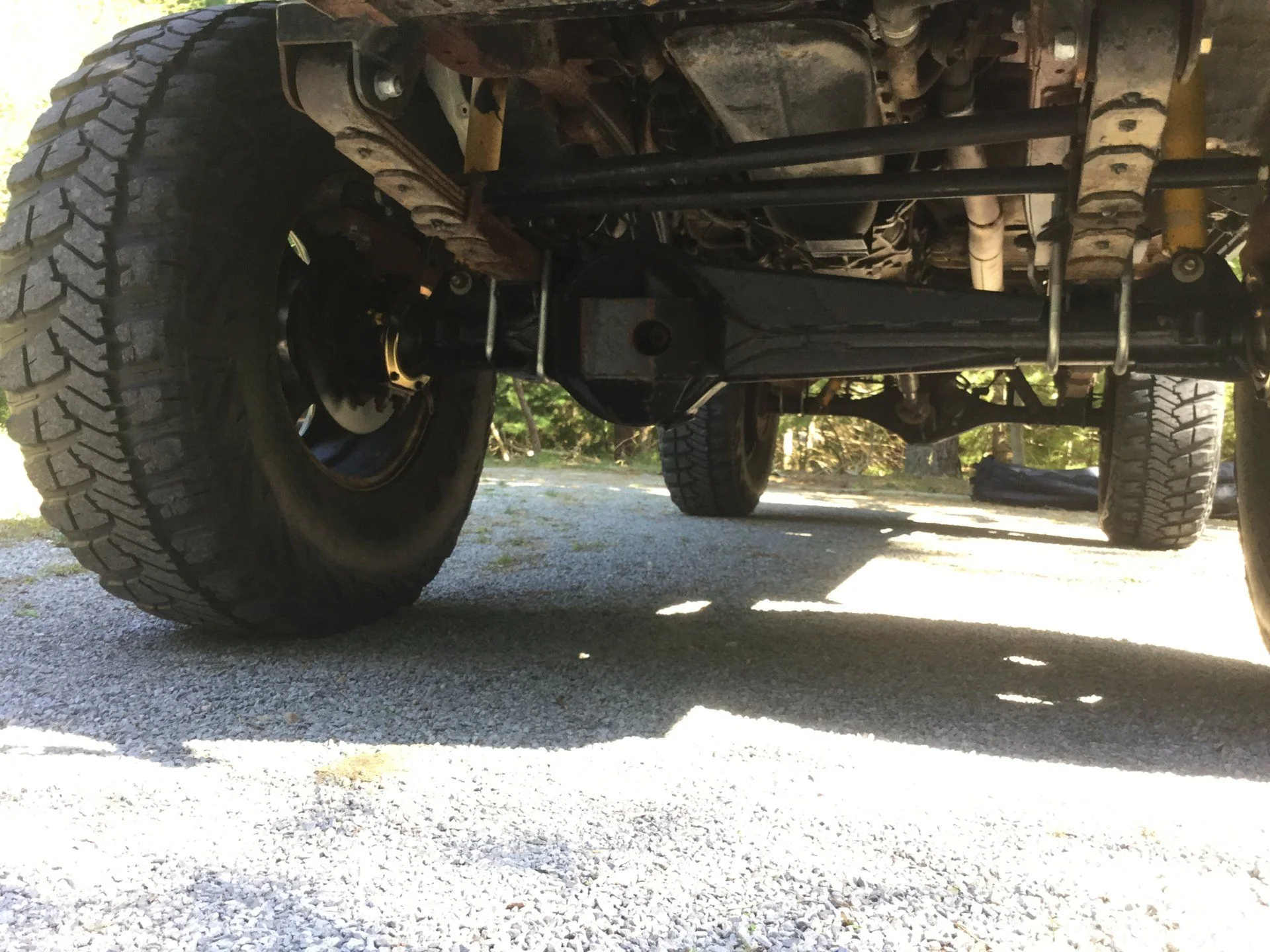

Hi all, I'm new here and new to mechanics. I recently purchase a 1984 Toyota sr5 in good shape. It has a approx 5" leaf spring suspension lift, rebuilt 22r engine, double transfer case w/ crawl gear, e lockers front and rear, arb bumper w winch, etc. it runs well but I am having two issues I need help w. The first is a high idle when I am driving and depress the clutch. It hangs aroun 1500-1700 rpm. A blip on the gas and it drops to 800-900rpms. Was checked for Vac leaks and none were detected. The second issue is when I am in 4hi/low, there is an intermittent wrenching noise that comes from what sounds like the left front wheel. The noise is rotational and matches the tire rotation, or so it seems. It goes away if I turn the wheel but returns when I have it straight. Again, this went away for a week and then came back this am while driving on the beach. Any help is greatly appreciated as I am new to mechanics and want to learn my truck. Thanks all!

Maybe dry or worn out birfield joints... Does the noise happen all the time, EI while turning and going straight?
It only seems to happen when I go straight and only in 4wd. It goes away when I turn the wheel and returns when I straighten it out. If I made S turns the whole beach= no noise. My one friend did say the birf joints looked dry. I will get em lubed up!
