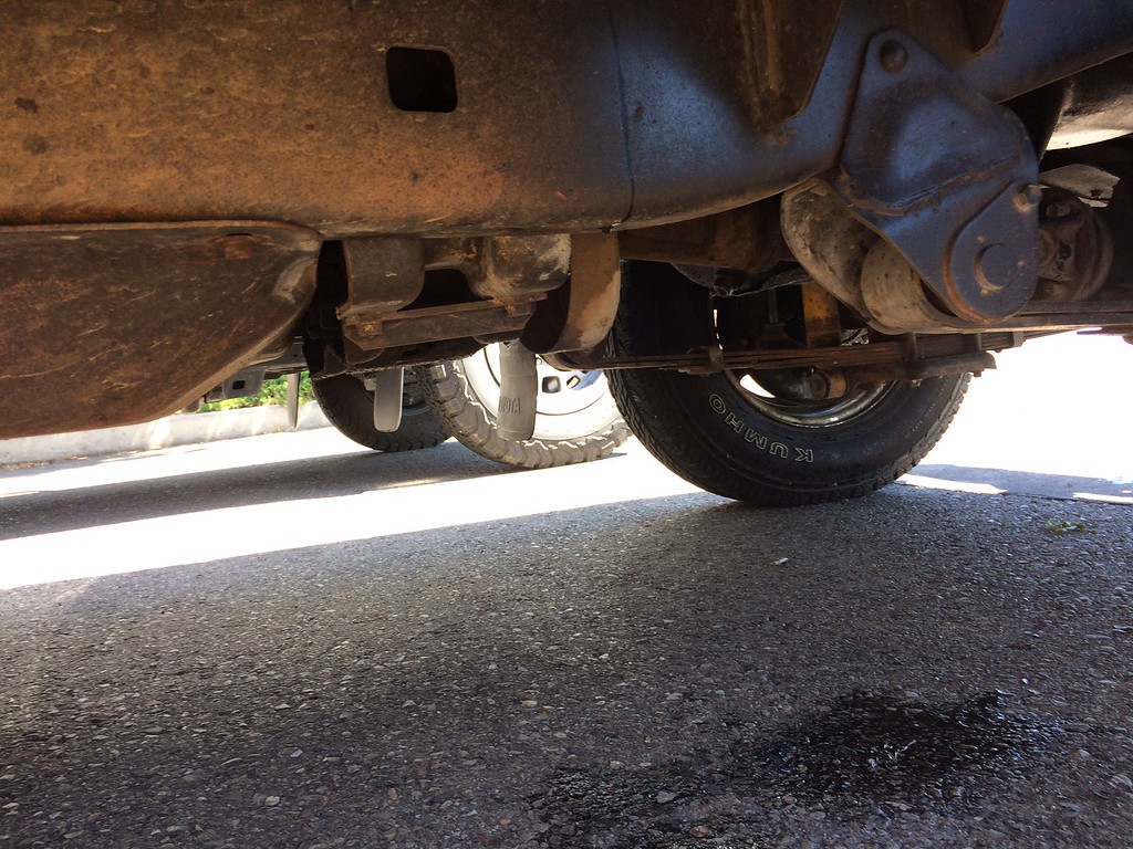

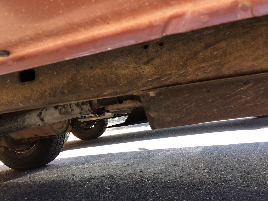

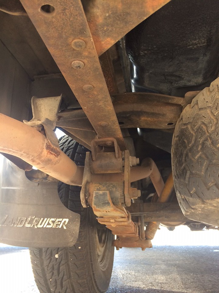

The chassis looks nice and solid but I need to treat/paint it before it spends much time in Vermont. Also I do see the bushings are shot.
Cannot remember if this was a leak or a drip from the AC or something else. My friend wasn't up to speed on how to ID the fluid.

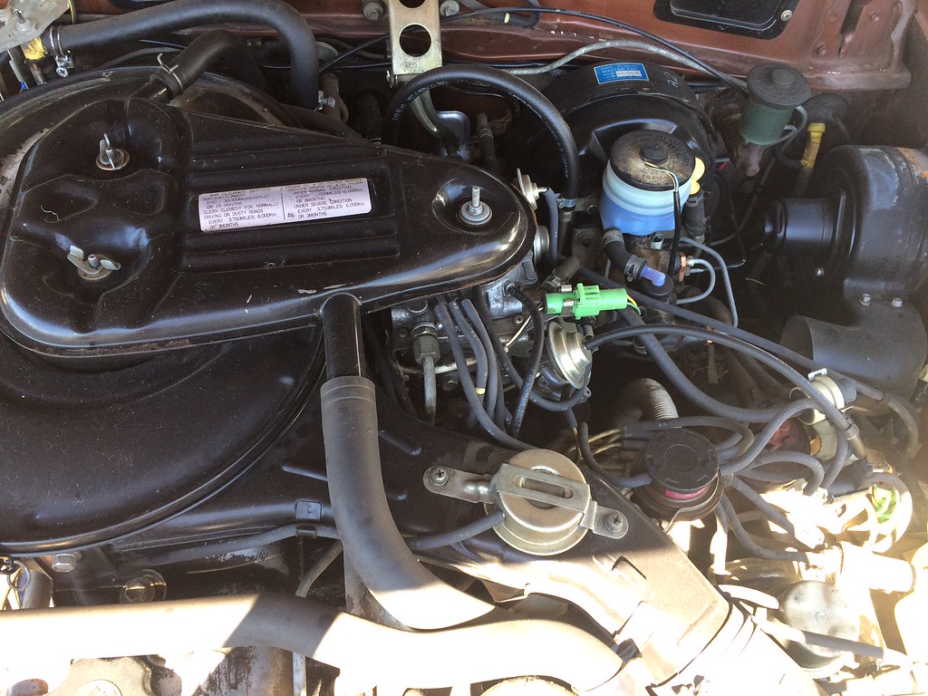

Nice truck, engine bay looks pretty tidy.
Leak appears to be a/c vent if it was running, another possibility is brake fluid from clutch slave, but you would know as the clutch would not work.
Touch the fluid and smell next time, that is how you identify. :)
