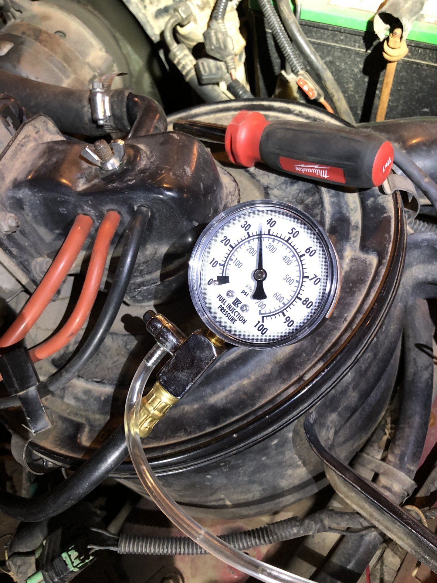

I have a 2FE converted FJ60. I have been having the hesitation/stutter/and fuel starvation from hell... the truck will run pretty good until about 10-20 minutes of driving. That’s when the hesitation/lack of throttle response/bogging/fuel starvation starts happening most frequently.
Original 2F block with 3FE parts from an 88. It still has functioning smog Equip. Summit Racing fuel pump SUM G3138. I am consistently getting 35-40 PSI whether hot or cold. Fuel filters have been replaced. Truck has been run without a gas cap to see if vapor lock could be happening. The fuel pressure regulator has been replaced. EGR valve has been cleaned. Vacuum lines were sprayed with brakleen and no fluctuations have been heard or found. O2 sensors were checked and found to be functional. Spark plug wire were checked. Distributor was checked and was tight. I have checked as many grounds as I can possibly find, all seems to be clean and tight.

Have you been able to get a fuel pressure reading *while* it's acting up? Toyota spec for regulated pressure is 37-46psi, so your certainly on the low end (presumably with a light draw on the pump).

You have a good trick to get a reading of a fuel pressure while driving?

What would be the best way to test this while driving?
You will either need a multimeter with an inductive style clamp you can put on the power wire or you will have to wire the meter inline with the supply power. So on typing this its not likely that either of these will be easy for you. I'd start by wiring up a volt meter to measure the voltage across the pump that you can read while driving. This way you can look at the pump voltage drop directly when the problem starts. At the same time if you have a fuel pressure gage hooked up you can monitor the fuel pressure and how it corresponds with the voltage drop.
