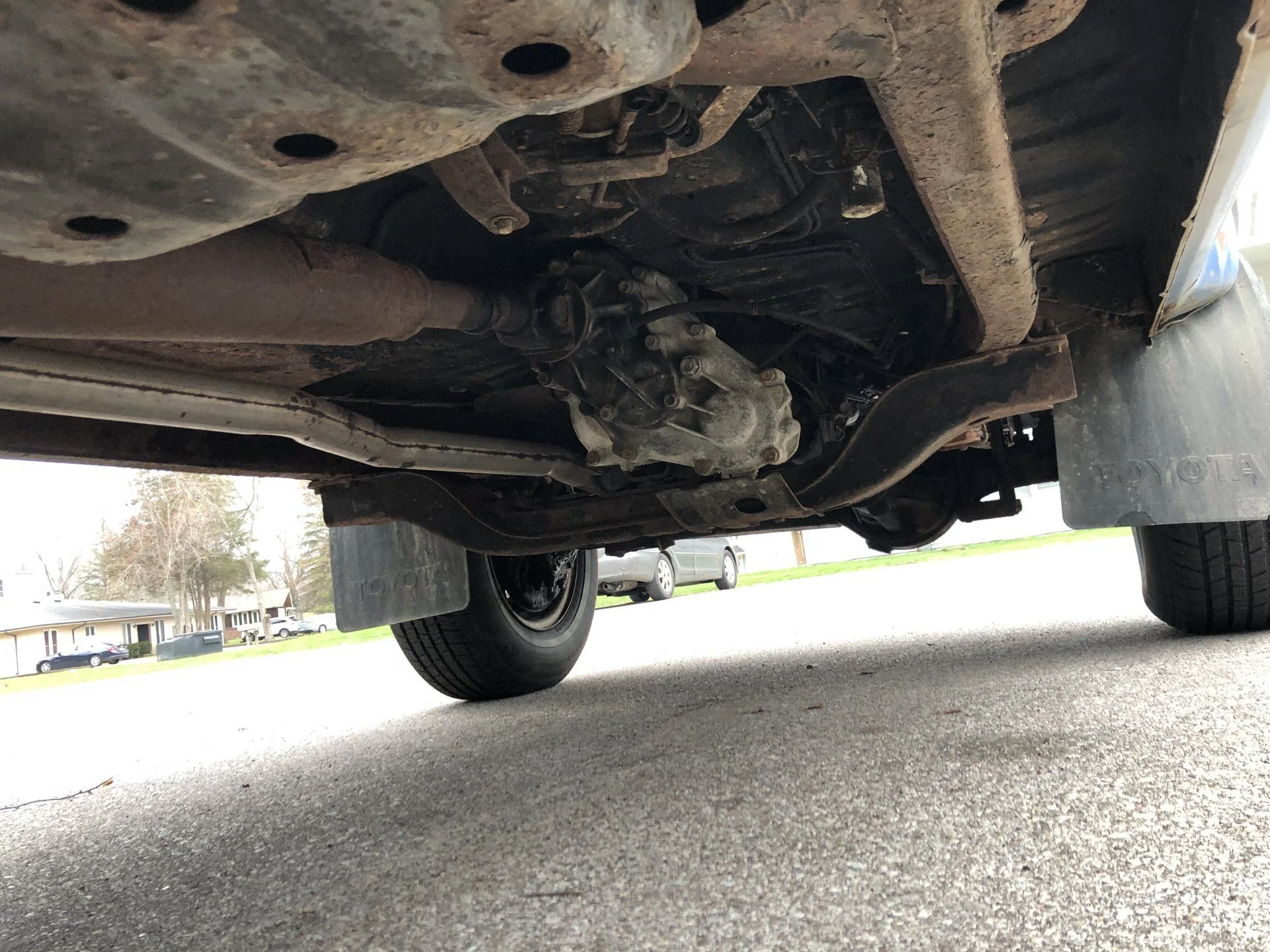

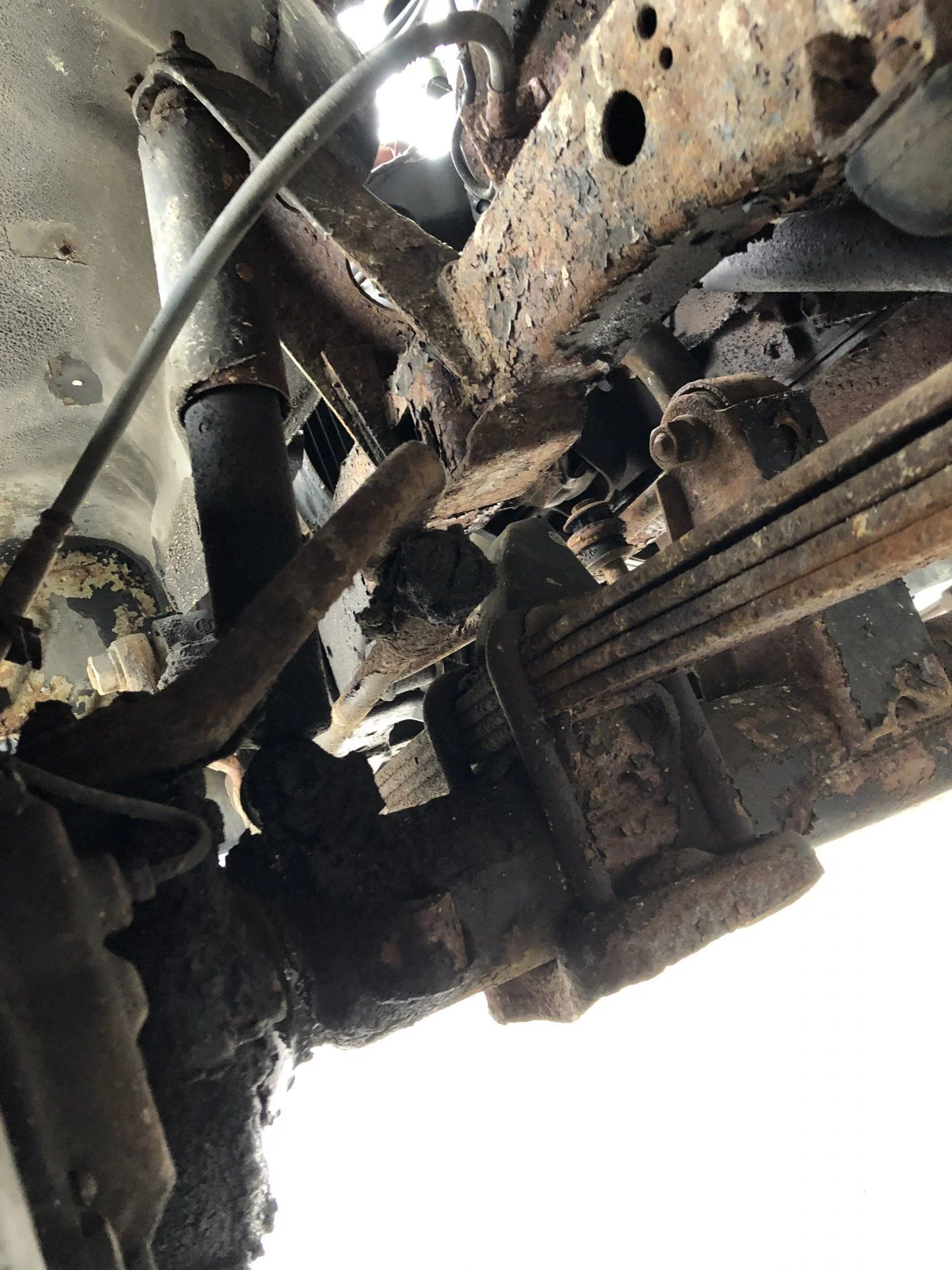

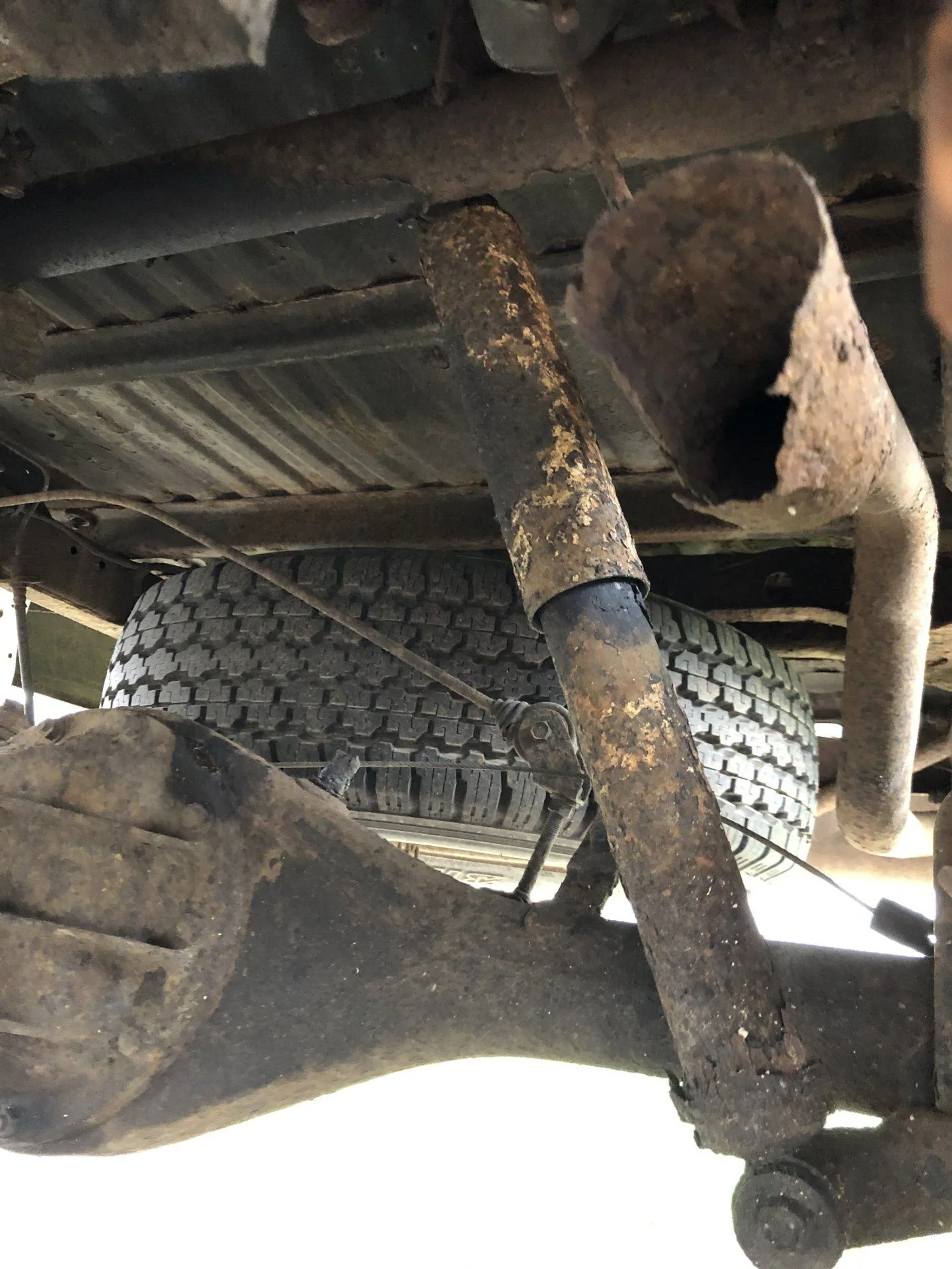

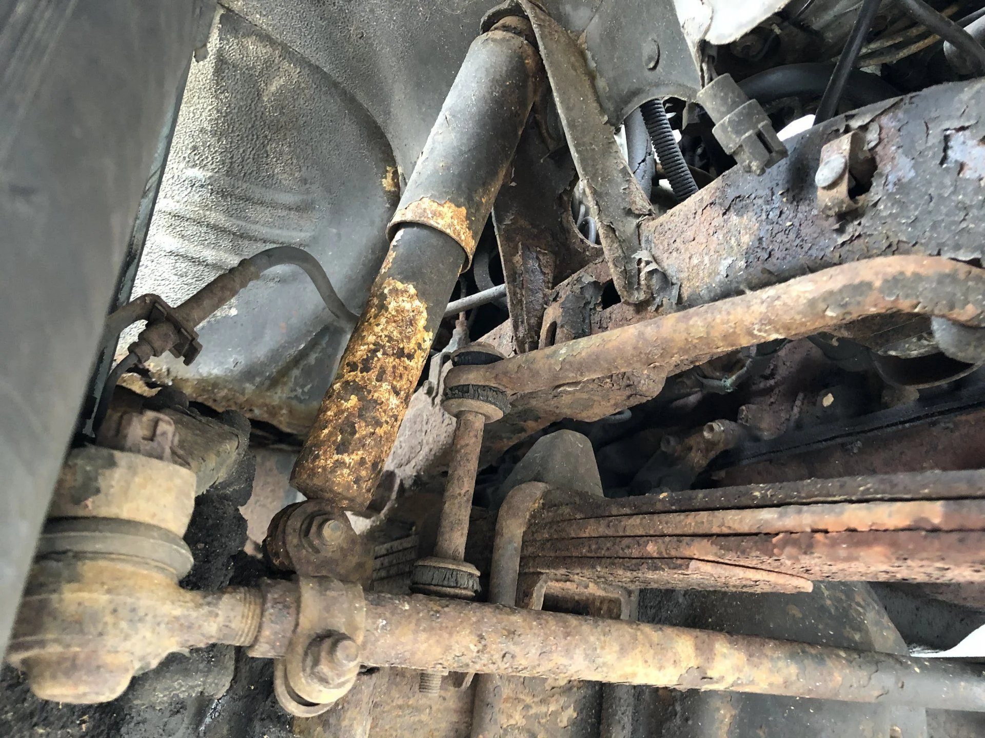

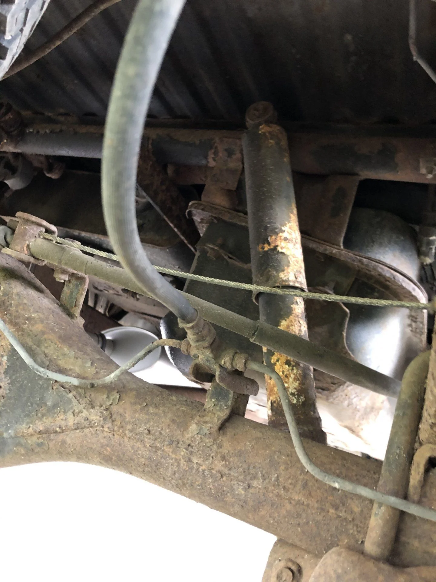

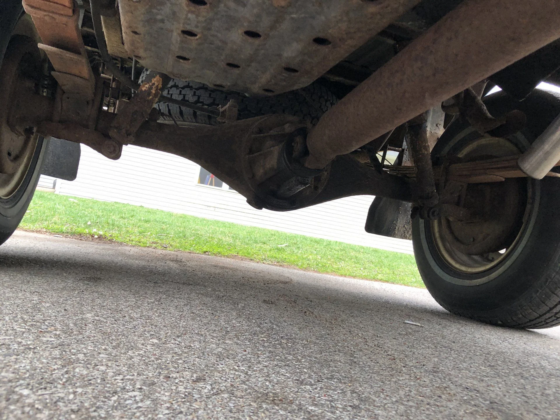

I posted some pics below let me know your thoughts. I also have this so hopefully i can most of any necessary work myself.
Well, that is a project. Good luck. Two observations. First, your sway bar bushing are toast. Add that to the list. Second, the front springs look inverted. No lift.

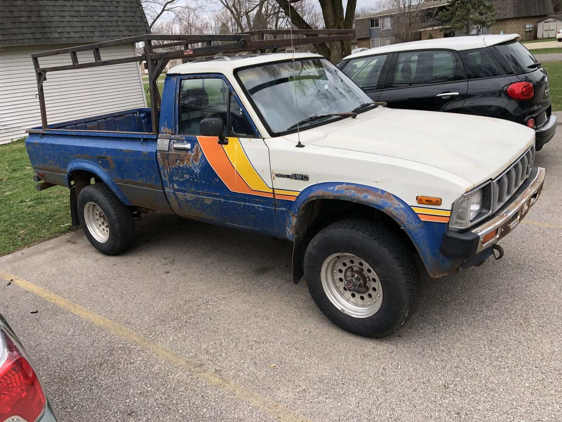

That thing can't be from Michigan!? (I'm from MI and toyotas disintegrate there)

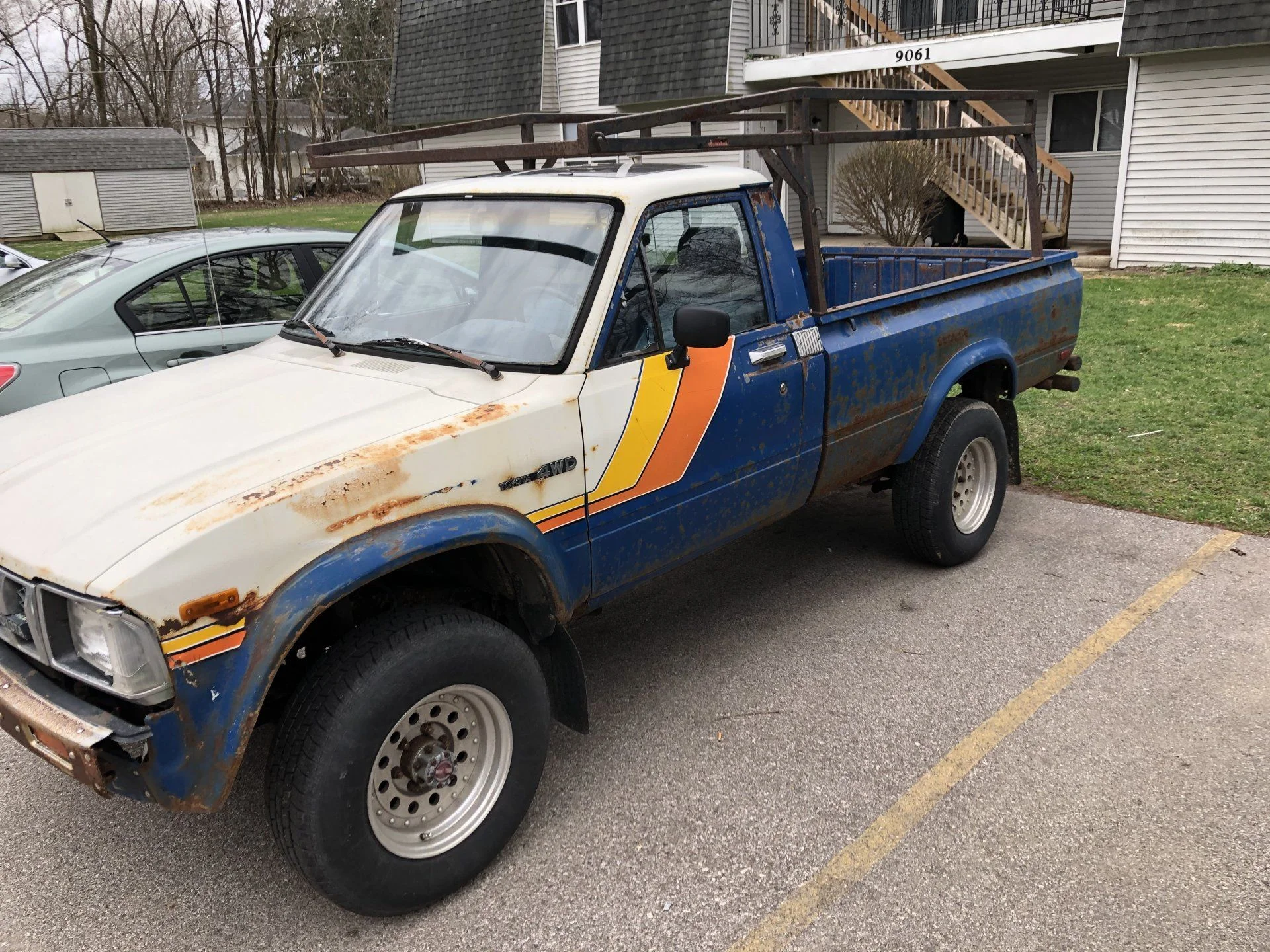

Easy fixes, thats a cool pickup! Best paint scheme ever on a Toyota and rare too!

Lol yeah my grandfather bought it in Southern Cali

A very cool paint scheme in mini truck history! Enjoy!
If you look at how close those bump stops are to the place they will come in contact. It is a very short distance so you will likely be using those a lot more than you should showing how the springs do look inverted like @pappy indicated. Have you considered getting the underside coated with fluid film or anything? Seems like you've lost a lot of paint under there and leaving it without any treatment might really make it's life with you very very short.
