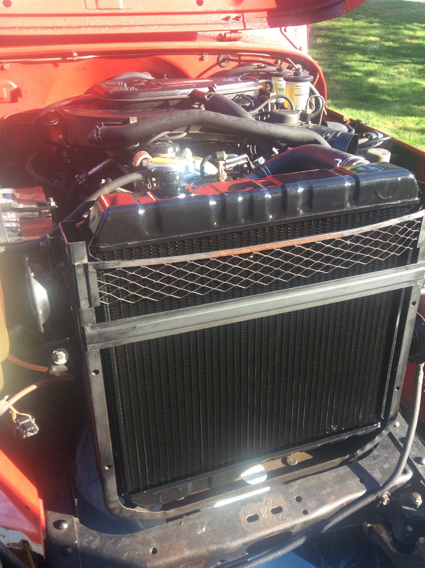

Here’s my newly replaced OEM radiator from City Racer which I completed in August. It looks like a perfect fit for your application. I highly recommend it. Oh, and you could use a fan shroud too ;)

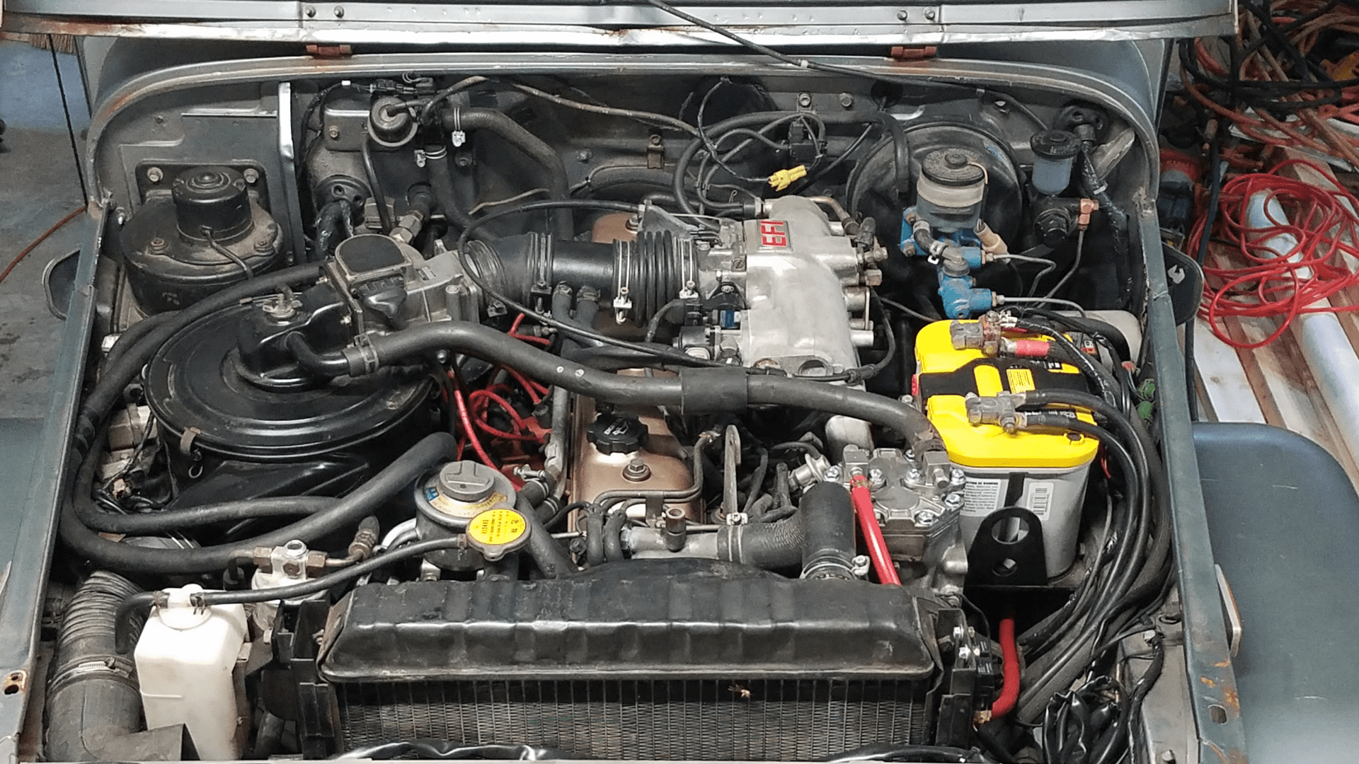

I don't have a build thread, perhaps I should consolidate all my stuff in one place. I like the Architect's thread. This is just a 3fe from a 62 series.
That looks like it was born with a 3FE @Engineer8000 nice job!
