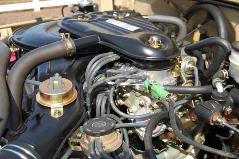

You mentioned it is running bad. Could be because the vac hoses are not routed correctly.
Take a look at the HAC hoses. At least one is wrong. Which means at least one other hose is wrong.... The domino effect. could be several that are slightly out of place. Unfortunately, close is not.... close enough.

Please put an arrow on what one(s) I had a 30 year tech at Toyota narrow it to a vacuum leak at 1-2 intake side do to incorrectly machining the exhaust causing no tension on the intake ear next to 1 exhaust.

The running bad is only at cruise, you hammer down and she rocks! coasting it uses vacuum to slow down, Idle she purrs.
So while at cruise it feels like it lean and you have to use throttle to gain momentum or keep steady speed.
Green hose should be connected to primary HAC on carb.
It is being dumped to atmosphere instead.
The yellow hose is currently connected to the HAC primary fitting on carb air horn.
Other end is not connected to correct spot on spaghetti pipe.
Red circle is showing vac restrictor that does not belong in secondary HAC hose.
Those are the obvious issues, there could be more hiding outside the frame of the photo.
Have a look at page 3-3 of 81-87 2F emissions FSM for a good illustration of exactly how all the hoses should be routed.
:cheers:
When are you coming up? I am driving it every day, but I need to remove the manifold tonight and have the ears re ground to match the middle. I have an intake leak on the under side due to the ears not matching the rest of the machining.........That took me a week and a trip to Toyota to figure that out.

Ok, the head is off and to be honest I have no :censor: idea how in the hell I missed the s***ty intake/exhaust grind. I just set it on and bolted it up, I was :censor: :censor: and felt :censor: stupid that I missed something like that. The non face side intake and exhaust ears that the washer touches is no even close to being the same.....
I should have assembled it and not had my machine shop. Lesson learned.
