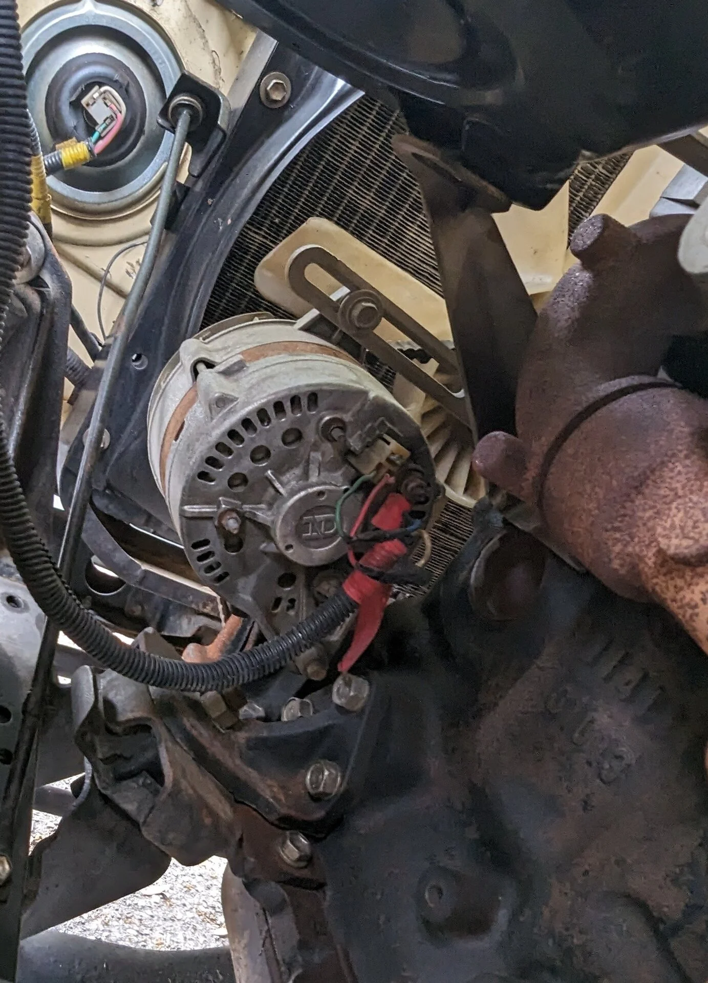

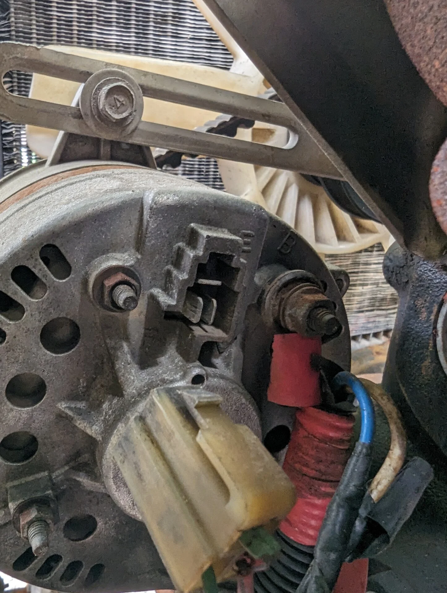

I'm trying to find a replacement alternator for my 1981 FJ40, but I'm having trouble identifying the current one to ensure the new one mounts properly in its place. Ayone have an idea from the photos?

So cityracer has something. Look at the notes and pic's. You should call them as I don't see a green plug on yours.
The reason you aren’t finding anything is that you are working on a Non-US example and the alternator is mounted differently.
This will work for you, however since that is an original NipponDenso alternator my preference would be to have that one serviced if possible.

I believe non-US needs this one.
The '74 and earlier alternator has mounting arms at slightly different positions.

Not intended to argue with you about your own products - but that 75-77 version, or any alternator intended to mount in the upper passenger side would not work for him without fabrication. The pre-74 would be the bolt-in. After 74 (Start of 2F production) when USA market shifted the alternator to upper passenger-side, ROW (Including Canada) stayed in the "F"/pre-74 location with the same mounting brackets, belt, alternator mounting tab position etc.
Learning something new everyday! I always thought that all 2Fs used the same alternators except for the plug change starting in '78. Didn't know that non-US markets used F alternators. That's great information.

you have a 1981 general counties non-SRE cover later modle nippondenso there

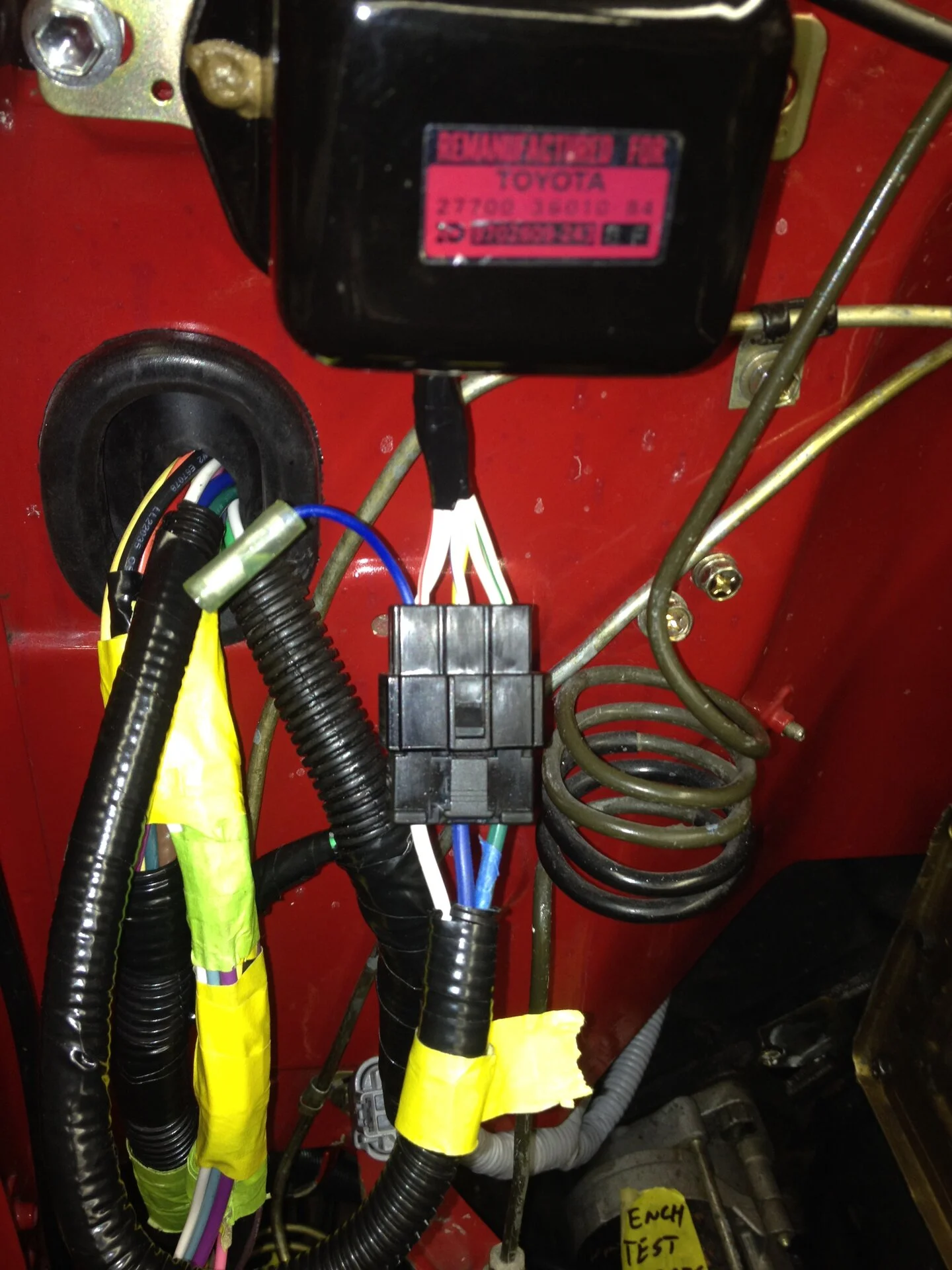

you should have a 6-wire plug voltage regulator on your upper passenger side fire wall correct , / like example same in kind general countries example below
