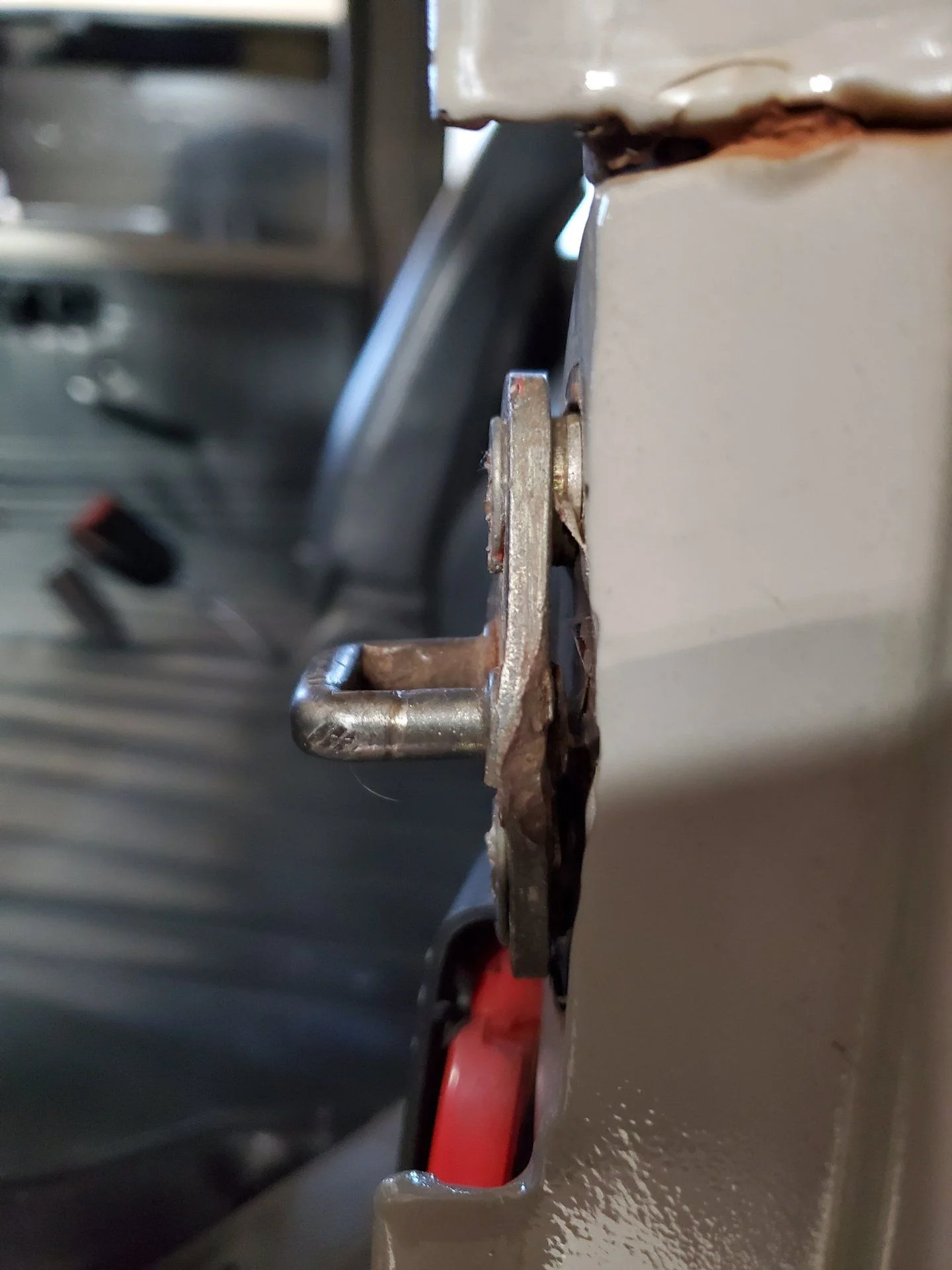

My 40 came with solid doors and a hard top. I believe the doors were form a different vehicle though as the fitment seems off and there is a large gap between the passenger side door and the rear tub of the body. I can actually see the lock strike when the door is closed. Is there a way to ensure the door size is correct for a 1980 FJ40?

40 series doors are only one size, so you may have a tub issue? The striker must be spaced out from the tub for it to catch and close?
Ha.
That was it. The body must be misaligned or bend. There are indeed spacers behind the striker. Now I just need to figure out how to realign the body.
