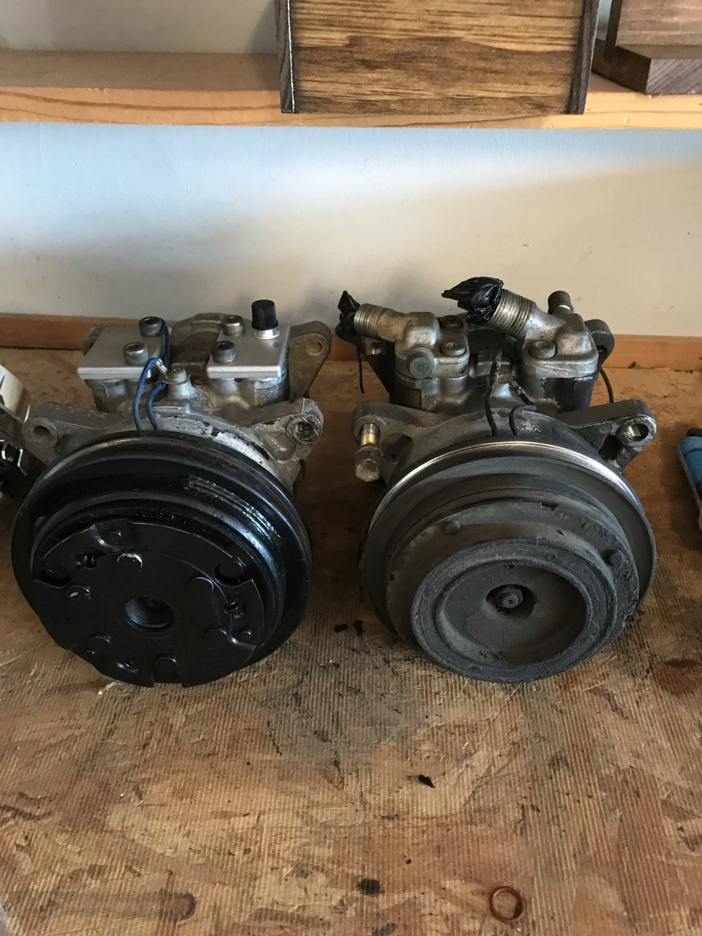

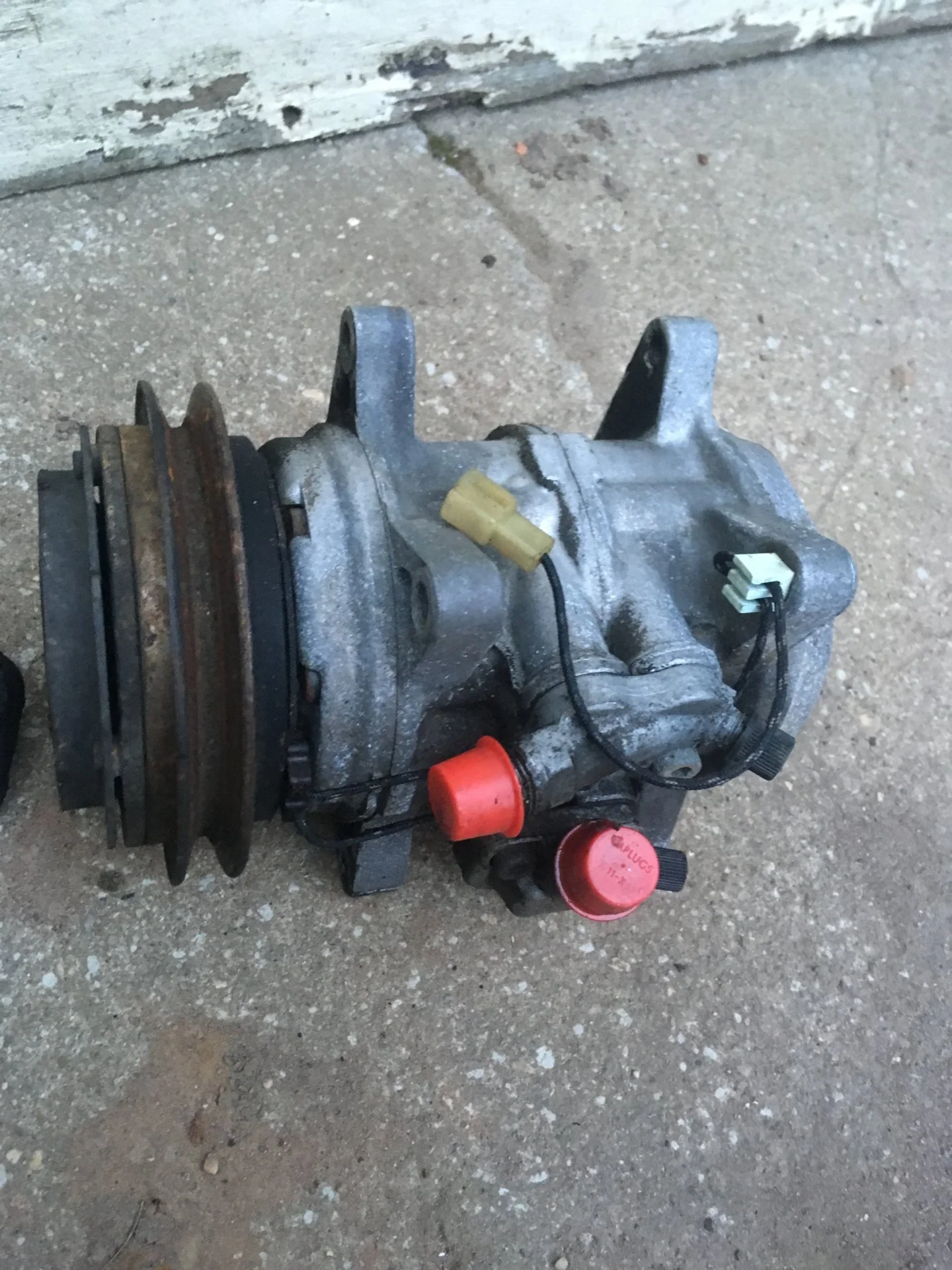

(Pics borrowed from Mud)
The first pic is of an early 40 series ND compressor. Note the manifold orientation. The second pic of two compressors are from 60 series.
I think the 60 series will bolt up fine but not verified. You might need to adjust hose length and/or routing to fit though.
