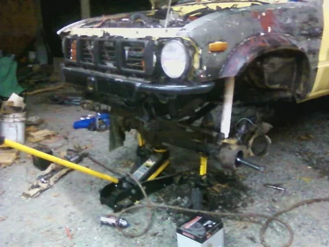

So the second round of brake parts have shown up and I had a chance to pick away at tearing it back down. I knew the front end was coming back apart so I only used the new gaskets with no rtv sealer and one side definately took on water and one didnt. Anyways I initially threw the one side back together with the new brake parts as I want to get it to the exhaust guy for rear radiator plumbing but I decided if I did that I will be slow to tear it back apart to put the gears in.... So now I tore both sides back down and will get the 4.88s in it. I also am going to need to dig up a lock rite or something for now even though I really wanted an E-locker for the front.

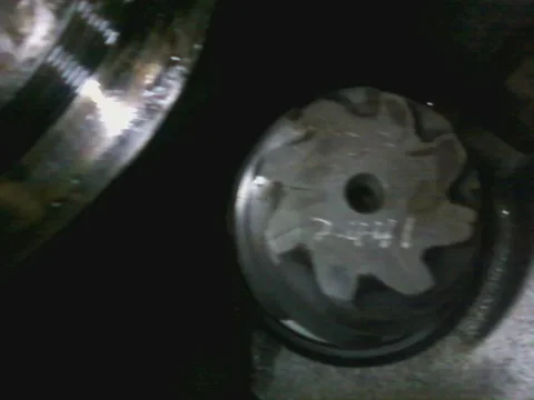

So I started with my factory .080 shim with the new 4.88s and I didnt run a pattern but it measured a 2.454 and my pinion calls for a cd of 2.441 so I pulled it back apart, pressed the bearing back off, and added a .010 shim. Now it is at 2.443 and the smallest shim in the kit is .010 so I am guessing it doesnt get any closer. I am going to throw it together tomorrow and run a pattern to verify

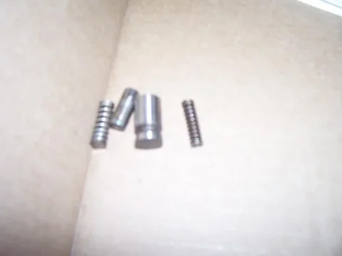

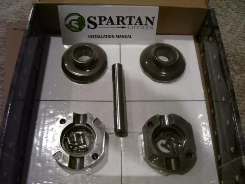

Also I have a lockrite sitting here for the rear (used has been in two vehicles and was nothing but problems which is why I refused to put it in the front but I am not afraid to play with it in the rear. The teeth look fine and a friend thinks it was never adjusted correctly. I took a picture of the two pins and springs. The Spartans claim to fame is the larger pins and they totally are but a portion of them is hollow and the spring goes up inside of them unlike the solid smaller lockrite pins. I do think at the point they are engaging they are full thickness but that is a guess at this point. The lockrite springs are larger I have no idea of spring rates but they are larger. So lockrite larger springs and spartan larger pins.
One thing I do like is on the spartan pin you can see the notch on the one end.... That is to insert a small piece of wire just like you do with brushes on an alternator so you can install it easily and then pull the pins out and whammoe...
One uncertainty is that I do not know how much strength this adds.... The pins are made to push the teeth and the center pin do the holding in my mind. Yes these would add to that as they sit in a small notch on the other side. I like the concept of the larger pins and the way they are hollowed out to basically trap the springs but I am not sure which one puts more spring rate on the teeth. They claim the new center pin the locker comes with is stronger than stock and if so that would be a strength bonus but I personally have not broke a pin nor have my friends but I suppose it is possible.
