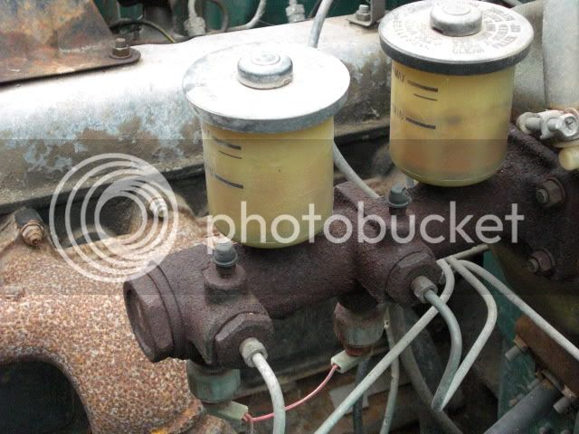

Man... i was really hoping you were going to rebuild your stock master cylinder ... being that it's exactly like mine and i can't find any rebuild kits for it.
Excellent job on the rebuild !!

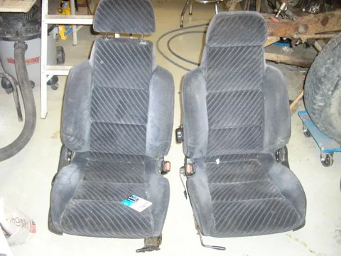

The 90/91 Acura Integra and Honda Civic Si supplied the seats for my 81 mini Toy and I really liked the snug sport buckets off road. I couldn't find a good set at the wreckers but did find these.
The full story - I found a mid eighties 2WD toyota truck with really cool seats, not the ones I was looking for but really cool. As I checked them out I realized they were not original to the truck. They were a great seat but missing the headrests. So as I searched for the Integra/ Civic Si seats (not DX- silly single arm headrest) I found a 90 Prelude with those same really cool seats. These seats have the same snug fit side bolsters but with a bonus. The lumbar (lower back) is adjustable with a lever on the side - pull the lever to get more support. Also the side bolsters in the seat back are adjustable in width by a rotating knob. There is also a "memory" button so that when you flop the seat forward to grab something from behind the seat you don't have to search for the right angle when you get back in - it automatically goes to the last angle that you pushed the memory button at. And lastly there is a lever to fine tune the seat back angle between the "clicks". All of this is only on the drivers side. Passengers are SOL.
I will strip the covers off of these and wash them. Then I'll decide if I will get them re-upholstered. They are small enough for the cab and if I mount them right and high enough it should make the driver position more comfortable. I will be fabricating my own framework for them to sit on. The camera flash washes them out but they are black(ish).

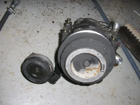

York AC compressors for on board air!
I found one in a Ford truck and the other in a Volvo
The one from the Volvo says its the higher flow rate 210 but I will need to take off the pulley to check. I only grabbed two cuz they don't make them anymore and thats all I could find.

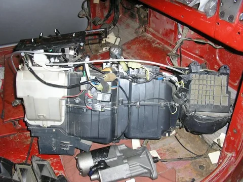

I also grabbed this AC compressor from an 88 4WD Toyota pickup - four bolts held it to the bracket - 7 bolts held the bracket to the 22RE!! I actually removed the ENTIRE hvac system.
The rest of the HVAC
Condenser
Evaporator/ blower/ heater core / dryer and all control cables, wiring harness, ductwork and pressure lines. I could go with Nostalgic Air or something like it but I found this system in a truck at the wreckers and for a hundred bucks I'll take a stab at fitting it under the dash. It didn't look this big when I decided to pull it and once I had it out I almost left it there. Once I got it home and into the cab I think it could work. Worst case I'll engineer my own housings and just use the components (evaporator and heater core).

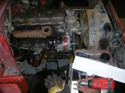

As I mentioned somewhere above I am going to completely mock up the engine bay/ front clip as well as the cab interior before I tear down for final coatings etc. To that end I need to mount all the accessories
I've got an issue with the alternator pulley not lining up - this is with factory brackets so what's wrong?? Doesn't really matter as I still have a York and my AC compressor to fit in somewhere so I see a custom bracket in my future, I will likely have to move it anyway.

Also, I thought of doing the same thing for the AC. I would have built my own housing etc.
After much thought, up here I would use the AC one month of the year.
I did however rebuild my heater :)

That alternator pulley angle is wierd. It looks like the same setup we've got, but ours lines up. I'll compare those pics to ours when I'm up in the shop tomorrow. I like the York idea (a lot, I think I've got room to fit one in my 45--I've also got a 210 that is in beautiful shape). Between the PS, the York, and the A/C you're going to have a LOT of stuff going on at the front of your motor!

Two battery brackets, turbo and intercooler also:confused: - we'll see if I can make it all fit under the hood :meh: I don't want to give up anything either. I will most likely make a custom bracket for the alternator/york/AC combo all together. There are lots of mounting points on that side of the motor to use. Probly stall the 3B on a hot night turning left blowing my air horns :hillbilly:
Well I have no photo proof but I have made contact with the local Garrett turbo dealer and am about to pull the trigger on a new turbo. I am investigating just what material is best for a custom header to mount it on. The york or the A/C has to go so I am leaning toward the A/C because I think I used the A/C like four times last summer in the corolla and I plan on going topless sometimes.
I have mounted the PS and Alt with battery brackets, rad mount and shroud and just can't make room for both York and A/C without moving the Alt and PS pump which at this time seems like too much work.
I solved the issue with the Alt pulley not lining up - the pulley on the Alt is the wrong one - the right one has a spacer built in the moves the V forward a bit. So I need to get the other one.
I am going to get the stock A/C third crank pulley and tensioner to run the York and also change the clutch on the York to the wider belt type. Custom bracket needs to be fabbed for the York too.

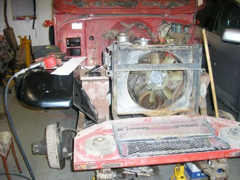

With the fender, rad support, apron, air cleaner housing etc. set in place the gobs of room suddenly disappears :eek:
As most of you will know that is the stock exhaust manifold flipped - It will be replaced by a custom header I am building to mate to the T3/T4 turbo I have the local Garrett dealer making for me. I should get it some time next week. Once I have it I can complete the header fab. I have also ordered a cheap intercooler and piping kit from some online e-bay dealer. I'm sure the quality is suspect but even if I toss the cooler I came ahead just on the tubing compared to buying from the local speed shops.

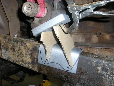

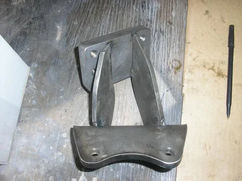

Power steering box braket fab...
So I attached the box to the column and supported it where it "wanted" to be. I made up an angle plate at work measuring 3/8" thick x 6" long with flanges 2-3/8" x 3-1/8" OD (2 and 2-3/4 ID) for the frame end of the bracket. This represents the same size as the original manual steering box bracket. I also made a 3/4" thick plate measuring 2-3/4" x 4-1/4" for the box to bolt to. I drilled and tapped the plate with M10x1.25 thread to match the box foot pattern. I don't show it here but I loosely installed the fender to make sure the box would clear - it is very close but no alteration of the OEM fender is required.
I mocked up some cardboard elements to take to work and replicate. What you see here is exactly what I brought home cut from 1/4" plate. After some grinding and fitting I decided at the last minute to install the pitman arm and found my gussets interfered with the swing of the arm and had to cut them down quite a bit.
Tacked up and ready for welding
