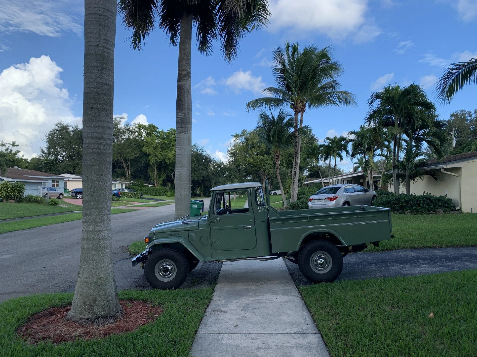

I just bought a restored 1978 HJ45 and the 2WD stopped working. All of the 4WD options work but when I shift the 4WD back to neutral then the gear won’t engage as shift through them. I can also shift to gear and take my foot off the clutch and the car won’t stall.
