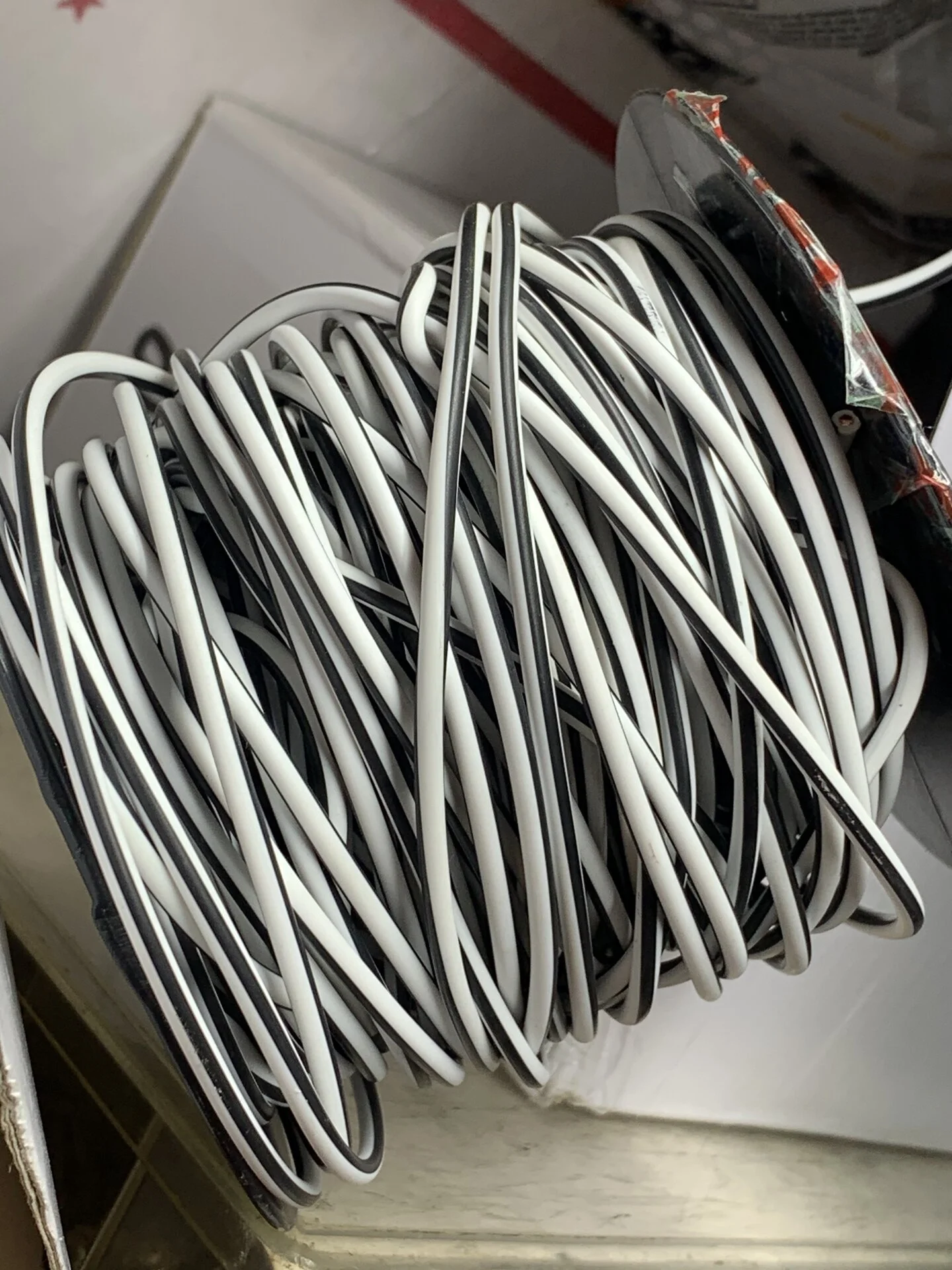

the cheezy usa-spec. ones rely on the threaded post and its large Hex nut and spring washer for the NEG- Ground Circuit signal , on each side of your 1978 FJ40 running among the aprons there is a white wire w/ black tracer stripe , they DO NOT run as far past the coil and igniter , and the VACUUM VSV emissions box , but never the less you can reply on them , add on to them , using the same Toyota color code wire , and feed dedicated home-run ground wires to each new lamp ....

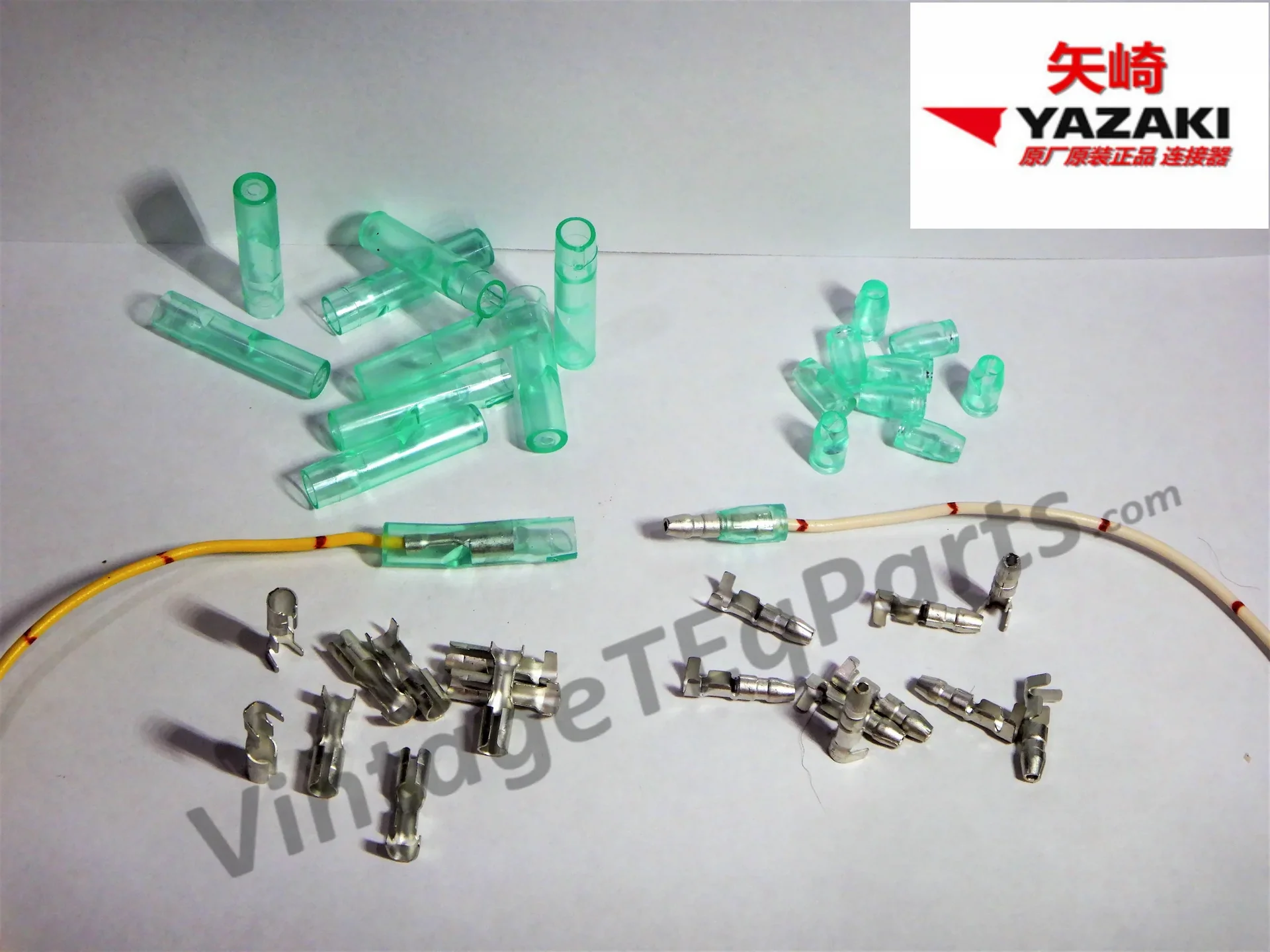

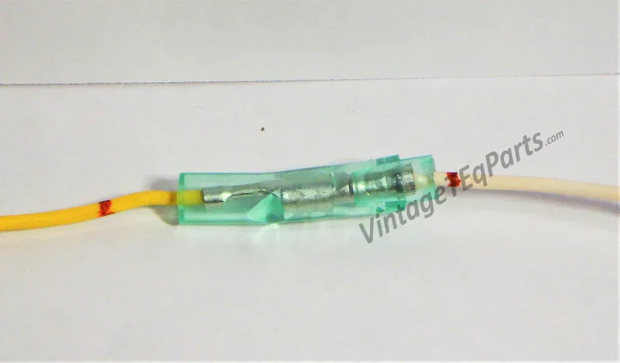

the link below has enough OEM male and female bullet connectors to refresh all your old 1978 harness side ones and also ADD the new needed ground wire circuits chassis harness side too ....
- if you make sure to ADD to the NOTES , during check out : simply say " Remember 10 feet Ground Wire "
- ill spin you off 10 feet of the 16ga OEM yazaki ground circuit wire and include it in your box , no problem :)
- matt
