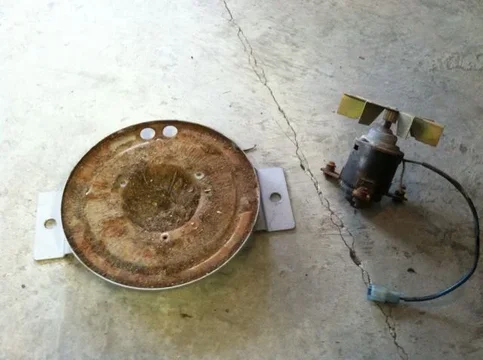

Wow, the more you start getting into the smaller stuff, the more you find you "need" to do. I disassembled the rear heater assembly and realized it needed painting. I surfed posts here for weeks to determine the best color code and paint. I finally went with my local powder coater and used a silver-gray that is a very close match to OEM. With that decision, I then "had" to disassemble the instrument cluster as well and get everything (pocket door, ash tray cover, center console, instrument cluster face, seat backs, rear heater, visor mounts, license plate light covers, and fuel filler cover) powder coated together.

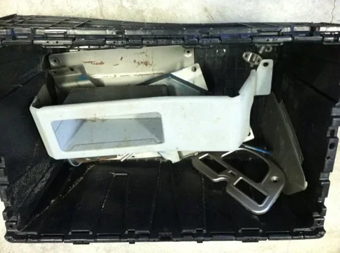

Now that I'm powder coating the pewter-colored items, I have to powder coat the black items as well. Amongst the numerous black items is the front heater assembly. Disassembling the heater reveals why my heater and defroster only blew out hot dust and disintegrated foam particles. I just can't leave well enough alone and end up disassembling the rear jump seats and front buckets, too.

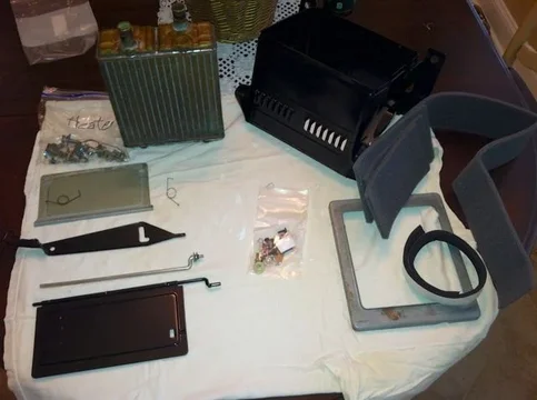

Assembling the front heater with the rebuild kit, powder-coated housing, and cleaned core.

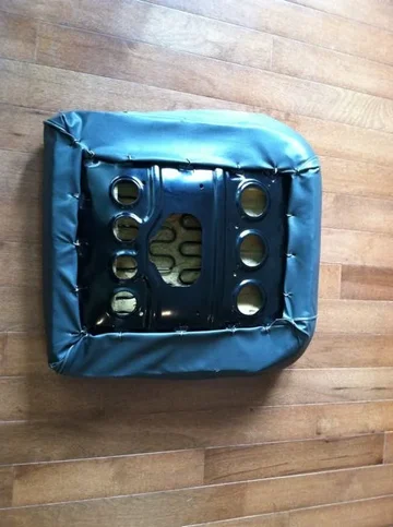

I was able to reuse the original foam, but here is the seat with powder-coated frame and new hog rings. I've since discovered that the seat cover is not original, but replacing that is a project for another year.

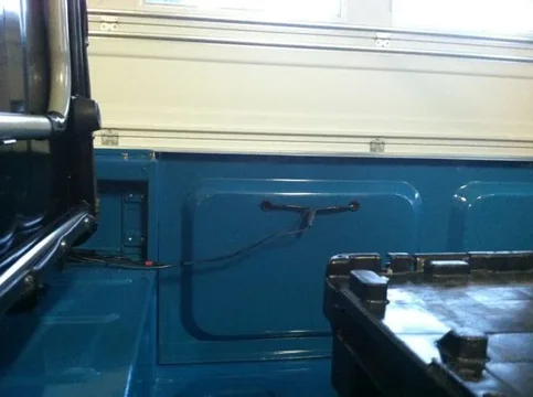

Give me your take on the Real Steel Tailgate. Do have an interior pic? A pic from the top? Is it pretty stout if you push against it?
The inside looks like the outside. It's a pressed panel with a lip on the top. If I could do it again I might have them not attach the mounting "ears" and instead drill it to use my ambulance door hinges. I drilled two holes for the license plate lighting and with new grommets used my original license plate assembly.
