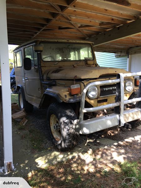

I bought a 1978 40 series land cruiser that I am going to restore.
It has a B engine. So it will probably end up with a V8

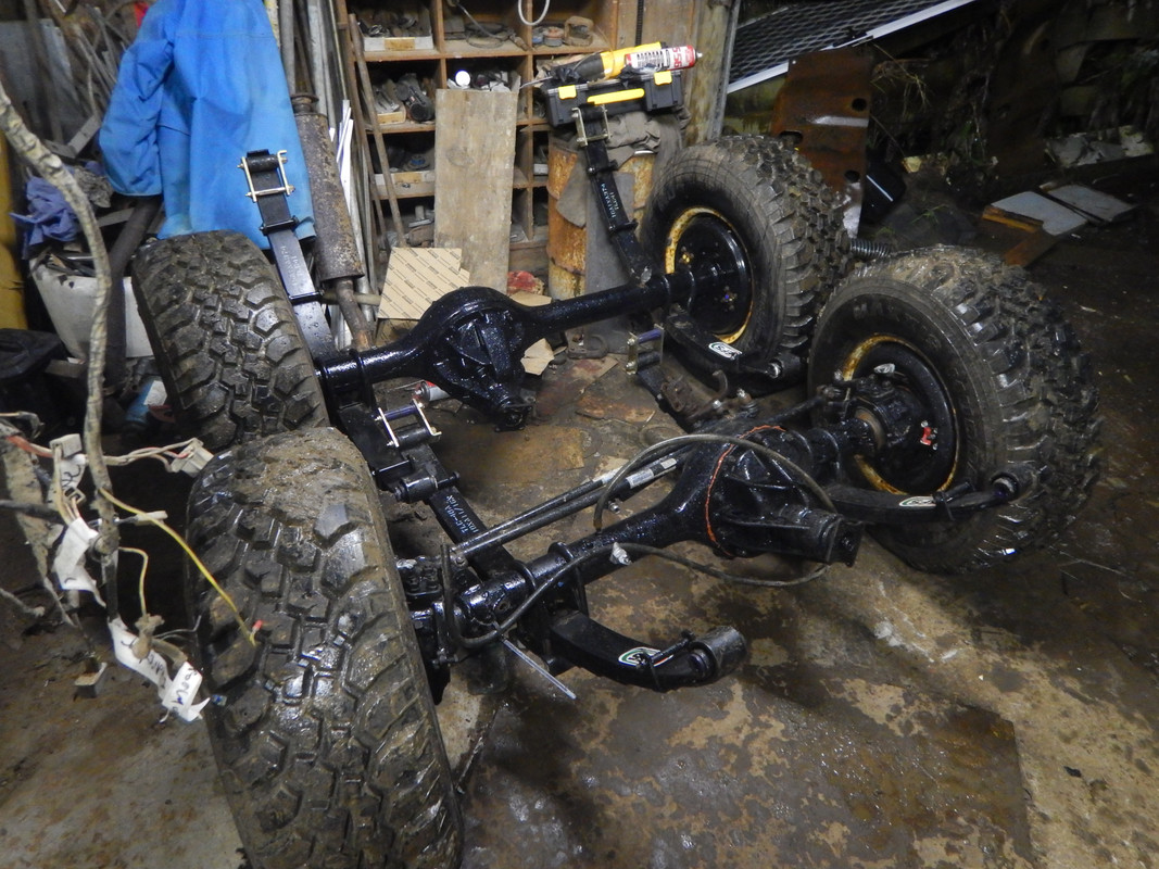

I started by getting the axles sand blasted and painted, replaced all the bearings. And bought new 2" lift leaf springs, shocks, steering arms, brake cylinders and brake shoes.

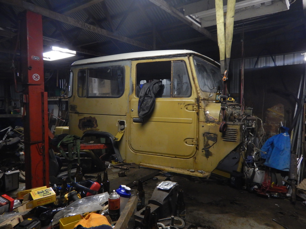

Next the cab came off.
Then i took the engine out and took chassis to the sand blasters. I would have had it galvanised but i don't trust the forklift drivers at the galvanisers. Ive seen how rough they are throwing around trailers.

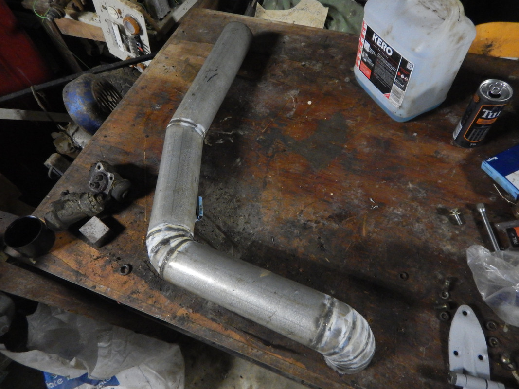

Started work on a new snorkel, made from lobster back cut tube.

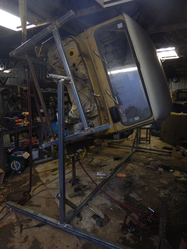

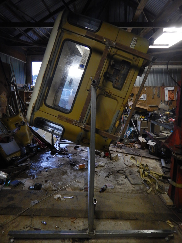

Next job is to put the cab on a rotisserie.

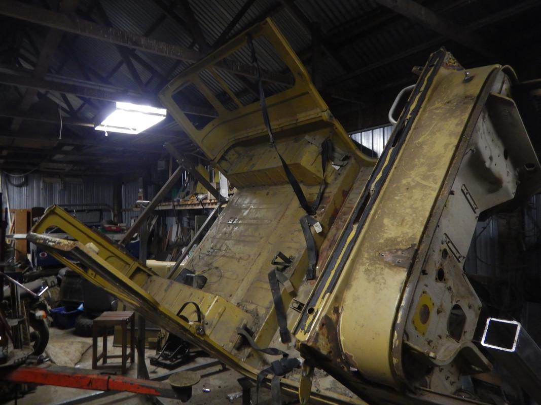

Ive got the cab spinning on the rotisserie. The centre of gravity is too low so it gets a bit heavy when you spin it past 90 deg. But Ive got heaps of adjustment to fix that.
The box section frame that bolts to the body mounts twist a bit under the weight .But it doesn't damage the body mounts.
Why you didn’t took the roof/doors/windows off first? You could get maybe 40% weight off.

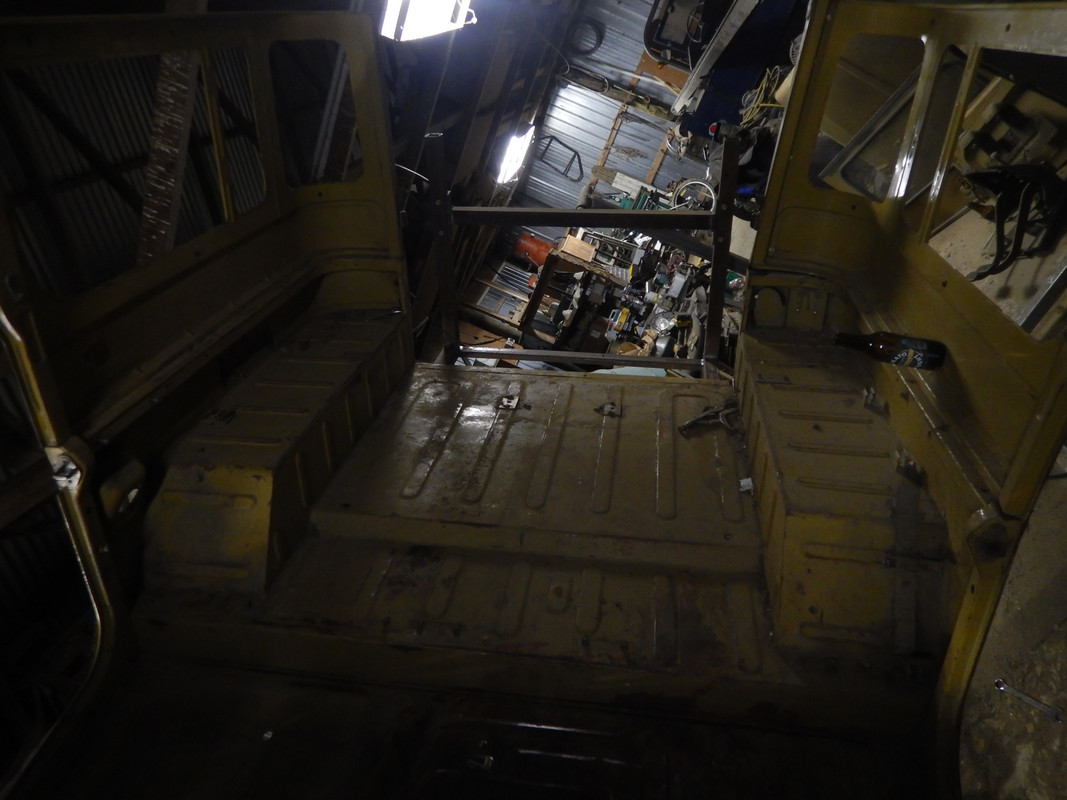

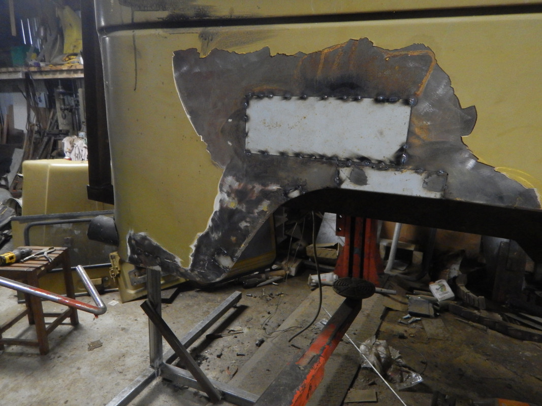

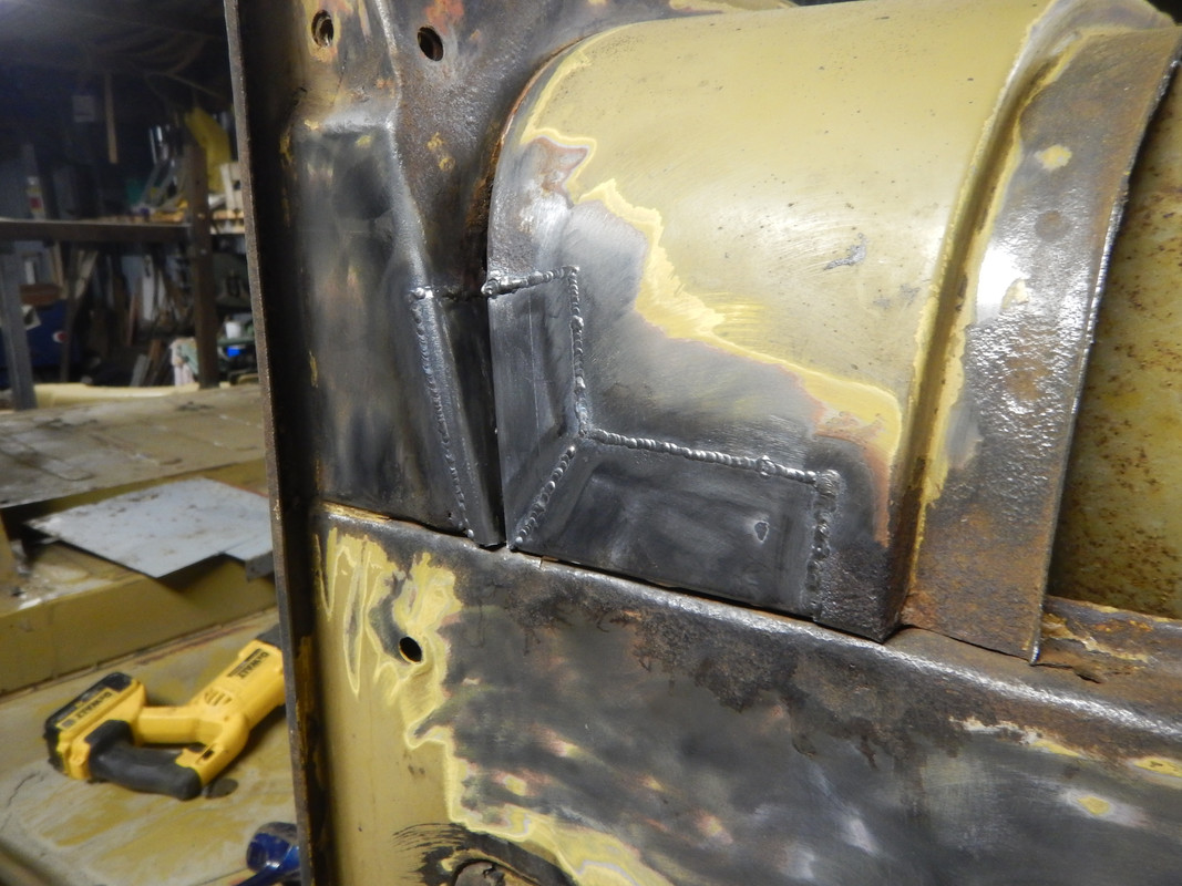

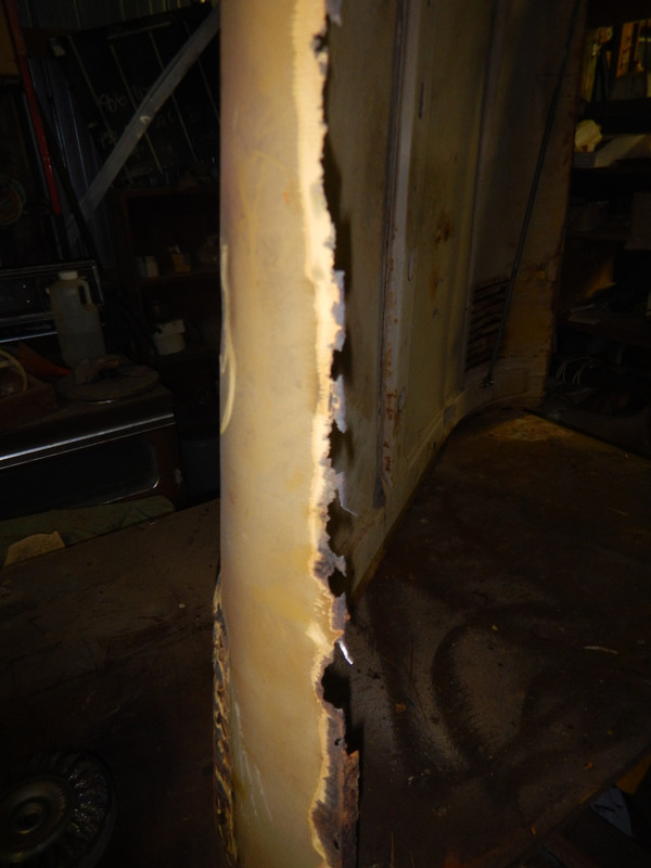

The rust isn't too bad, it will take a few patches but i don't think ill have to replace anything.

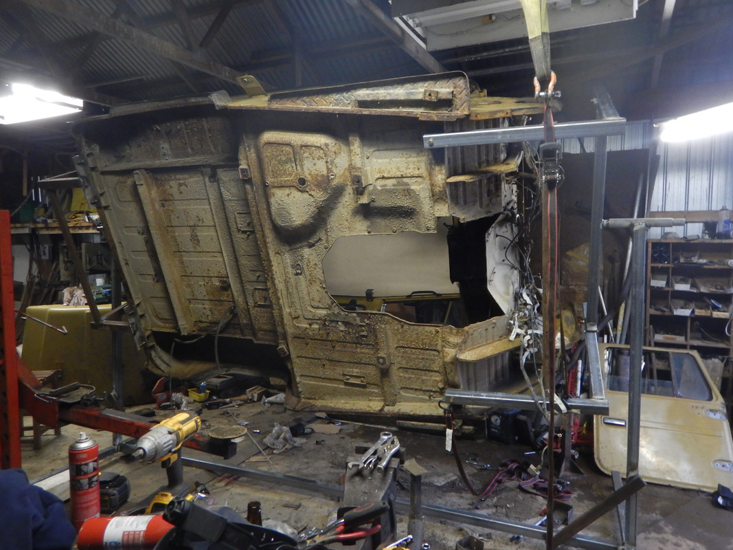

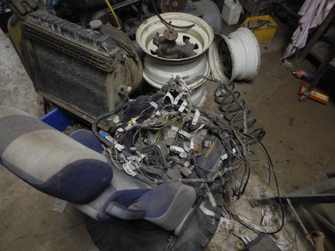

Pulled off the roof, the wind screen and all the wiring its almost ready for a new coat of paint. I'm going to paint it myself so i don't feel bad when i scrape it off against a tree. I cant get those last 2 bits off the tub they are stuck on so well with sealant ill damage them pulling them off.
The rotisserie works awesome you can spin any part up to perfect working height.

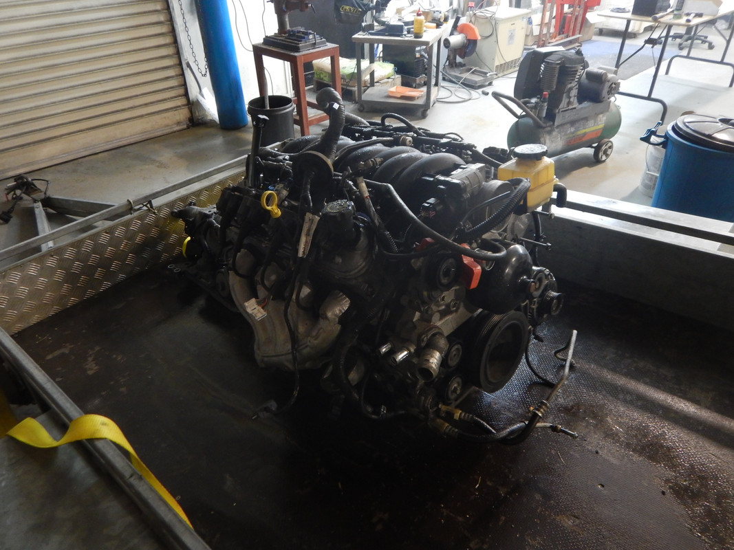

Ive bought a 5.7L LS1 from a Holden Commodore so all i need is a H55 gearbox and a bell housing and she can start going back together.

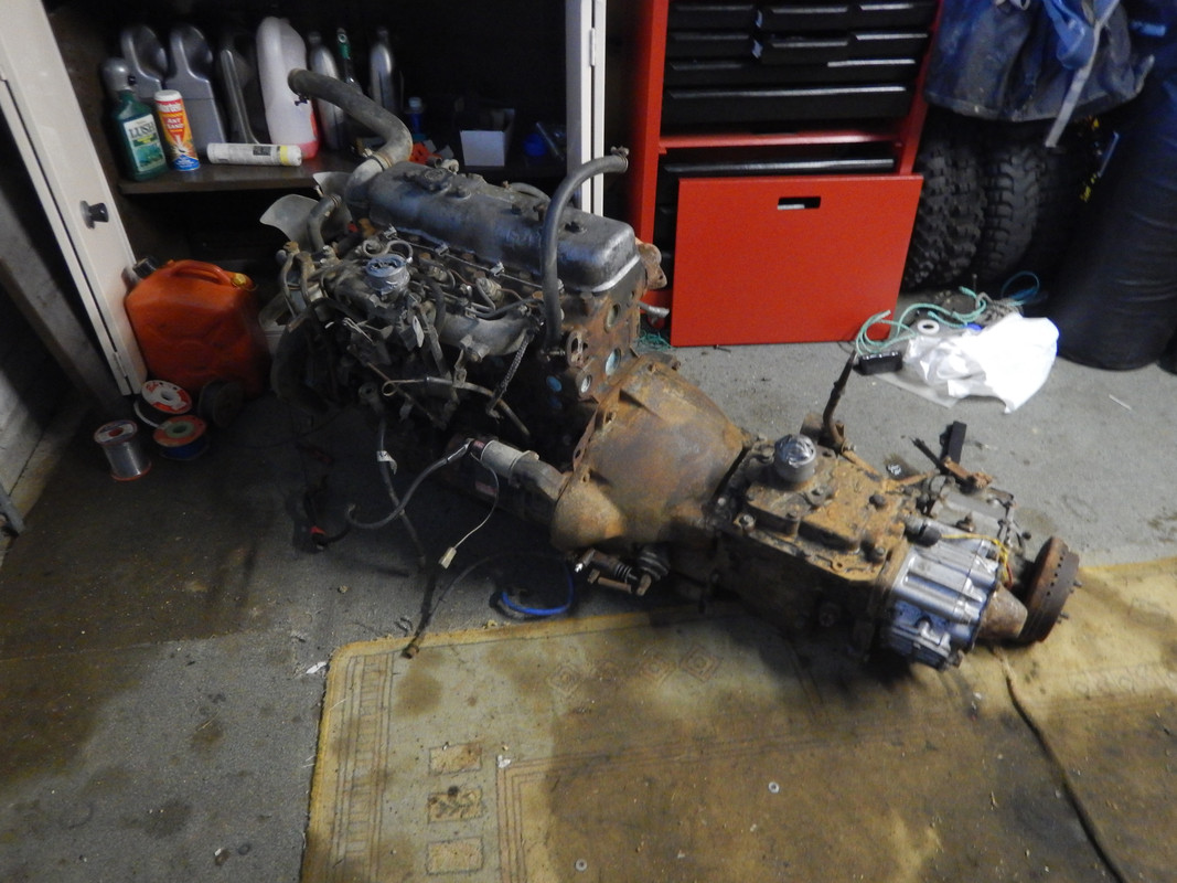

Picked up the engine. and found an h55 gearbox but its from a diesel so ill need to change the input shaft and find a bell housing to fit it up with the adapter kit.
No buggering around here! Into it!
Have a good look at that gearbox input shaft when you pull it out - should be a good indicator of how worn the box is - way easier to give it a re-co at this point if it needs it.

Will do. apparently its in good condition doesn't wine or jump out if gear, but the transfer case is knackered so it might need replacing or reconditioning. im not looking forward to sorting out the wiring, but Ive got a mate whos done a few LS conversions.

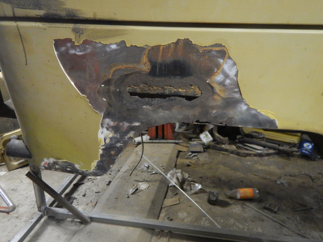

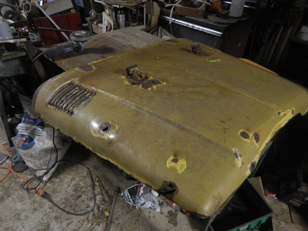

Not sure if i should fix this bonnet or just replace it
Ill probably repair it, save a bit of cash.
I've got a spare set of transfer case gears + intermediate shaft if you want them, (1990 split case) Took them out when I rebuilt mine with the Mark's Adapters low range gears. Used a Terrain Tamer bearing kit which has given no problems.
Good luck with the bonnet, looks like you've got the welding skillz to rebuild it. Getting the louvres right could be technical though!
