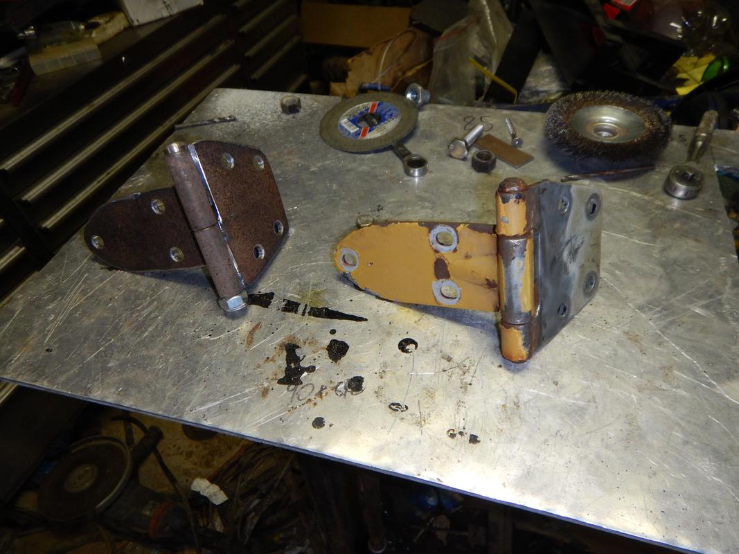

I started making some new door hinges, so when its got the soft top on and i want the doors off its just a matter of undoing the door stops and 4 nylocks.
