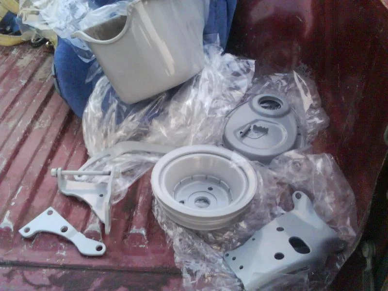

I picked up a few engine parts from my powder coater today you are going to think i am crazy. I am going for the sleeper look. Infact i thought about flat black for the tub. My main objective is for it to be super clean and stay that way for a long time. I like the way all my powder coated stuff has stayed clean in the past. I dont want the Bling Bling effect!! So i asked a friend what color should i have the bits and peaces done in and he joked and said primer grey.
So............
I am still beating myself up between 4x4labs which is SWEET but spendy and Marlin and Downey which are also nice.
Just for an FYI since sometimes people wonder it cost me 80.00 to have that stuff coated and the color name was PRIMER GREY LOL not that you will want to copy that

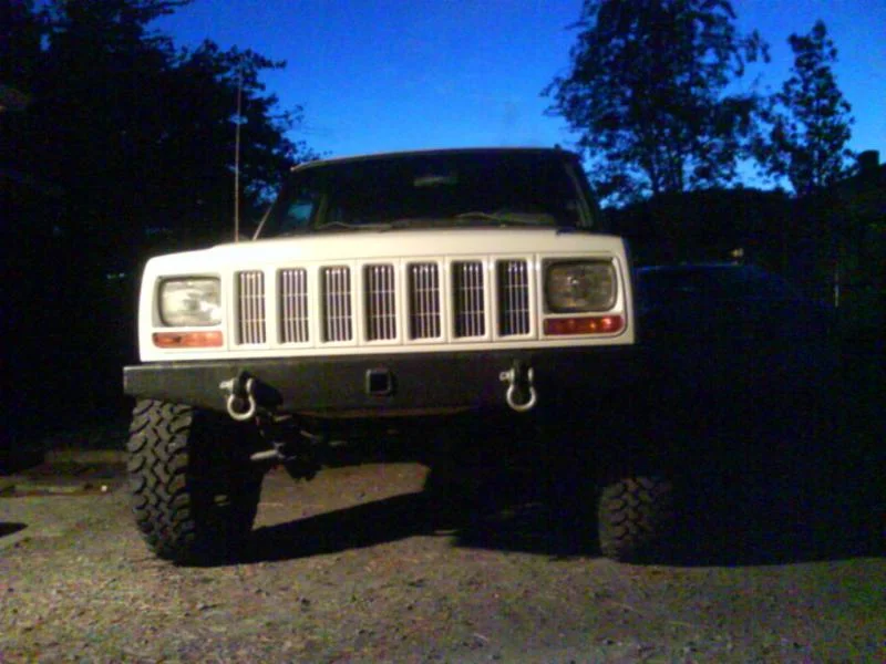

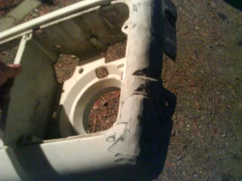

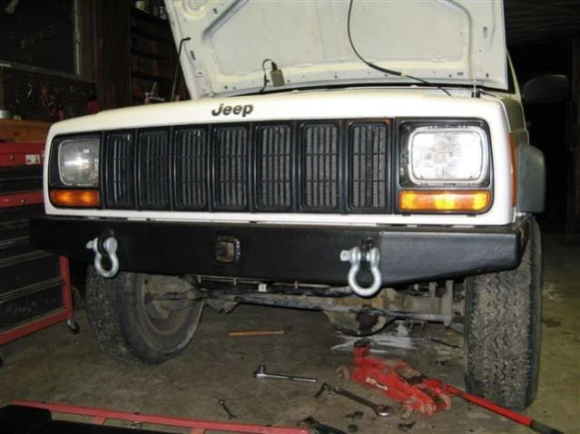

Not quite cruiser parts but this is what has been slowing down my build:
Before pics
After my oops! Stick on a gravel road pointing back at me and i speared it at about 15-20 mph!
After four months of searching for a header panel i finally just bought one from jeep for 330.00 :eek: Luckily i have a painter friend that we swap work so thanks to him and an evening of painting my cherokee is back on the road (still need to order a new turn signal lense)
Now I can focus my efforts back to the FJ
Also FYI to OrangeFJ the Marlin High Steer kit showed up and looks great!!! Thanks
