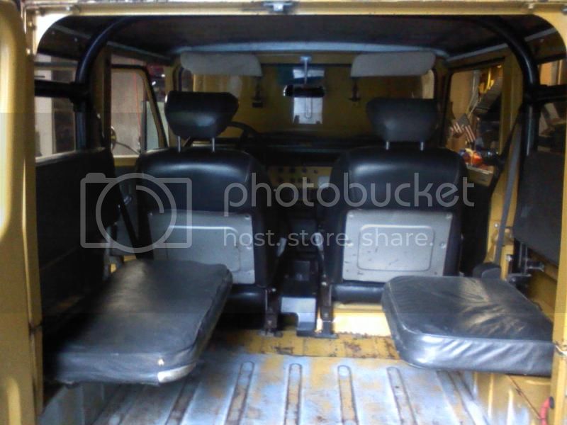

Put in jump seats today. Need to track down some seat belts now.

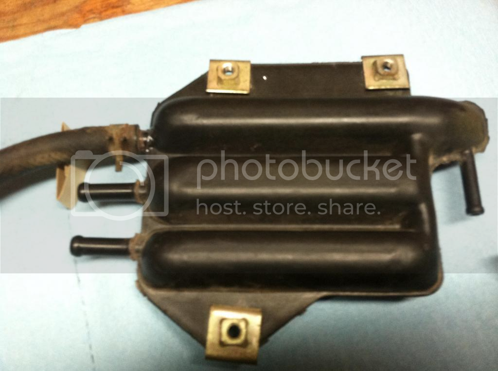

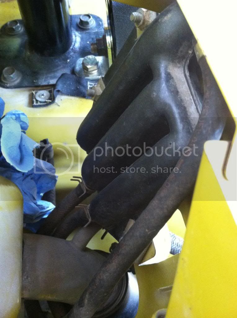

Got around to addressing the strong fuel smell that occurs during fueling and taking corners with a full tank. I took off the metal shield for the fuel filler neck and found that one of the breather hoses from the tank had broken away from the evaporator and took the fitting with it.
Looked into getting a new one from Toyota but it's not produced anymore. I tried a JB Weld fix, but I might have to track down a used one if it doesn't hold up.

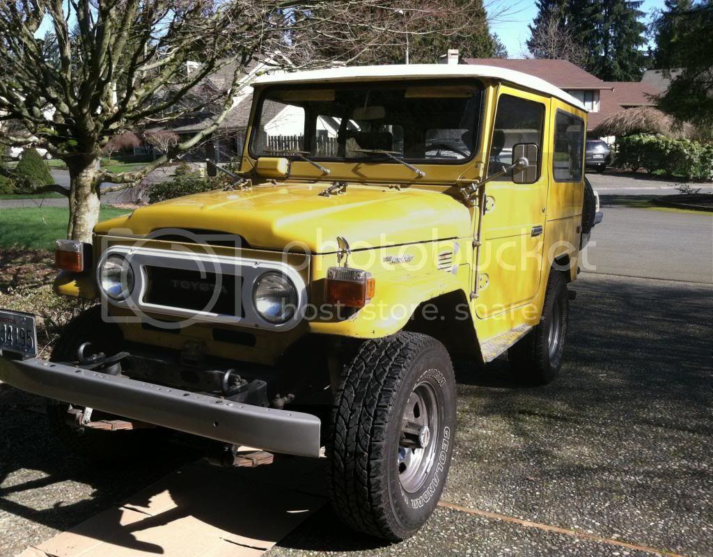

New front bumper and a bezel repaint from black to white to match the top. Paint was Dupli-Color BFM0335 Ford Performance White. I tried several colors before I got a good enough match. My top isn't cygnus white so I tried to get close with something else, and it turned out good.
Also installed windshield mounted rectangular mirrors from an earlier 40 Series. The new telescoping arms didn't quite line up under the windshield hinge (earlier 40s had smaller hinges I think) so I had to grind about an 1/8" the top corner of each.

Beautiful! That Bezel repaint just took your rig to a whole new level of beauty! Now to change your Avitar :-)
Yeah good point, the old one might have to go.:)
Looking good, Tony!
Thanks Chad! Hope to see your rig at the meeting tomorrow. I still haven't had a chance to check it out in the daylight.

yup, been there, done that - any fuel hose with the same diameter from the auto parts store will do :cheers:
