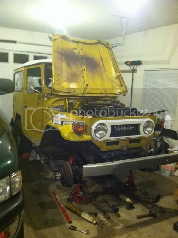

Started the suspension install this weekend. Ran into a couple issues that I hope to resolve the week and get it all done next weekend.

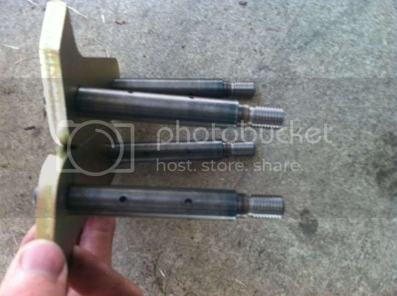

Some of the small pin alignment bolts on the spring pin plate at the front/rear frame mounts are bent and came out pretty rough. Regardless of that the bolts are too long and would interfere with the new OME spring eye wrap, which is wider at that point. Seems like small set bolts that are the right length would be really easy to include in the new pin kit from OME, but shouldn't be hard to find at the store.

Finished the install this weekend. Looks and rides much better. 4* shims installed in the rear for the driveline angle, and new u-joints next week and we'll see if the vibe goes away. Rear t-case u-joint was on it's way out and ratchet strapping the axle into place with the joint at it's angular limit probably wasn't good either. I think I will add some 2.5* shims up front. The caster was just on the positive side of 0* and should be at least 1* but I've read 2-3* is better, even without PS.
