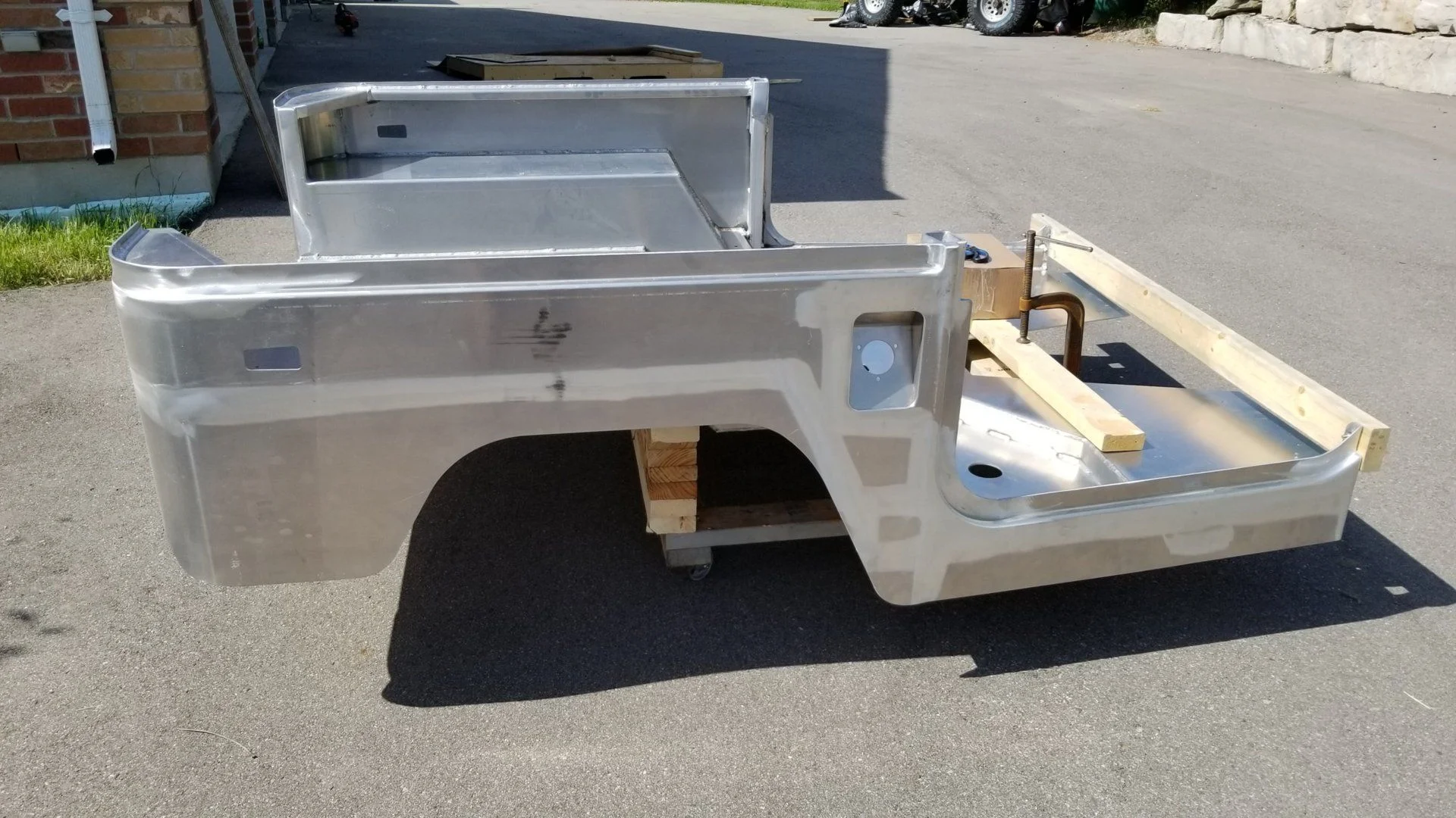

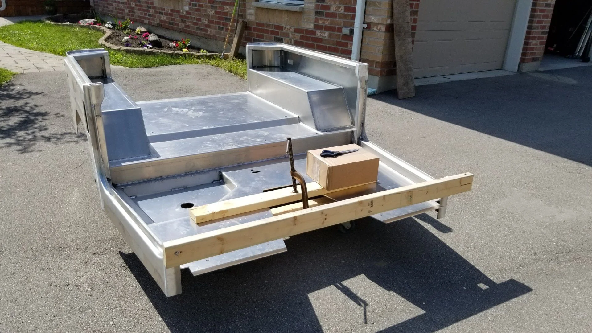

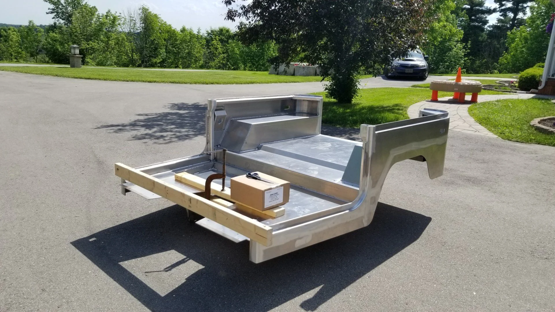

Aqualu tub arrived today!
I just bought a 74 two weeks ago and I'm looking forward to getting started on the restore. Like you, I plan to go as close to stock as possible minus some safety and performance enhancements. I've been looking at the Aqualu tubs but won't make a decision until I media blast my old tub. I'm looking forward to your feedback on how the aluminum tub works out for you. This is my first restore so this is going to be a learning experience - which I am looking forward to. I'll be watching for your lessons learned as you make progress (which seems things are moving along nicely).
-Jason

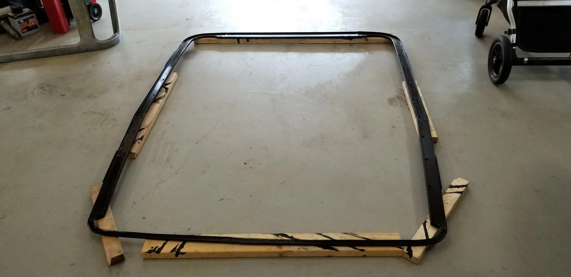

Tub off the crate and onto a dolly. Tonight I hope to mount the sides and windshield temporarily. THen I can lay the metal roof rails all bolted to the body in the correct places, weld the roof metal pieces into one unit, lay the roof on top and trim to fit!

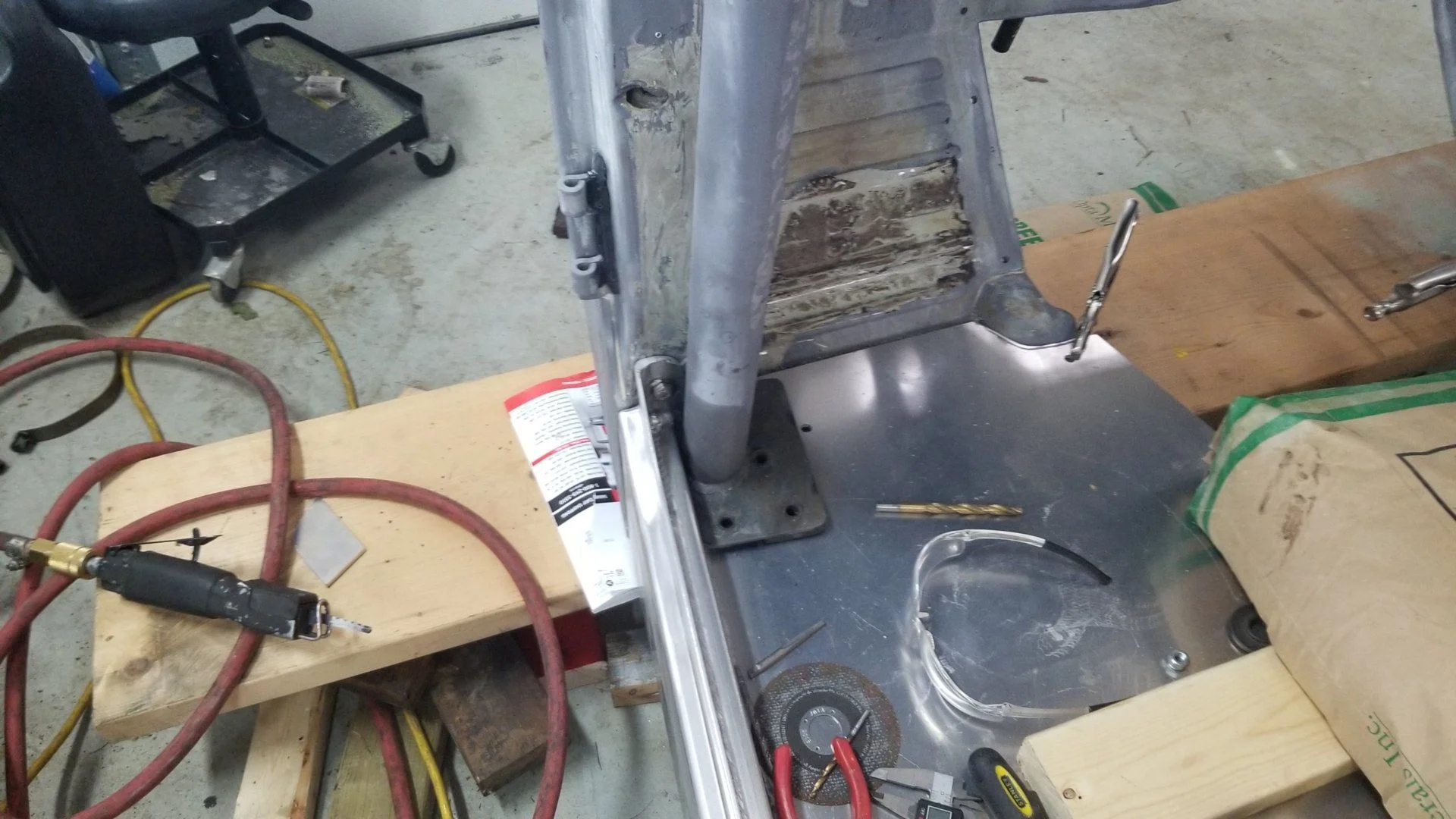

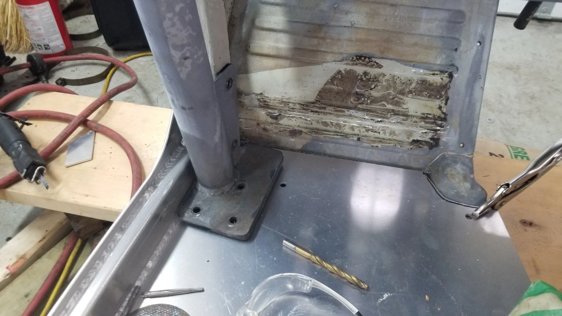

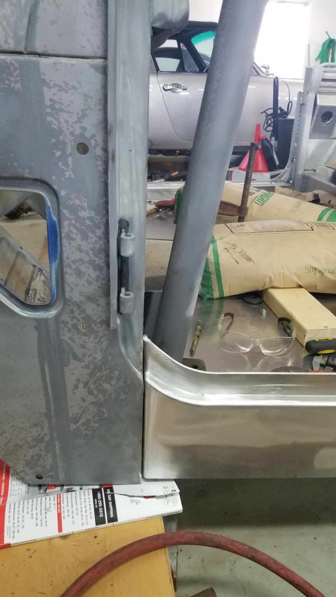

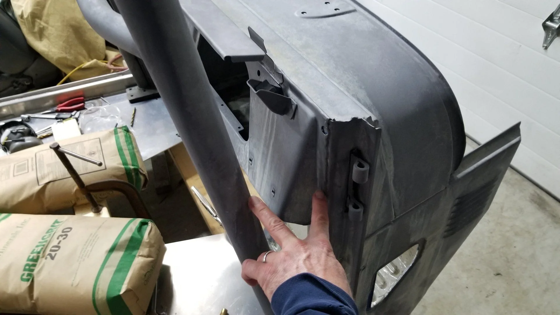

I prepped and fitted up the cowl and placed the cage in its final spot.
So is it OK to POR15 the steel sections where they overlap the aluminum tub? Sika adhesive is what Aqualu sent wth the tub, but checking if sika and POR15 are compatible?
Also, is it common practice to brace the cowl to the roll cage? It seems the body rigidity could be improved with a gusset here?
Also anyone add braces to tke steps? I am considering adding a couple of legs to support the steps and a ladder brace in back.
No one with comments on gusseting the cowl to the cage?
Last night I reinforced the roof frame with extra gussets and rail reinforcements. A rooftop viewing platform for Mosport is in the works...
I was looking at the pics of your roll cage, before you asked about bracing, and wondering the same thing. I have an Aqualu tub as well. You’re cage foot pic had me wondering about this bracing.
Before I put the replacement tub and roll cage install, my windshield would shake at highway speeds. It was really annoying. After the install, I only get a vibration at the rear view mirror. I’m pretty sure part of the issue in the past was due to bad tires- second hand rollers. I’m running 35” muds now, so that should also cause some vibration.
All this is to say, I don’t think you need to add the bracing. On the other hand, if you’re gonna do a lot of rough driving, it wouldn’t hurt.
I braced my cowl to the cage. I also used the stock tunnel. Make sure you get the front hard door gaps right before you mount/drill holes in cowl to bolt the tub on. Your cage runs pretty close to the door opening make sure hard doors will work with your cage in case you have to modify the front legs. I doubt POR15 will have trouble with silka flex. Look at my build thread below, I was fairly detailed on my aqualu install on my 40. On yours I would also make a second rocker to cowl mounting hole on the bottom of the rocker in addition to the one on the top of the rocker. The side steps have a bolt on factory brace that bolts to the frame. Maybe someone removed yours in the past. It runs out to the bottom of the steps. You may consider running rock rails instead.

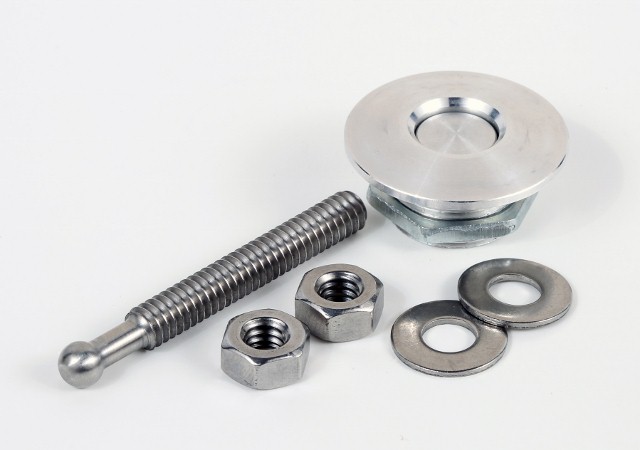

QL-25 Series Mini Quik-Latches
This one is all stainless, .875 inch diameter so should fit on top of the flange with the pins facing upward mounted on the flange of the tub.
I dont know how I found these, maybe others used them. I need to ask the maker if, when pressed, the latch stays "open" and allows for release of the pin, or if you have to hold the button in while removing the pin. If its the latter these wont work, I can have my finger on 10 of these while simultaneously raising the roof!

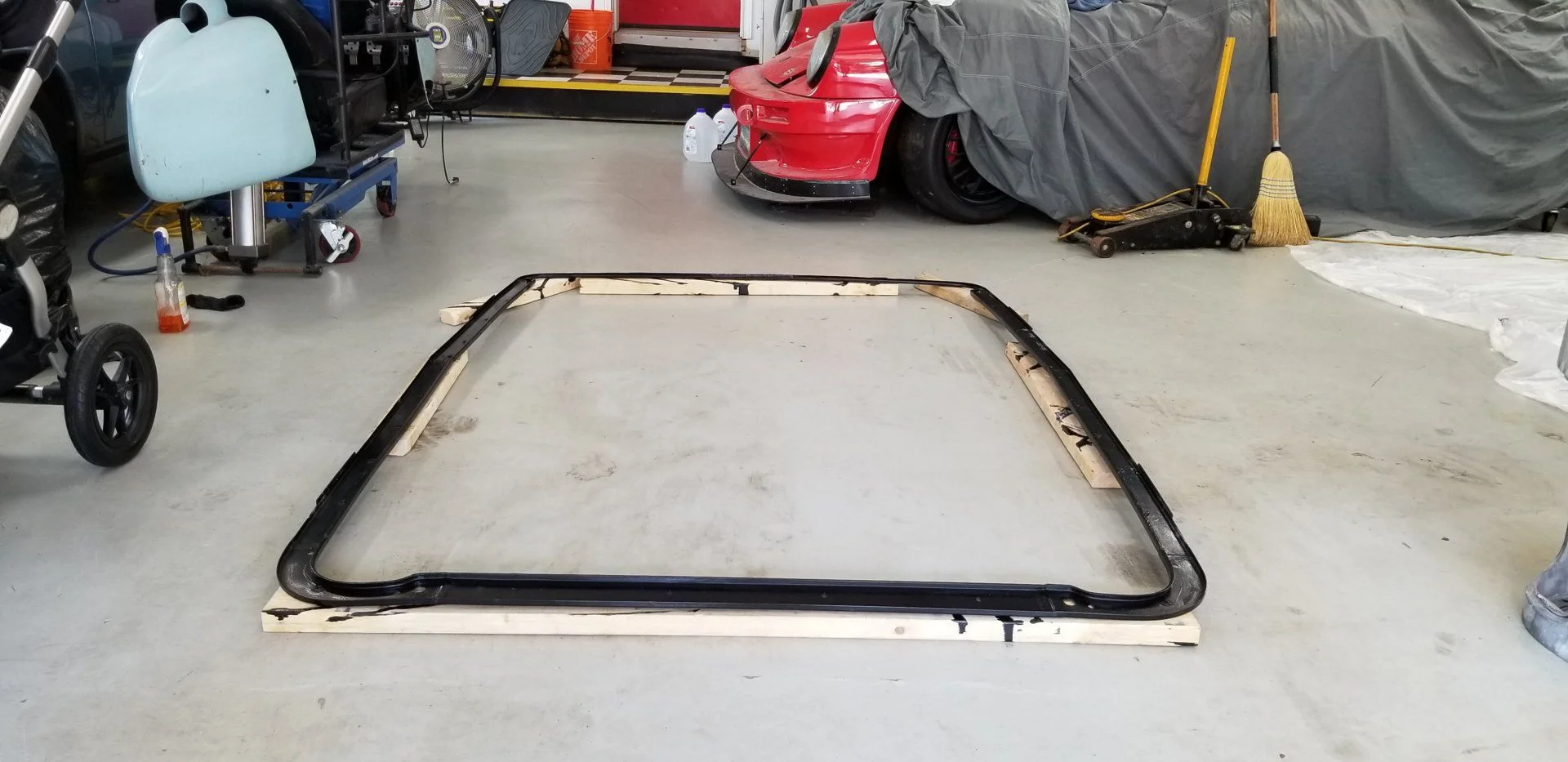

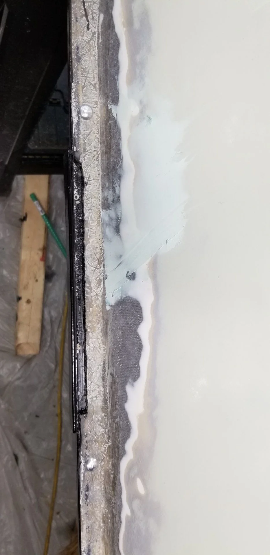

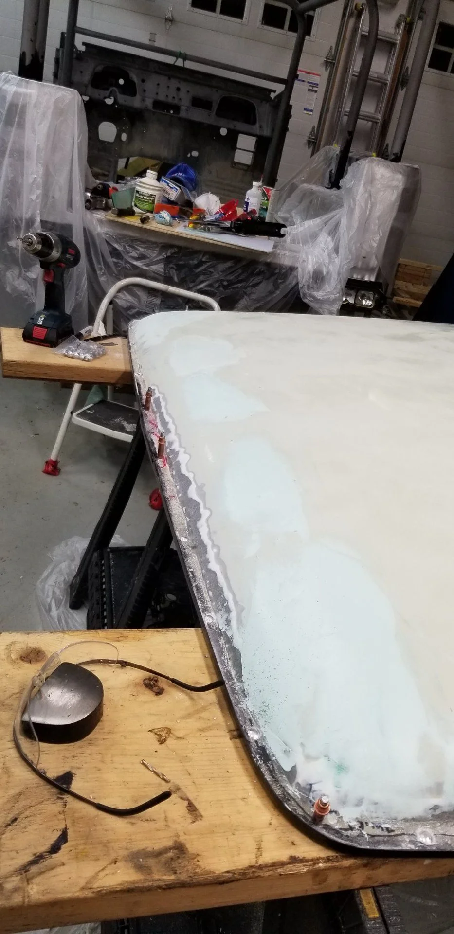

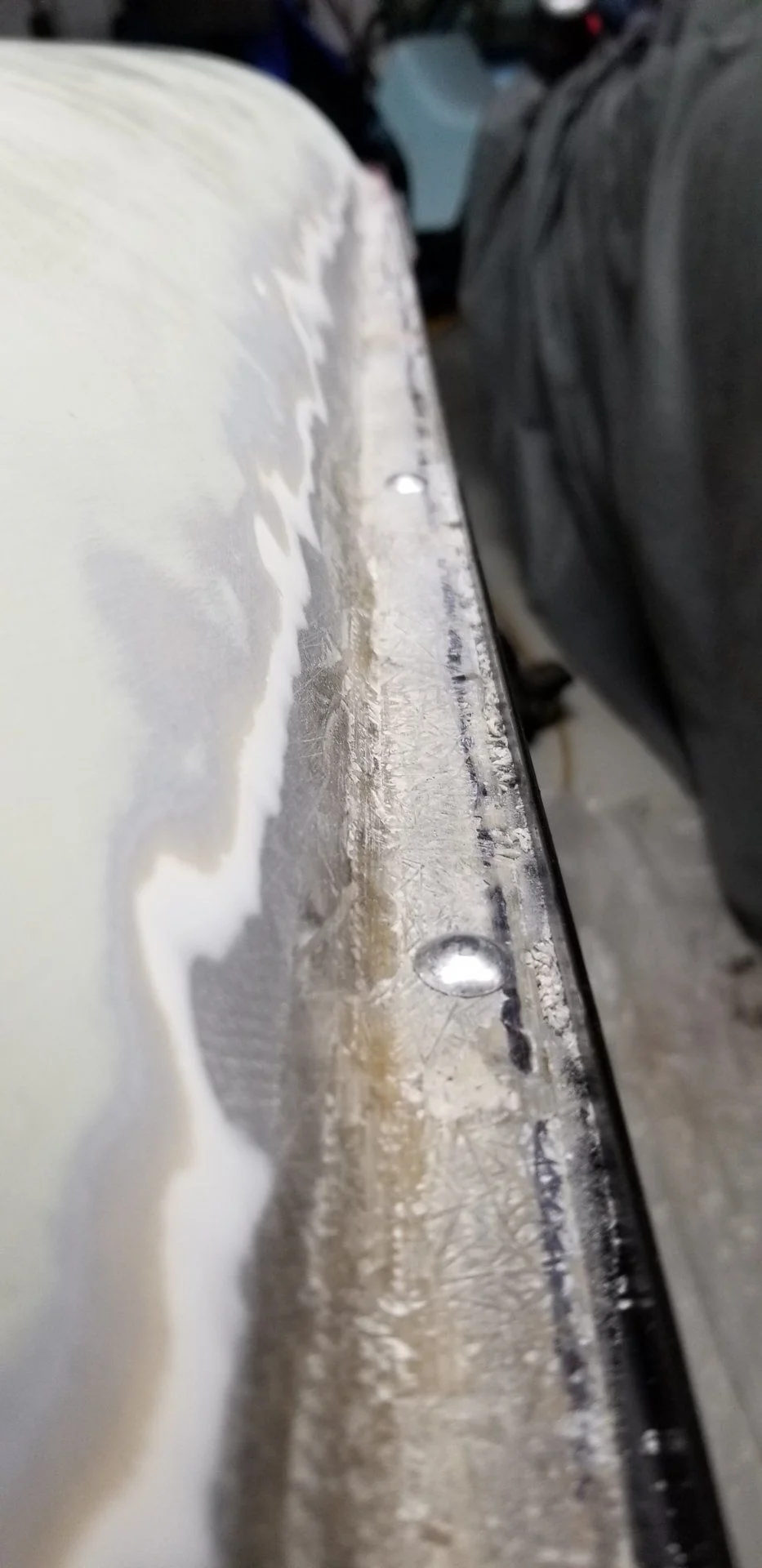

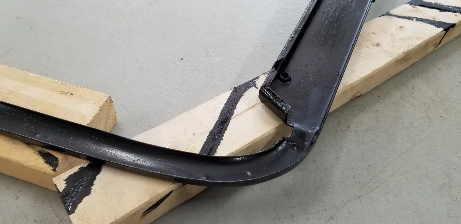

So I made a ton of progress on the roof. In short, I...
- reinforced the roof across the entire span
- Additional material added along the flange, spines and visor
- reinforced the visor mounting strip and replaced the rivets
- all metal is new, with a new frame from CCOT and reinforced in several places, especially 4 mounting points
- at 4 mounting points for roof platform, 3mm angle and steel plate backs the roof frame
- 3 layers of POR 15...to be later POR Tie-coated then finished in Epifranes polyurethane
More notes to come...

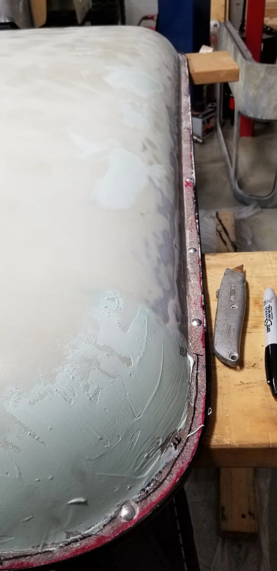

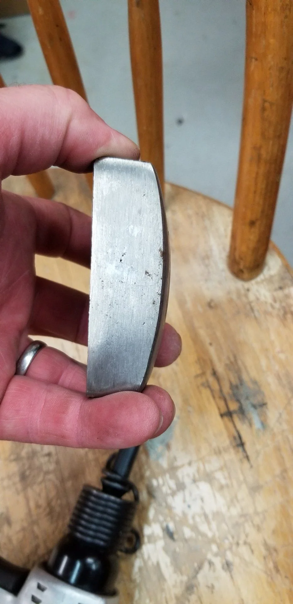

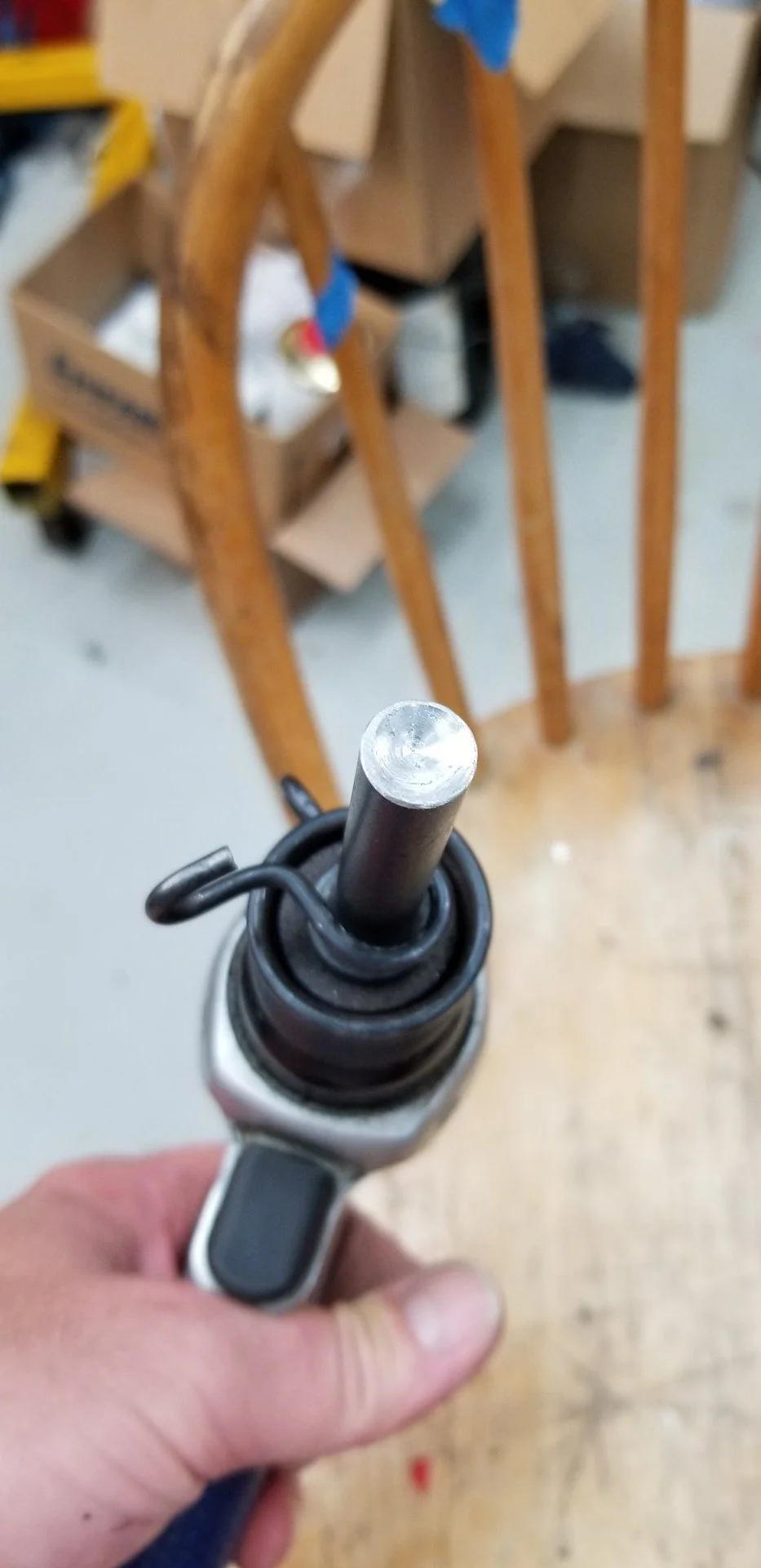

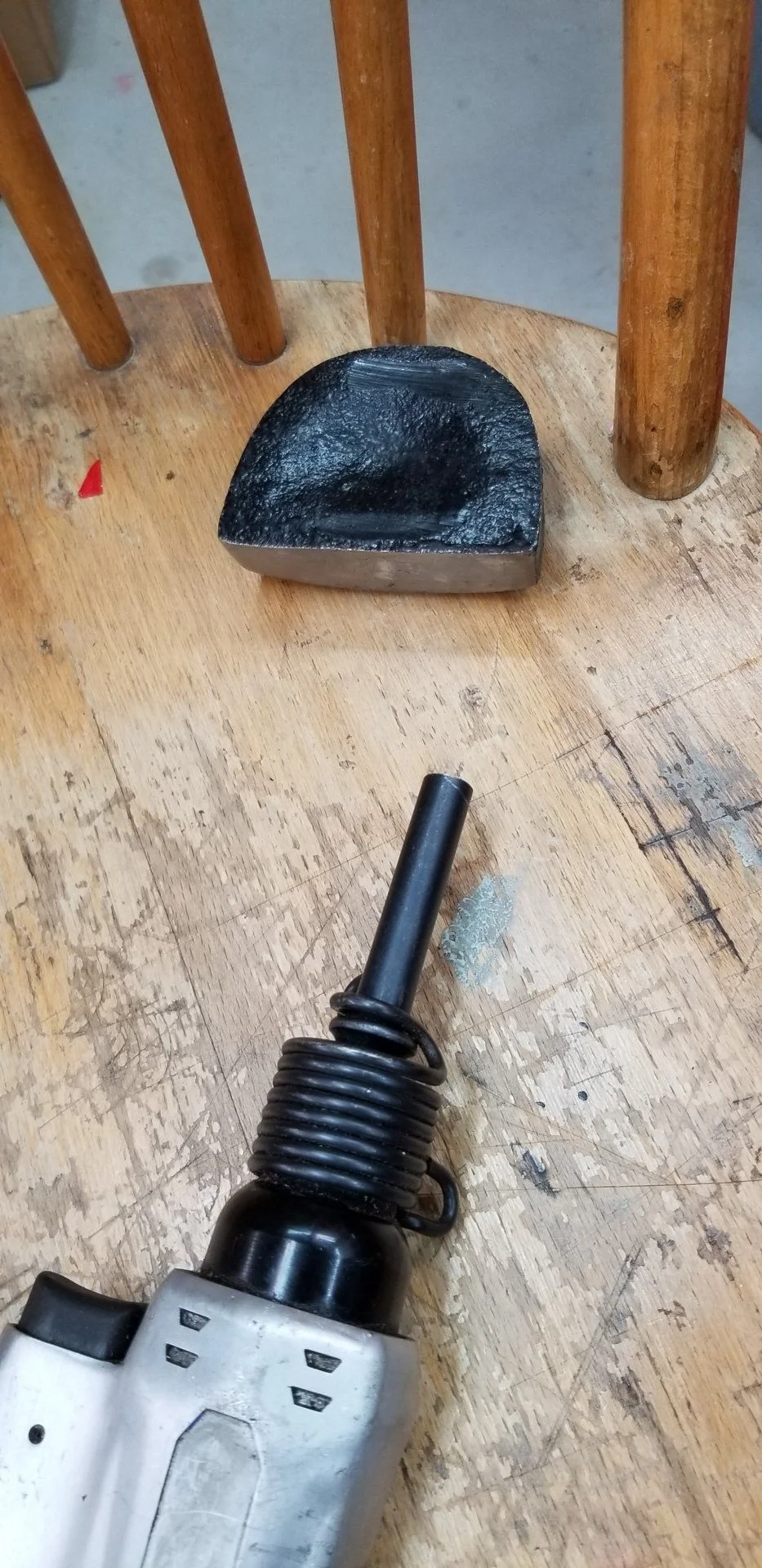

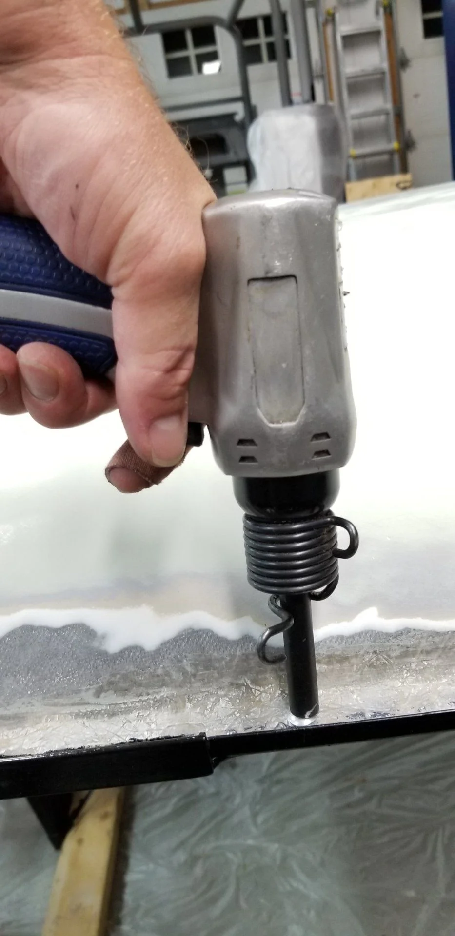

More roof progress. I modified an air hammer chisel and drilled a concave surface. I installed an air valve to turn the hammer way down and used just a normal hand dolly on the bottom flt side. Ie never done this before, I think it worked great.
