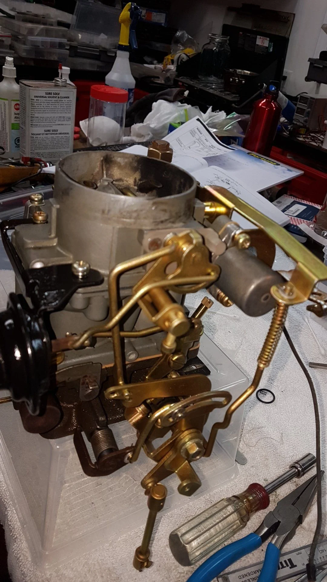

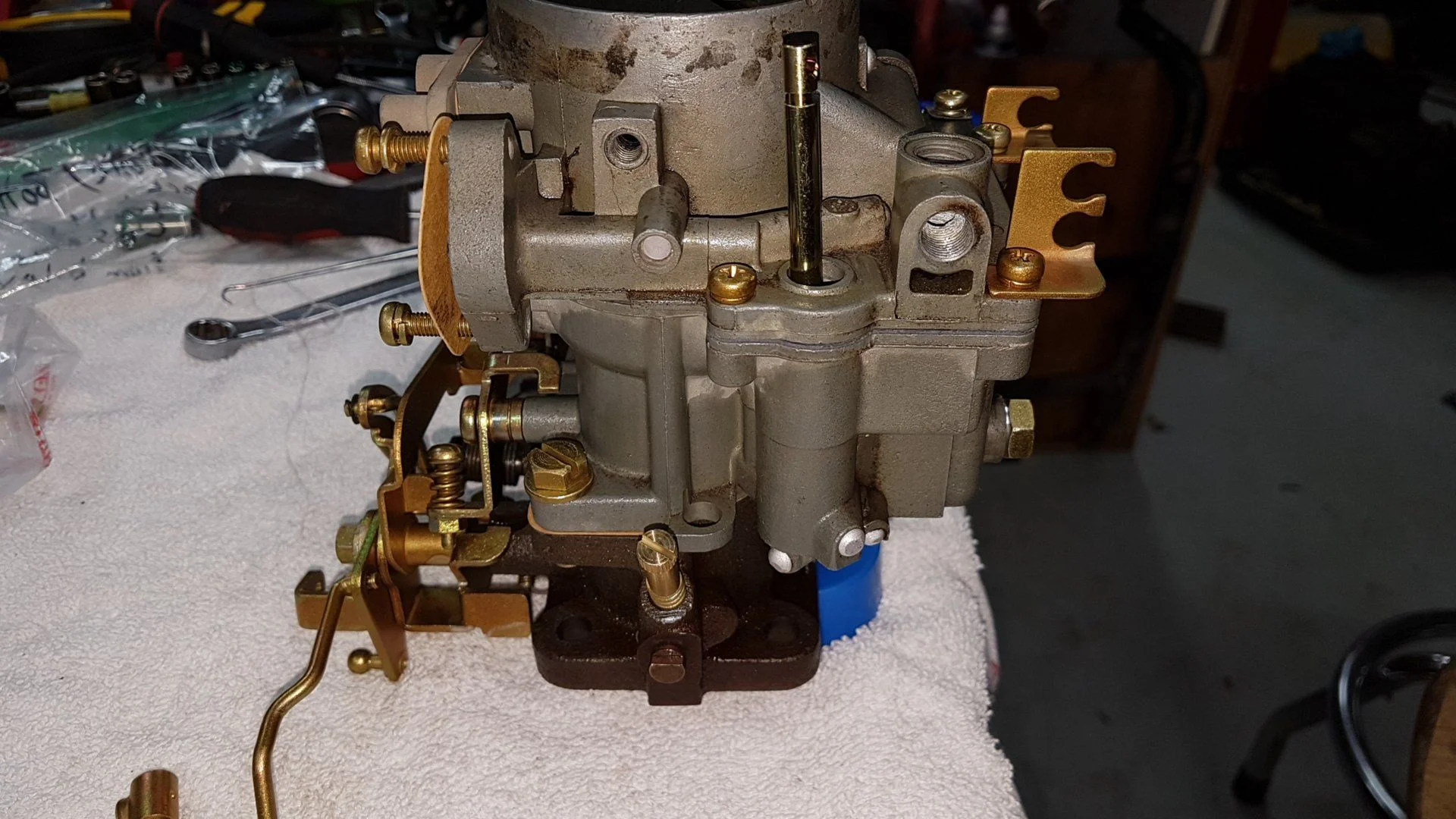

Here is the carb all done.

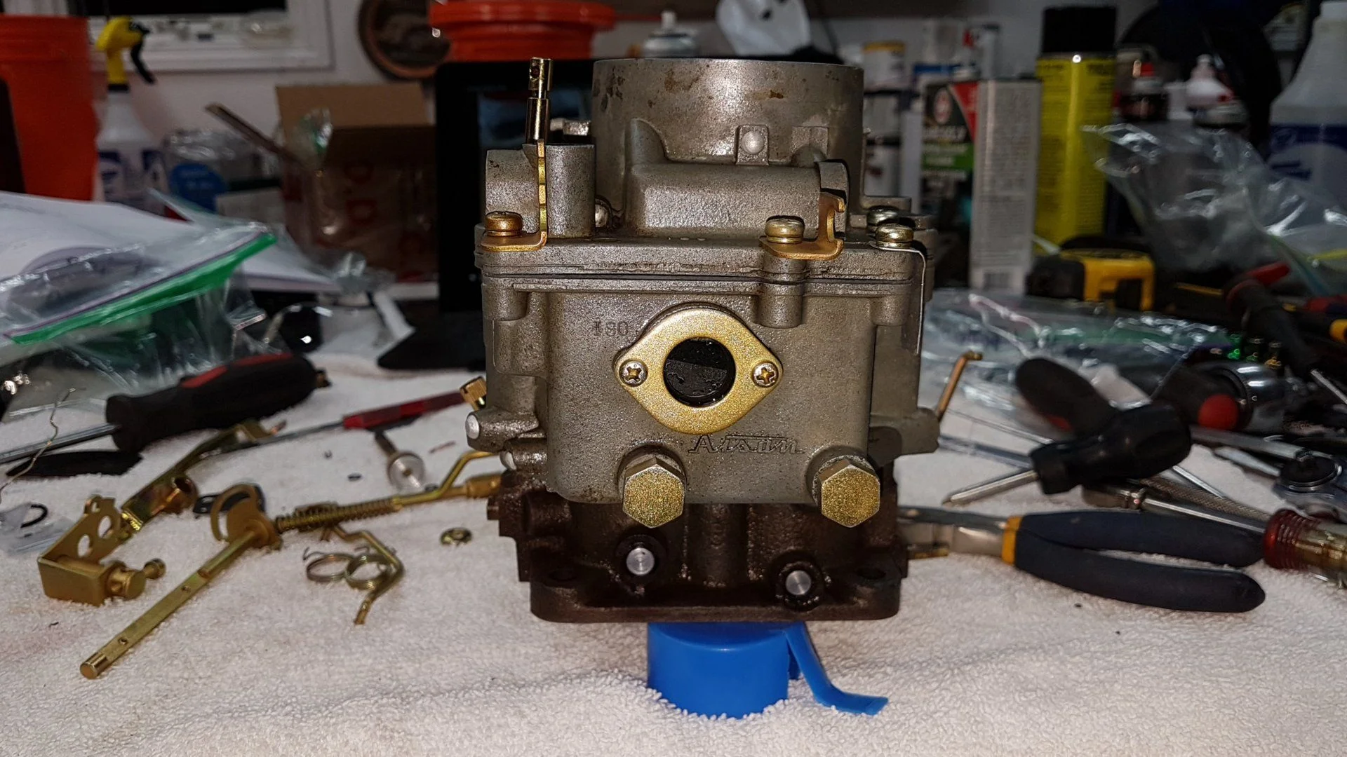

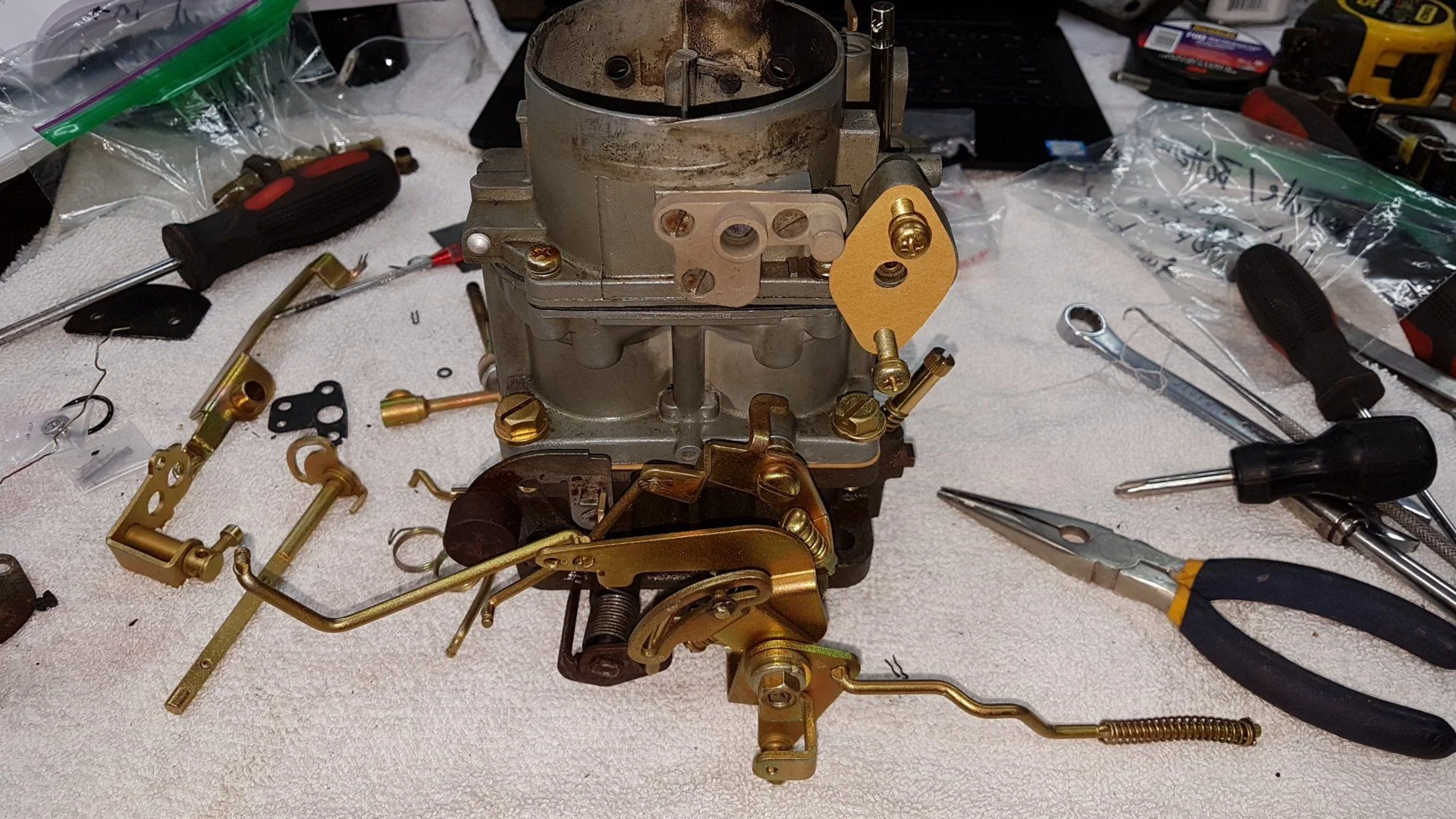

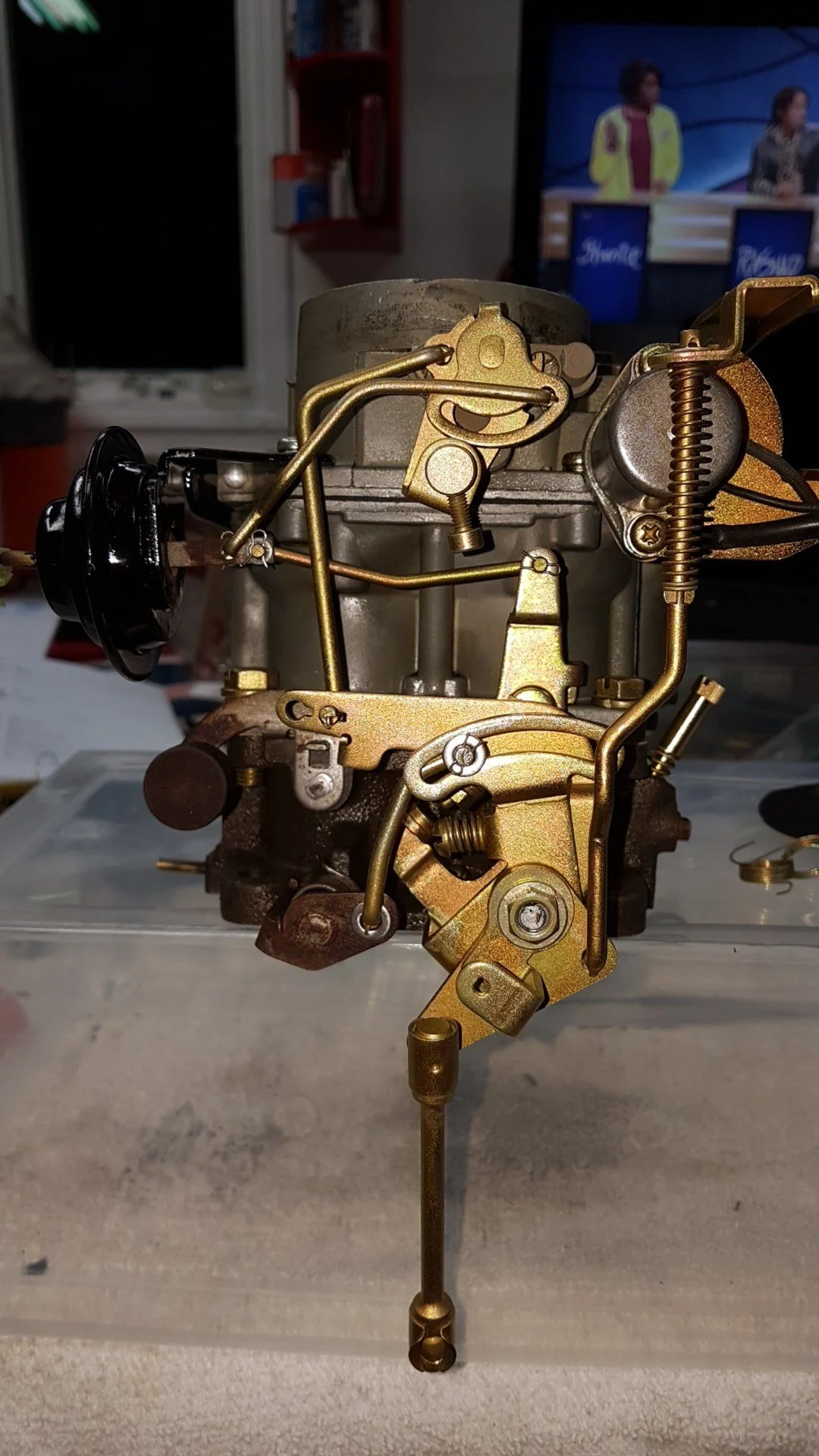

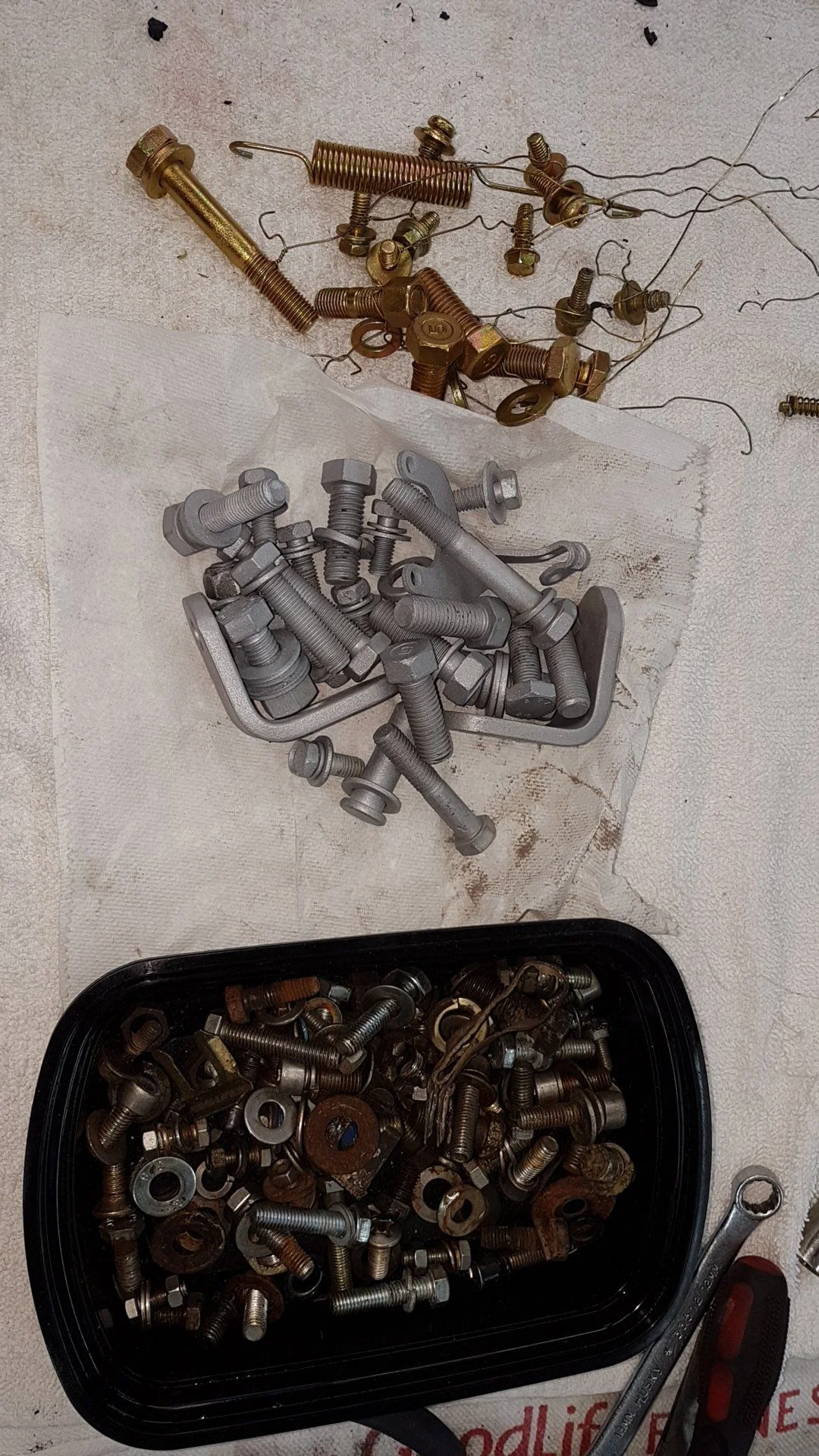

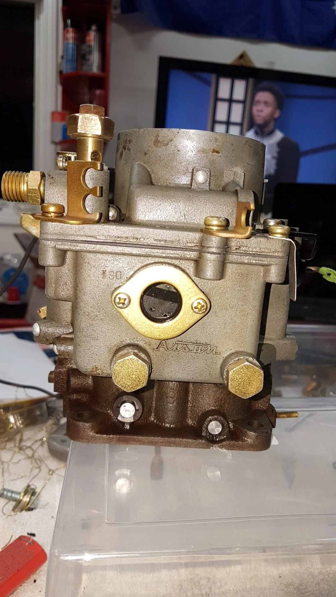

Are you using a CW plating kit? I’d love to be able to do it at home.
Hi, thanks. Its a caswell "copy cad" kit with a bit of experimentation with some brightener. Its fun, but I find it takes ~2 hours or so to get a decent "run" going, where the rhythm of juggling degreasing, blasting, cleaning, plating and dryng/finishing are in sync.
Thanks. I’ve read good things about the kits before; I’ve contemplated getting one. The results look really nice.

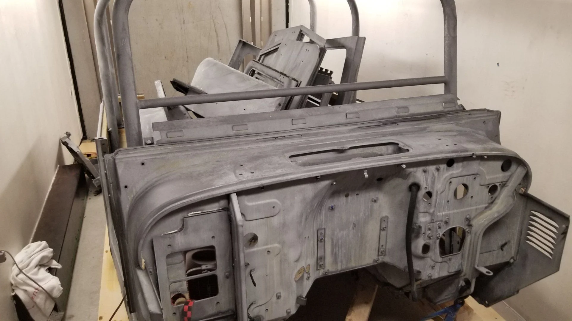

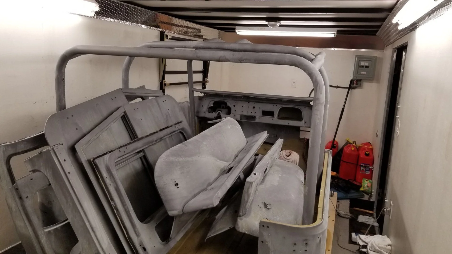

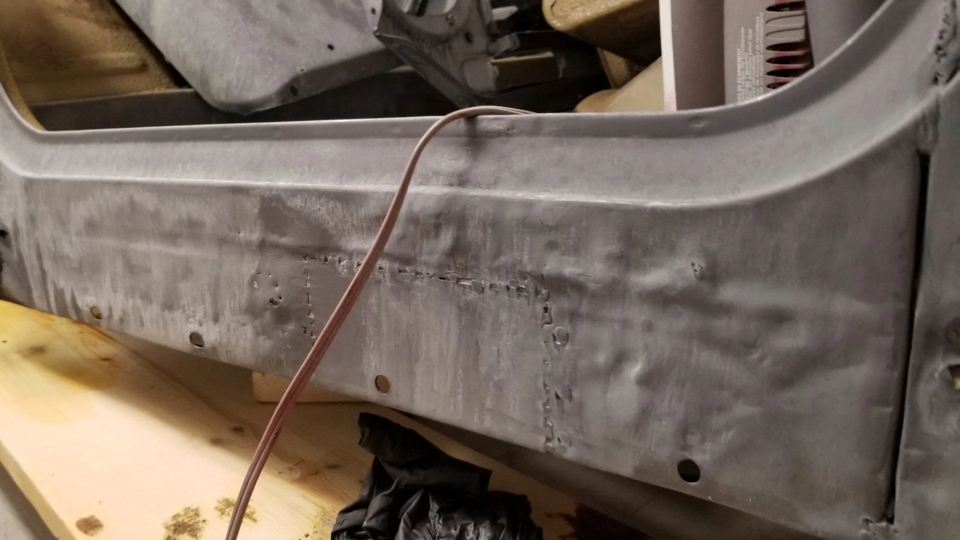

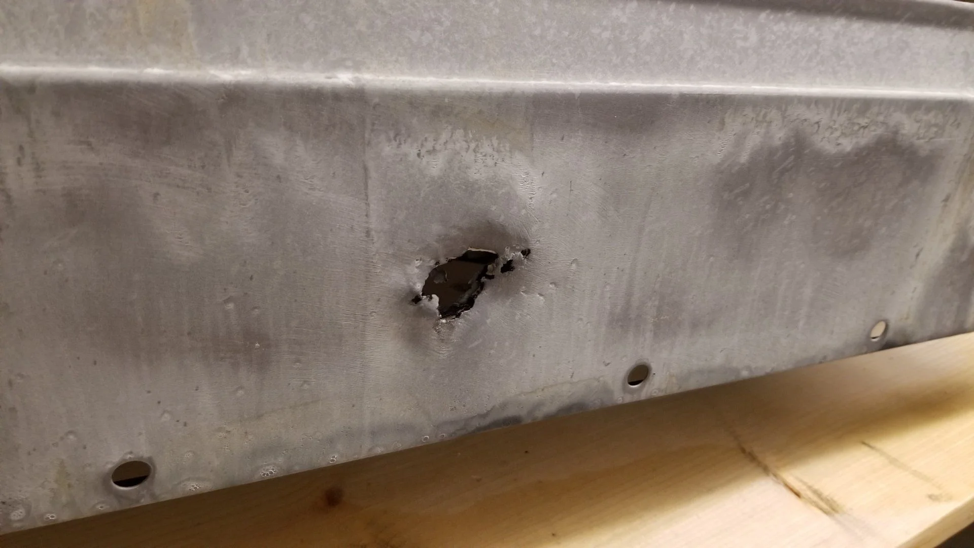

Also finished most of the media basting on the body, top and panels. Phosphate coated them for now while I decide how to deal with the tub and tiny bits of rust on the fenders and 1 rear door...

I am leaning toward replacing the body rearwards of the cowl and dash. There are 7 ugly patches and stitches in it, coated with rhinoliner that wouldnt blast off, and large sections would need new panels. I see the Aqualu tubs which seem interesting except that the transmission tunnel doesnt look stock. My transmission tunnel is blasted and in perfect shame, maybe I would try and reuse that on an aqualu tub? I really want it to appear as stock as possible. Are there other sources for tubs, perferably fresh galvanized or primered steel tubs?
